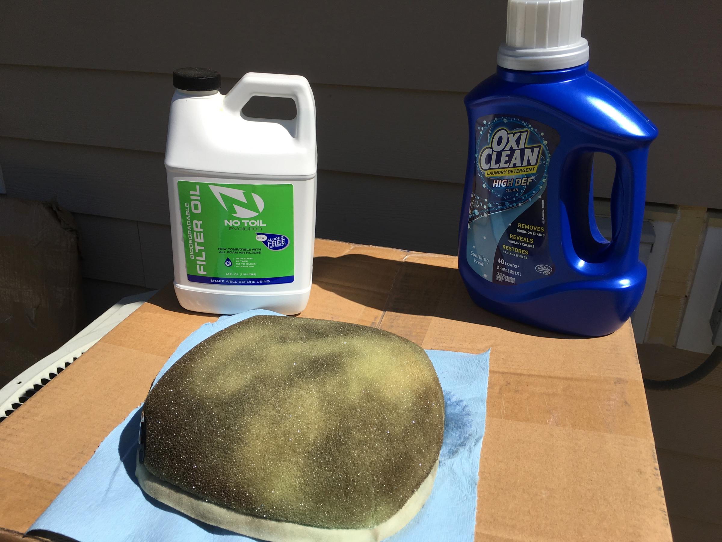

Van 35 Posted July 5, 2019 I made the switch to No Toil and I'm toiling over the cleaning process. I'm using Oxi Clean liquid. I've done two washes with increased concentrations with not much luck. Went to straight Oxi Clean liquid and its starting to cut through the goo (see photo). The amount of liquid I'm using would do laundry for weeks. The cleaner part of the filter, but not really clean, is where the full strength was used. I've read plenty of blogs and the above and am a bit perplexed why the Oxi Clean liquid is not cutting this stuff better. Is dry powder really that much different/better? The wet filter after these cleanings is still very tacky so a wet filter would still work pretty good in my opinion. I'll be trying the powder form next before buying the proprietary no toil cleaner and will report back. Thoughts? Share this post Link to post Share on other sites

paulmbowers 236 Posted July 5, 2019 55 minutes ago, Van said: I made the switch to No Toil and I'm toiling over the cleaning process. I'm using Oxi Clean liquid. I've done two washes with increased concentrations with not much luck. Went to straight Oxi Clean liquid and its starting to cut through the goo (see photo). The amount of liquid I'm using would do laundry for weeks. The cleaner part of the filter, but not really clean, is where the full strength was used. I've read plenty of blogs and the above and am a bit perplexed why the Oxi Clean liquid is not cutting this stuff better. Is dry powder really that much different/better? The wet filter after these cleanings is still very tacky so a wet filter would still work pretty good in my opinion. I'll be trying the powder form next before buying the proprietary no toil cleaner and will report back. Thoughts? Sumpin aint right. You sure you got all the old oil out before using the NoToil? For me, the stuff works AMAZING and no hassle like you're describing. Hot water, OxyClean, squish, squish,squish then rinse. Yes, THAT easy. I use the stain remover powder- maybe the liquid detergent is different stuff? Share this post Link to post Share on other sites
Oracle 206 Posted July 5, 2019 I'm with Uncle Champ on this. Why not just use the No Toil cleaner. It works just as easily as PMB said about the Oxy. Maybe the Oxy is less expensive?? Like Brian mentioned, warm water is key. Share this post Link to post Share on other sites

Van 35 Posted July 8, 2019 On 7/5/2019 at 11:49 AM, paulmbowers said: You sure you got all the old oil out before using the NoToil? PMB. Started with a fresh new No Toil filter. Went shopping today and picked up the proprietary No Toil cleaner. Works just like one would expect it to. Yea! No more toiling and a squeaky clean filter! So, no more liquid. Maybe when I run out, I'll try Amgens white powder. $.08/oz is great vs $.60/oz. Thanks all for the input. Share this post Link to post Share on other sites
