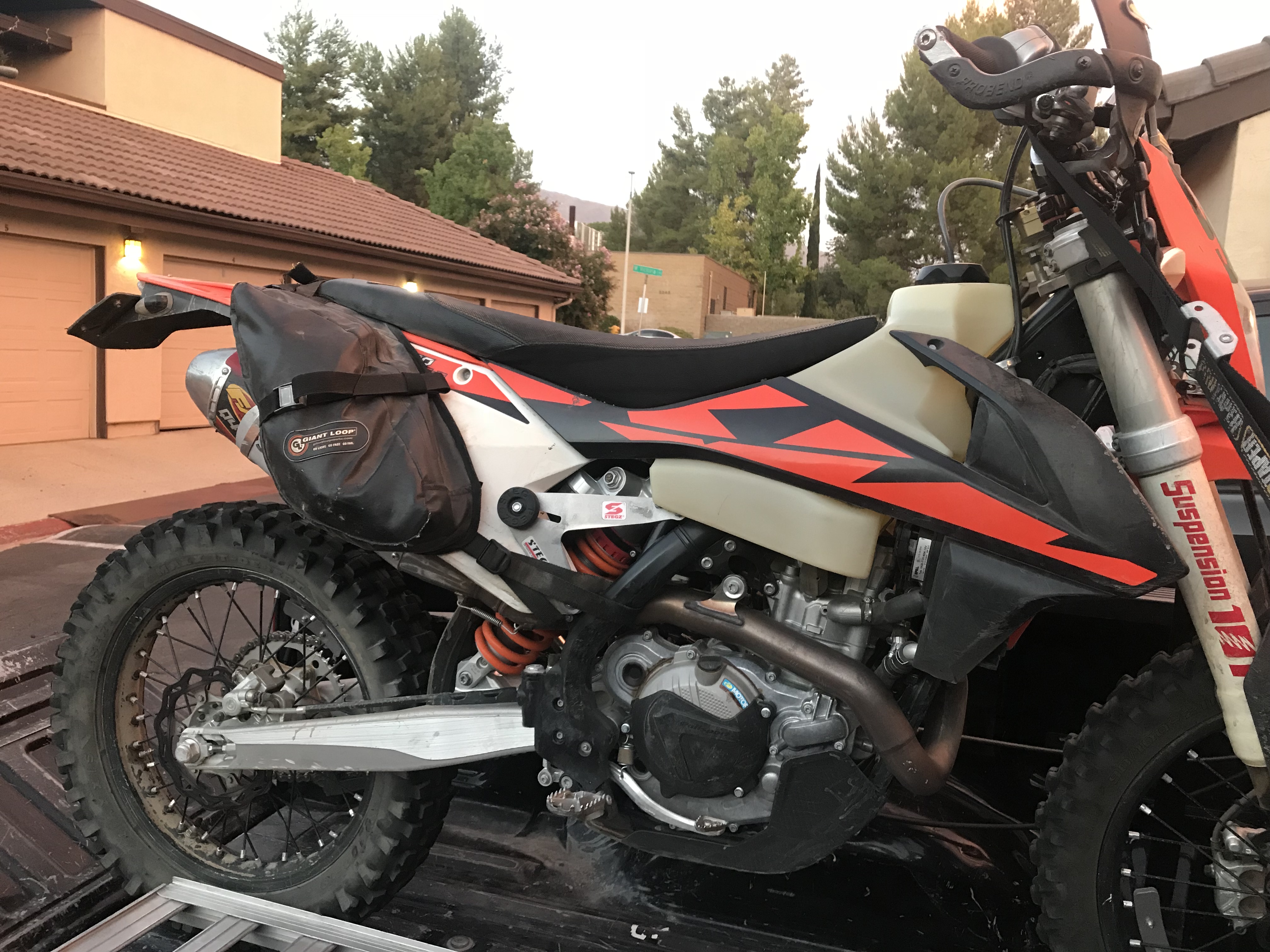

dstss 28 Posted September 1, 2018 I've got the Giant Loop bags like shown on Ken S's pic. Amazing what you can stuff in there. I have a tube, a 12v tire inflator, tool roll, with wrenches, a couple of tire irons and assorted other stuff. Nice not having to remember to pack each time. I just check it a few times each season to see see if i need to add or take anything out. I keep my phone and wallet in the hydropack which is much lighter now without all the other stuff. Had it a couple of years and its held up really well. Work on your bike, take a tire off, tighten everything and see if you have the tools needed to do it in the pack. What ever you don't have is what you will inevitably need. Share this post Link to post Share on other sites

Ken S 165 Posted September 1, 2018 8 hours ago, Ptkatoomer said: Ken, any trouble with that bag melting on the exhaust? What's that thing called? The bags came with a heat shield. No problem. Share this post Link to post Share on other sites

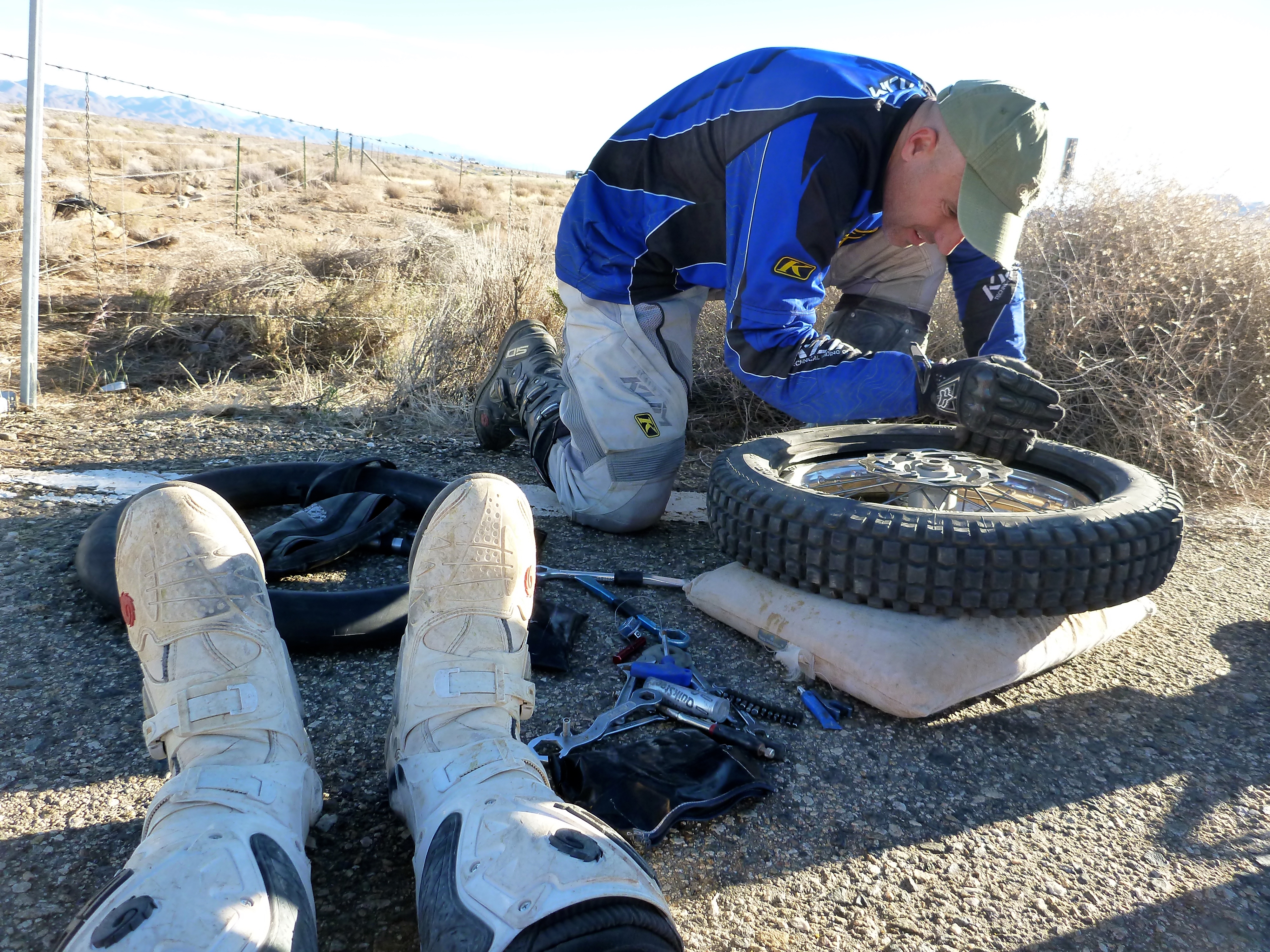

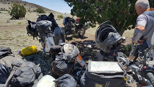

Oracle 207 Posted September 1, 2018 10 hours ago, Covered in Dust said: I will offer unsolicited advice and heckle as needed. CiD Hey, every group needs a good trail supervisor... CID supervising a tube change somewhere along the Mogollon Rim in Arizona CID supervising a tube change somewhere along the south rim of the Grand Canyon... Share this post Link to post Share on other sites
Bagstr 295 Posted September 1, 2018 https://www.giantloopmoto.com/product/mojavi-saddlebag/ In my opinion, you don't need the heat shield. At least not on a KTM. Mount the bag over the seat a couple of inches. Also check out a Tail Rack. https://www.ebay.com/str/nomadiccycleracks Share this post Link to post Share on other sites

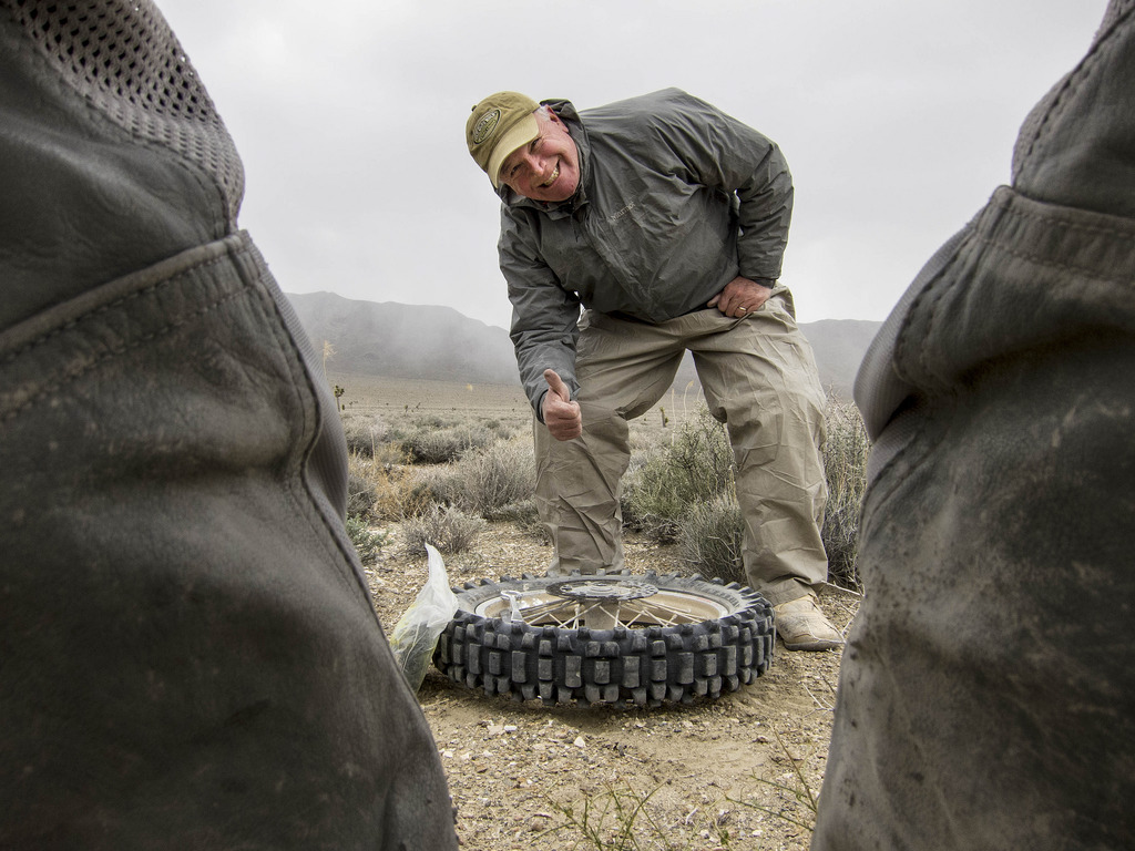

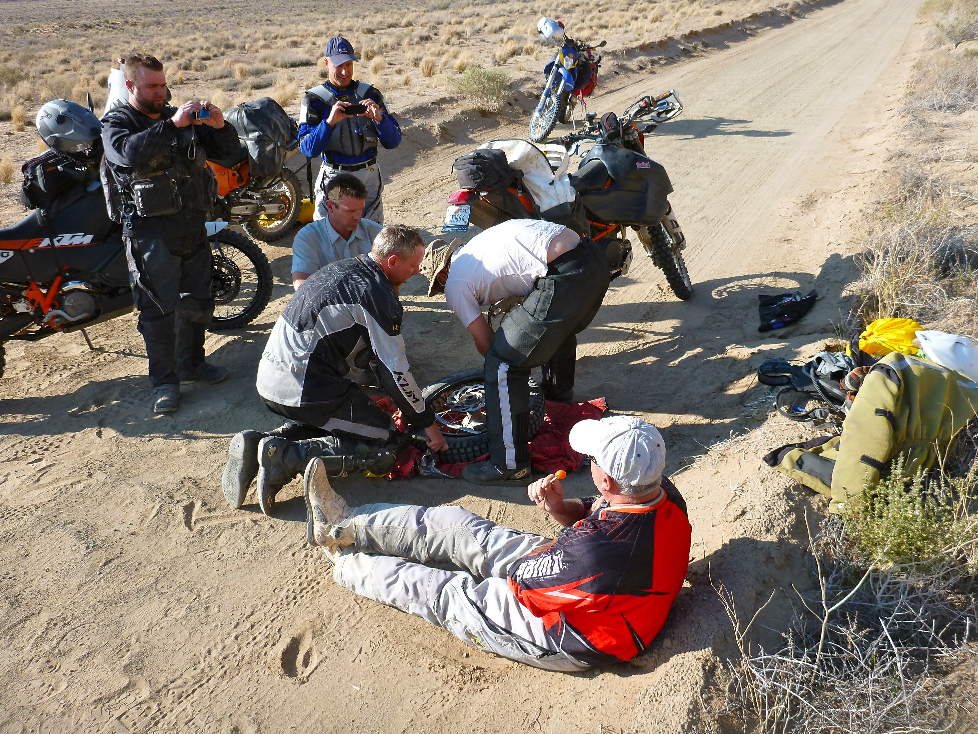

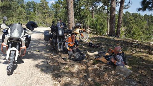

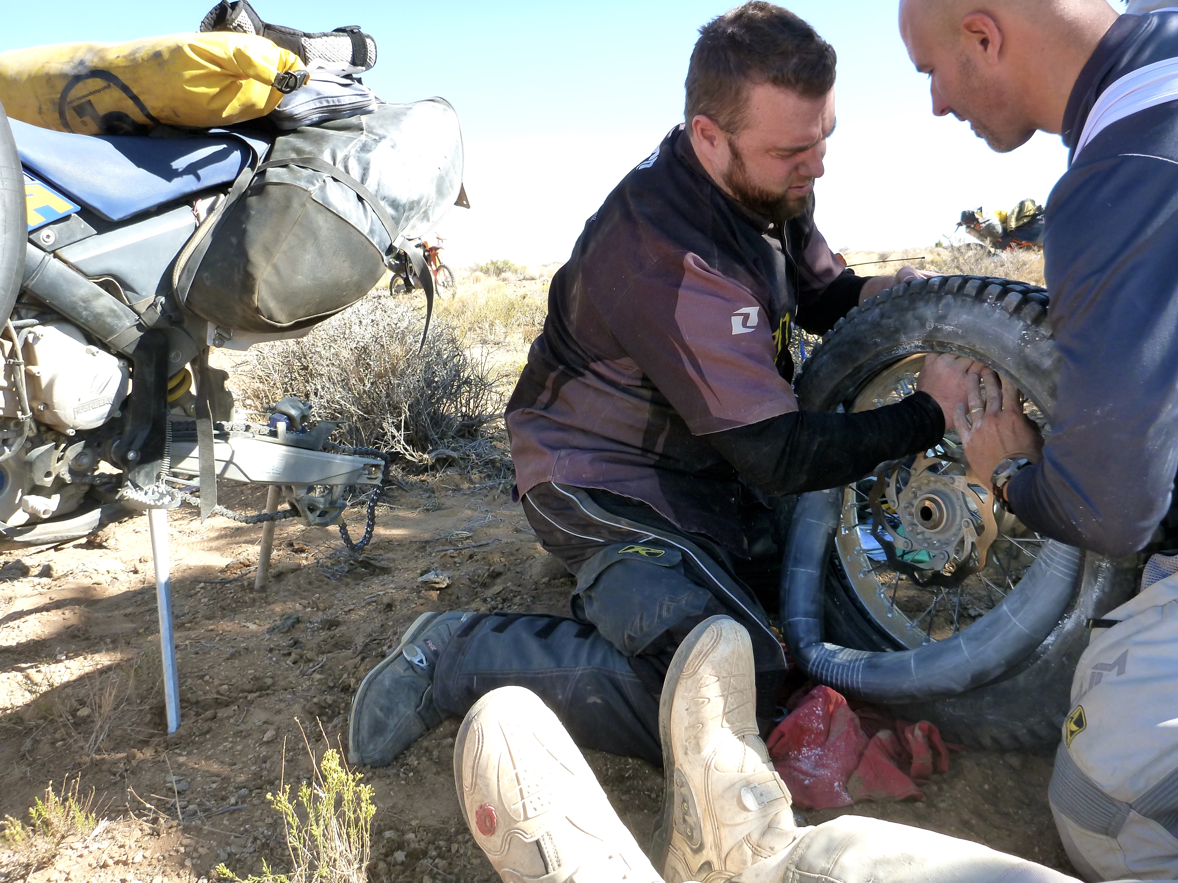

Covered in Dust 165 Posted September 1, 2018 33 minutes ago, Oracle said: Hey, every group needs a good trail supervisor... CID supervising a tube change somewhere along the Mogollon Rim in Arizona CID supervising a tube change somewhere along the south rim of the Grand Canyon... Helping MR Bowers in Death Valley. Helping Vapor somewhere in AZ Helping Strega and Vapor in Utah Myself and Vapor and Strega helping in Utah Share this post Link to post Share on other sites

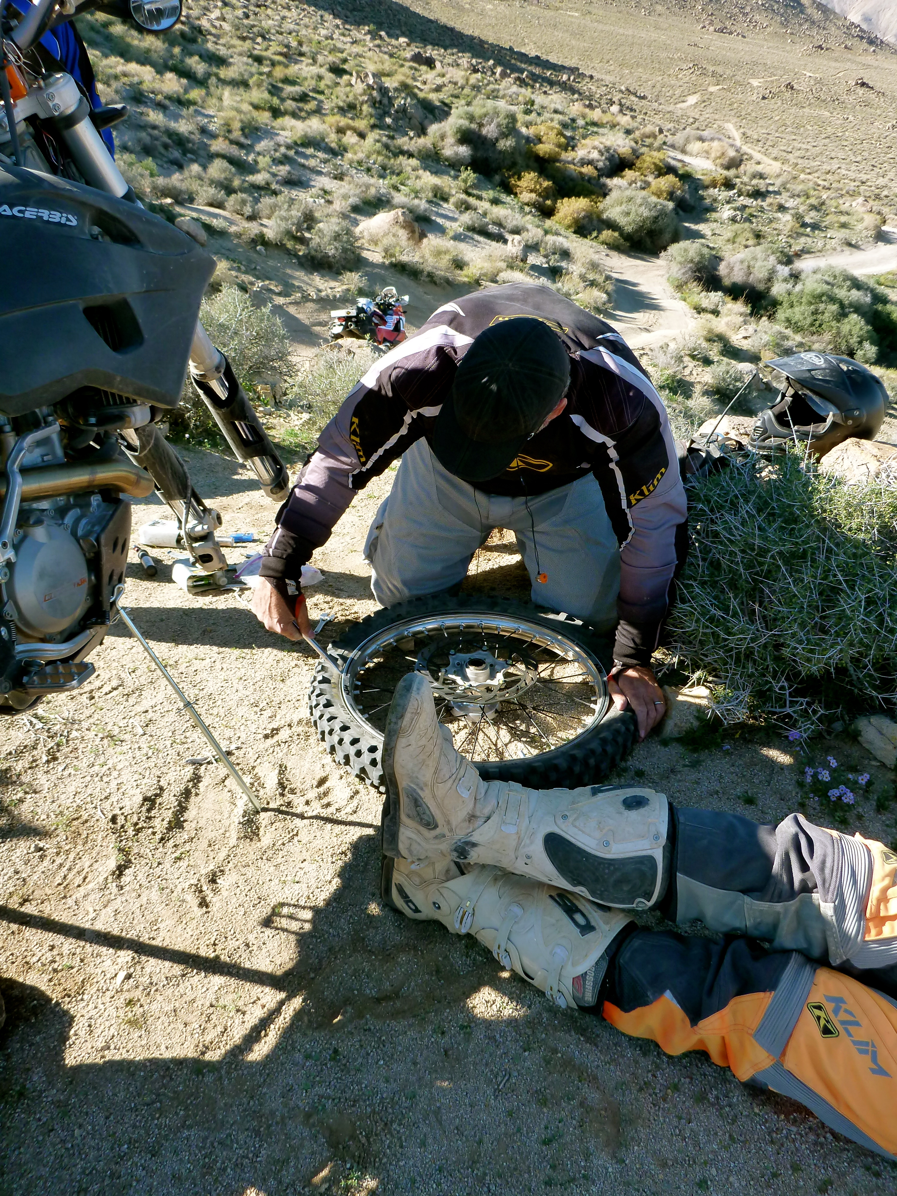

Covered in Dust 165 Posted September 1, 2018 I do change my own tires. This one was fun in 30 degree cold in Death Valley. PMB supervising. Share this post Link to post Share on other sites
paulmbowers 236 Posted September 1, 2018 1 hour ago, Covered in Dust said: I do change my own tires. This one was fun in 30 degree cold in Death Valley. PMB supervising. I was offering unsolicited advice and heckling as needed. Share this post Link to post Share on other sites
