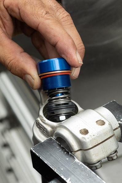

Suspenders 43 Posted September 18, 2020 First note Suspension101 is now a two person team. My son Enzo has joined me and is doing a great job. I am blessed indeed. We have been working on a fork base valve for several years now. Kepple, Nantista, Fred Goldberg, Andy Nichols, Ricky Johnson and more have been our testers. Some of the guys here have one of these builds in an earlier form or another. Oh ya, Kenny had a really early prototype on his 300. Well, 5 years, it is time. We plan to roll out the new product called the "GOBBLERS" in a couple months. The reason for the name is a couple of the test riders came in and said they just gobble up the bumps. The Gobblers leap frog suspension performance, have "massive" adjustability, and ease of installation, in one tidy DIY package. Looking for a few people that want to try them out for a week or two, no charge. Just bring your Xplor forks in and we can install them in about 15 minutes. We do not even have to drain the oil. Go ride them and in return post your impression of the product. We can uninstall them in the same amount of time. If you want to keep them you will be really well taken care of like 25%. This is not about selling product so much as it is about getting public perception of the product. This is for stock or re-valved Xplor forks by the way, it works on them all. Thanks again, George & Enzo 2 Share this post Link to post Share on other sites

Bagstr 295 Posted September 23, 2020 Having difficulty visualizing how this part attaches to the Explor fork. Best guess is at bottom of the polished leg in the aluminum casting that holds the compression adjuster on a PDS system. Having looked at the parts explosion does not help much. The parts diagram seems to show two springs and two valve stacks. I thought the Explor system had only one of each. 🤷♂️ Thanks for any Light on the subject. P.S. Correct me please, I am thinking there are two valve stacks. Rebound in the top and Compression at the bottom. This Blue part is the compression function, correct? Share this post Link to post Share on other sites

paulmbowers 236 Posted September 24, 2020 1 hour ago, Bagstr said: Having difficulty visualizing how this part attaches to the Explor fork. 🤷♂️ I suspect you’ll have installation instructions, complete with images, in a week or so 😉 Share this post Link to post Share on other sites
Suspenders 43 Posted September 24, 2020 1 hour ago, Bagstr said: Having difficulty visualizing how this part attaches to the Explor fork. Best guess is at bottom of the polished leg in the aluminum casting that holds the compression adjuster on a PDS system. Having looked at the parts explosion does not help much. The parts diagram seems to show two springs and two valve stacks. I thought the Explor system had only one of each. 🤷♂️ Thanks for any Light on the subject. P.S. Correct me please, I am thinking there are two valve stacks. Rebound in the top and Compression at the bottom. This Blue part is the compression function, correct? Bottom of fork is correct. One check valve on top "return" for oil to get back in. Stack at the spring is compression. Hole at tip of stem bleeds past piston and out side hole shown. What it comes down to is this is the only fork adjuster that has two compression adjustments. One is high speed and one is low speed. Yes just like a shock. Change the high speed on a shock and it makes a major change by putting pressure / pre-load on a spring which in turn is putting pressure on the shim stack that covers the piston orifices that restricts or holds the fluid back. The low speed adjuster simply opens an orifice or valve that allows more or less fluid to flow past the high speed adjuster spring, shims, piston etc. That is until this low speed bleed orifice is unable to handle the amount of flow and is overwhelmed and then it is all about the high speed circuit taking control. Not to worry Kenny this allows us to "nail" the set up so much easier. Your 500 was not as good as your 300 and that is highly unlikely to happen again due to the external adjuster. This unit improves every bike we have installed it on but still testing. Other companies re-valves included. It improves stock forks as well. But when I install the sprung mid and this unit it gets crazy good. By the way the Genius guy is an artist. Real deal. Those pictures are great. Thank you! 1 Share this post Link to post Share on other sites

paulmbowers 236 Posted September 25, 2020 On 9/23/2020 at 4:08 PM, Bagstr said: Having difficulty visualizing how this part attaches to the Explor fork. Share this post Link to post Share on other sites
Suspenders 43 Posted September 25, 2020 3 hours ago, DSM8 said: would this be applicable to the 1290 SAR? Might help to know what bike models those forks come on. I have no clue. They fit from about 2004 to today open chamber forks for the off road bikes and older adventure bikes like the 990s. The Adventure bikes starting with the 1090-1190-1290-790 they changed the lugs and the adjusters do not fit. I have to build the 1290R suspension by hand and it works well with some pretty aggressive riders. We also for those that want it all do a 990 cartridge conversion that is quite good as I am able to build a sprung base like the Gobbler but have to do it internally so no external adjusting. It works pretty well though. Share this post Link to post Share on other sites

Suspenders 43 Posted September 28, 2020 The Xplor forks are using the same upper aluminum tube and lower chrome tube since I believe 2007. Before 2007 differences but interchangeable. The open chamber forks of past had mid valves in both forks and never reached their potential. Make it adequate for the masses and sell. Tuners did not have anything either, until the sprung mid valve big improvement and now we have the Gobblers taking them to another level yet. How to change an open chamber fork into an Xplor fork. 1. Omit base valve adjusters at bottom of fork. Trouble is the only known way to get true compression adjustment in this fork is with a base valve adjuster on the Bottom of the fork. 2. Omit the mid valve on the left fork and install an orifice valve. More likened to a damper rod fork of old. Soft on top with a highly progressive damping spike 3. Drill holes in the left cartridge body to allow free flow of fluid into and out of the cartridge. Negating the possibility of a mid valve / rebound circuit. Maybe they will feel some comp adjustment range this way. Not! The rebound damping has been moved to a single piston on the right fork. So your reb adjuster has 1/2 the effect and more cavitation as only one piston. Your comp adjuster is a placebo adjuster that has little affect at all. The gobbler puts the base valves back in play with way more adjustment than before so it is a solid improvement for trail riding in addition to bringing in more plushness due to the design. But if you are going to go race pace high speed in Baja or Dist 38 racing then the missing parts noted above should be replaced and the holes plugged in the cartridge. This because when you have a very high speed compression event the pop off valve allows the fork to blow through the stroke and then the holes in the orifice valve become overwhelmed with too much fluid flow and hydraulic lock occurs. Exactly like the bikes of old that were too progressive. That is why they changed to the more expensive mid valve system years ago because they had too much progression. When we tune an open chamber or Xplor fork that has been brought back to open chamber specs combined with the Gobblers. I am getting texts like yesterday. I just put three hours on the bike and WHOOO Haaaa. Oh Yeah, Its amazing, the plushness and lightness even when using most of the travel! This is by far the best fork I have ever built. Too bad Noah got picked up by Husky as he helped develop this system and now he can't used it. On another note I think Husky all the way up to the top, Roger is going to realize what they have in Noah, not as a rider, we all know his riding abilities. But as a tuner. Thank you for all your help Noah, we had a good run! Miss ya. 1 Share this post Link to post Share on other sites
