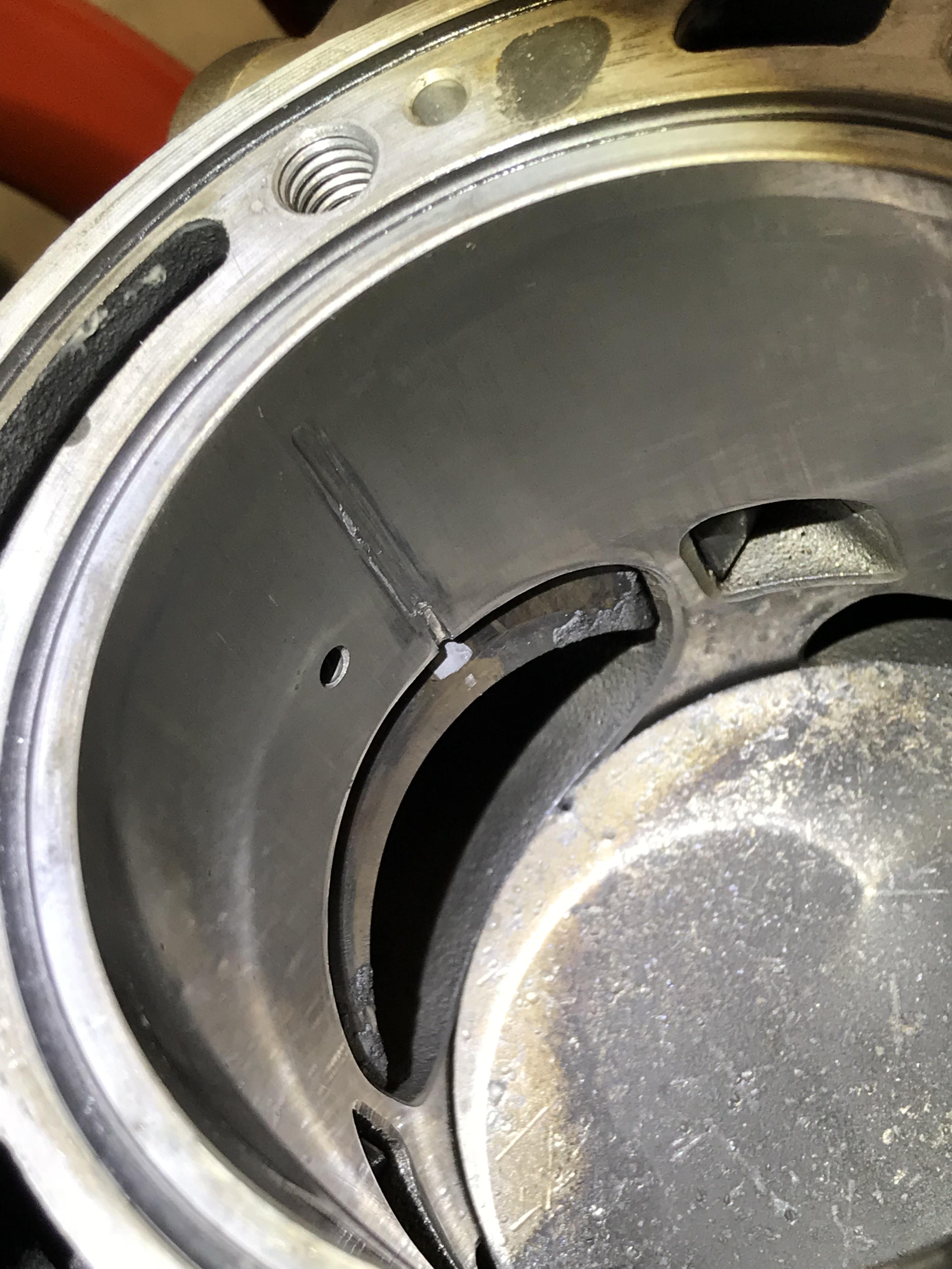

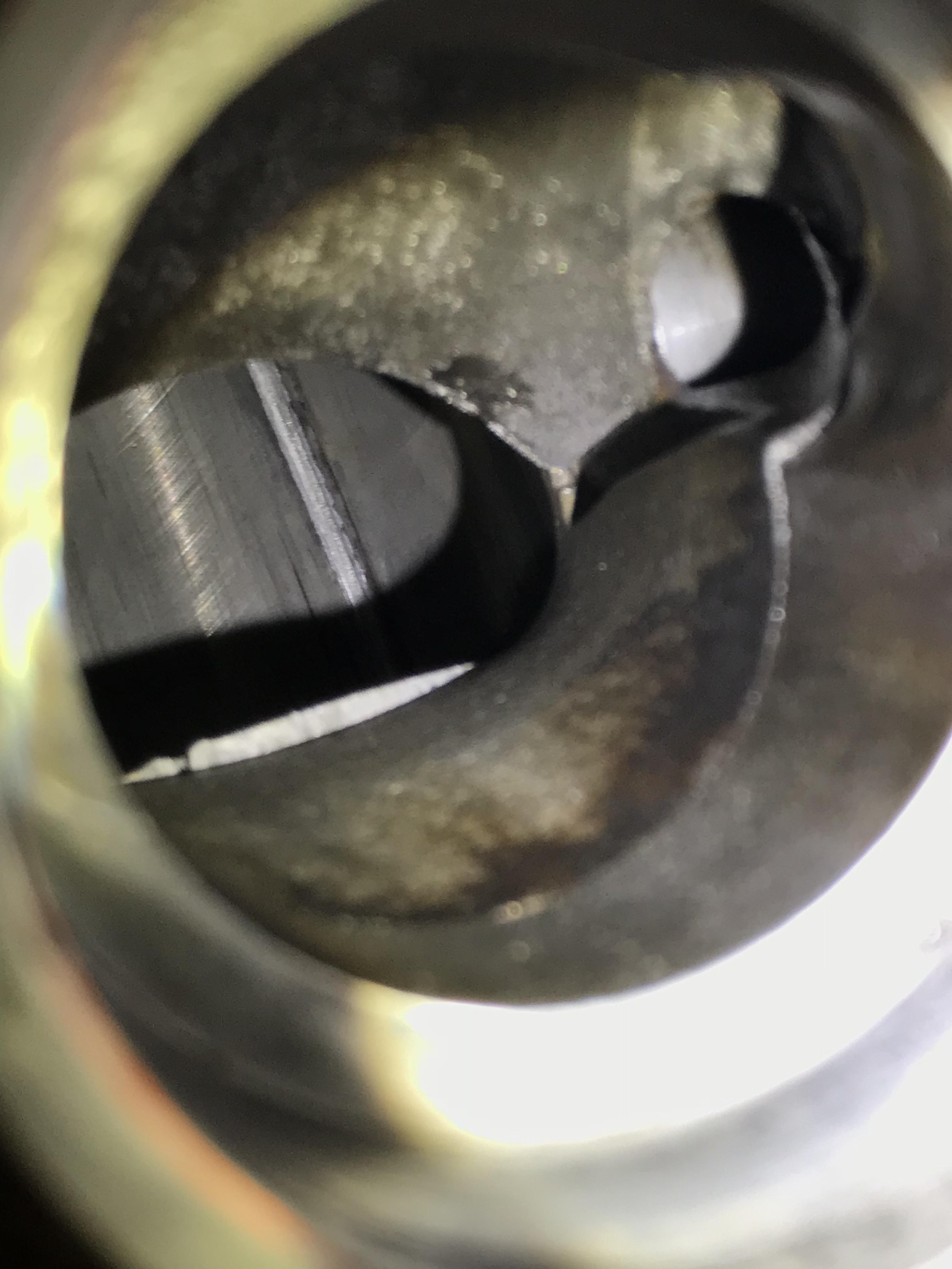

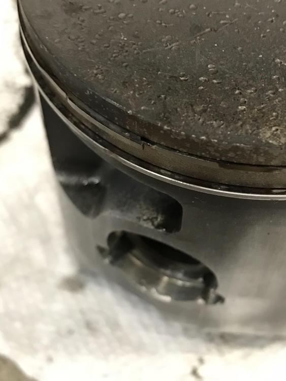

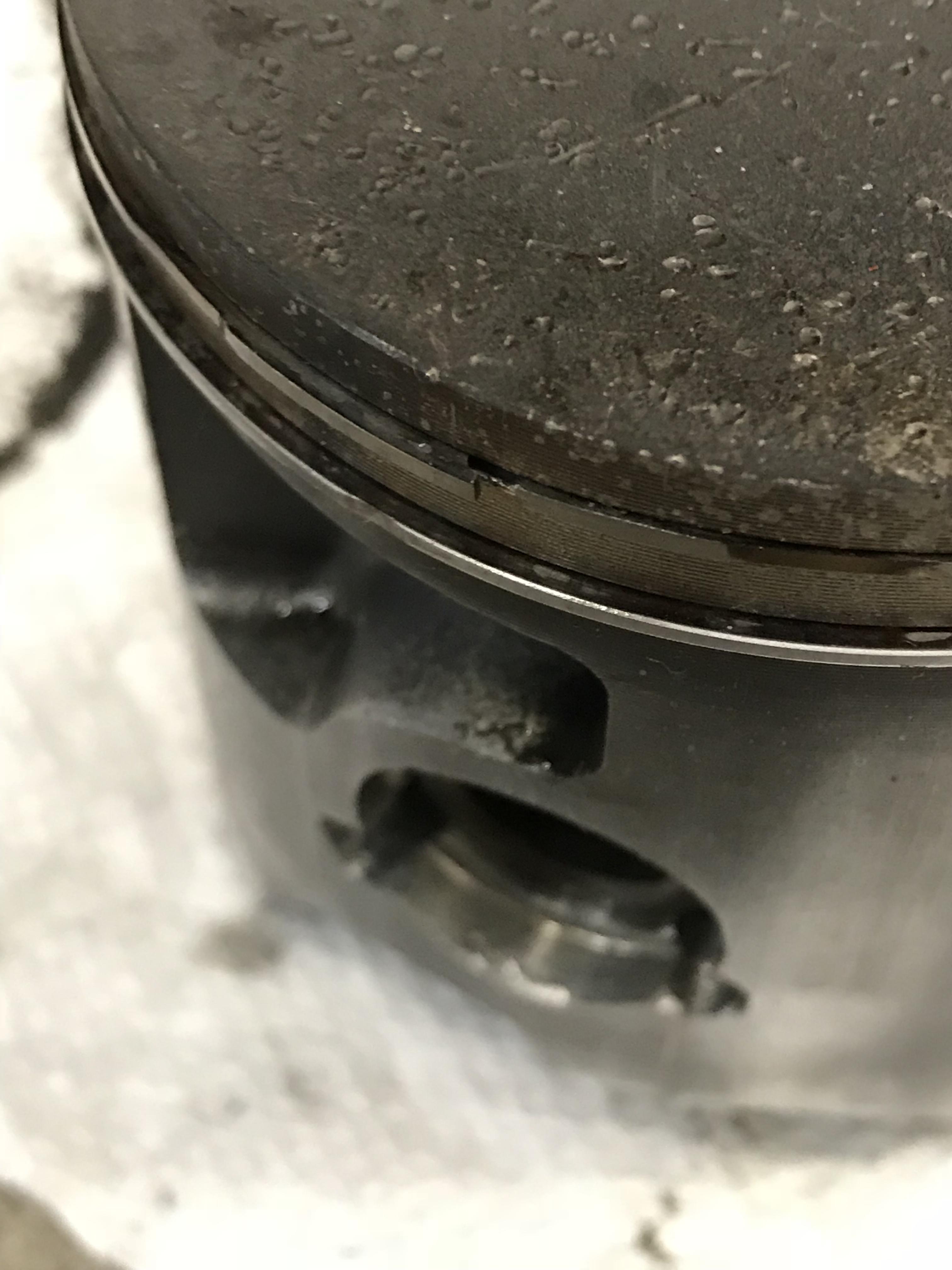

TexasDualler 32 Posted April 10, 2018 My ‘15 KTM 300xcw absolutely refuses to start anymore, unless someone tows it to the top of a big hill and it gets going about 20mph and you bump start it then keep it pinned otherwise it’ll sputter out and die. After checking everything else (spark, carb clean, fuel getting to carb, reed valves) decided to inspect the power valve thinking maybe it was stuck open. Checked it out and it moves freely. So since I had the pipe off I did a little inspection of the cylinder and to my dismay found some pretty heavy scoring. So if I’m not mistaken this is the cause of the failure to start and without a doubt not a good thing in general. Now my question is does anyone have any advice on where to get the cylinder machined? If it’s even possible to correct it. Then assuming it’s not too far gone and I get it machined, where’s the best place to get a top end kit? Thanks in advance for any input. Share this post Link to post Share on other sites
Bp619 114 Posted April 10, 2018 Try messaging spaugh on here see if he's still doing work on bikes if you don't wanna do yourself, he's awesome with 2 stroke For parts check with these guys ://www.cookseycrank.com Share this post Link to post Share on other sites
tntmo 971 Posted April 10, 2018 Your cylinder is Nikasil coated, it can't be bored out. You'll need to replace it or get it re-coated. I have used a few places, Millennium Technologies is one that has worked out well for me. Share this post Link to post Share on other sites
Ptkatoomer 118 Posted April 10, 2018 I've heard those nikasil cylinders are pretty tough. Looks like you stuck a ring and that's why its so hard to start. Might be able to just acid wash the cylinder? Not sure who could do that. Share this post Link to post Share on other sites
amgems 79 Posted April 10, 2018 That looks pretty bad. Very likely that scoring is thru the Nikasil plating. Either of Thes guys can fix you up with either new, exchange, or replated cylinder, piston, and rings. http://www.powersealusa.com/ or Millennium Technologies http://www.mt-llc.com/ There are only a few places that do Nikasil plating. Some will say they do it, but really they just send it to these guys. Share this post Link to post Share on other sites

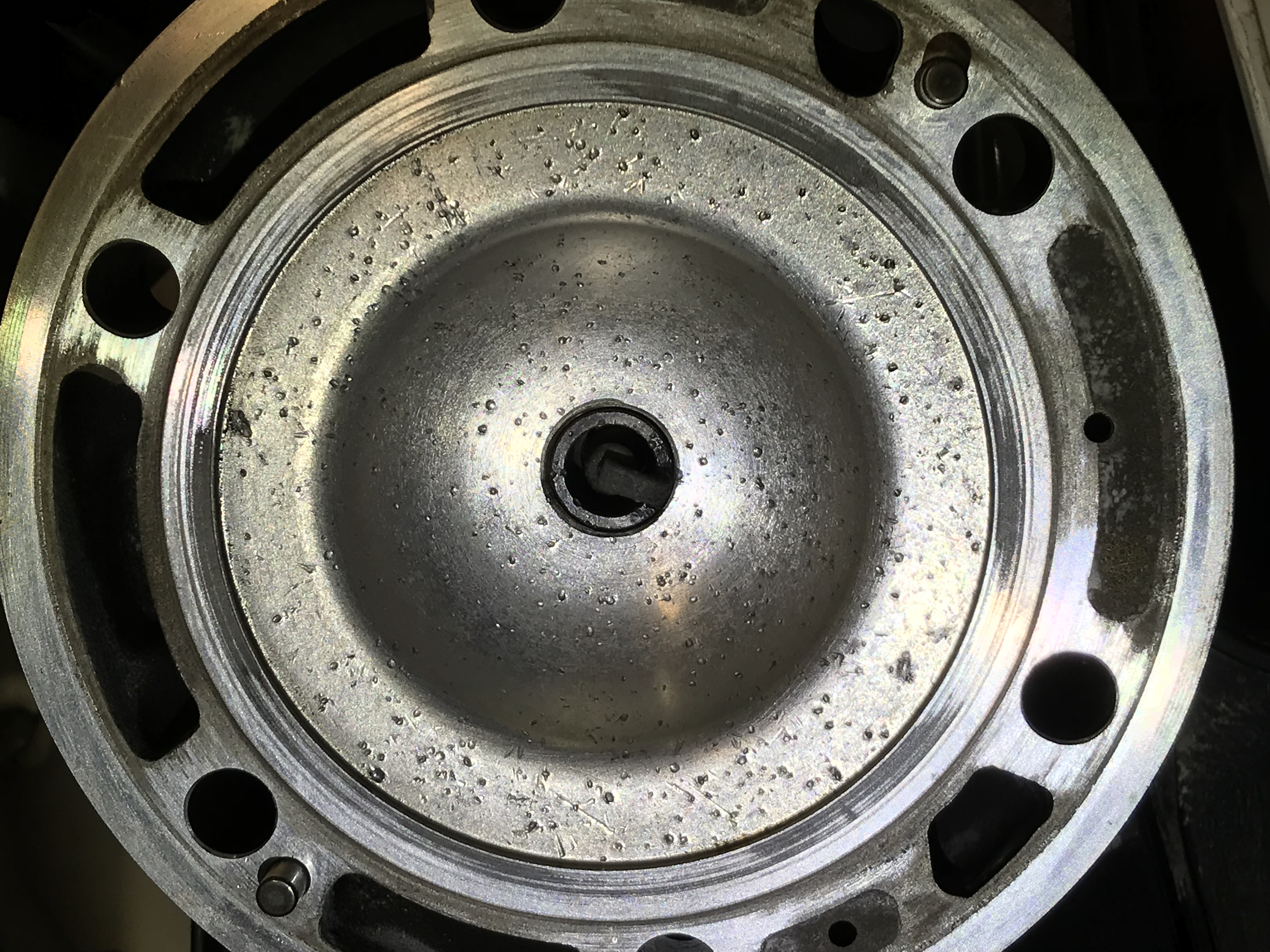

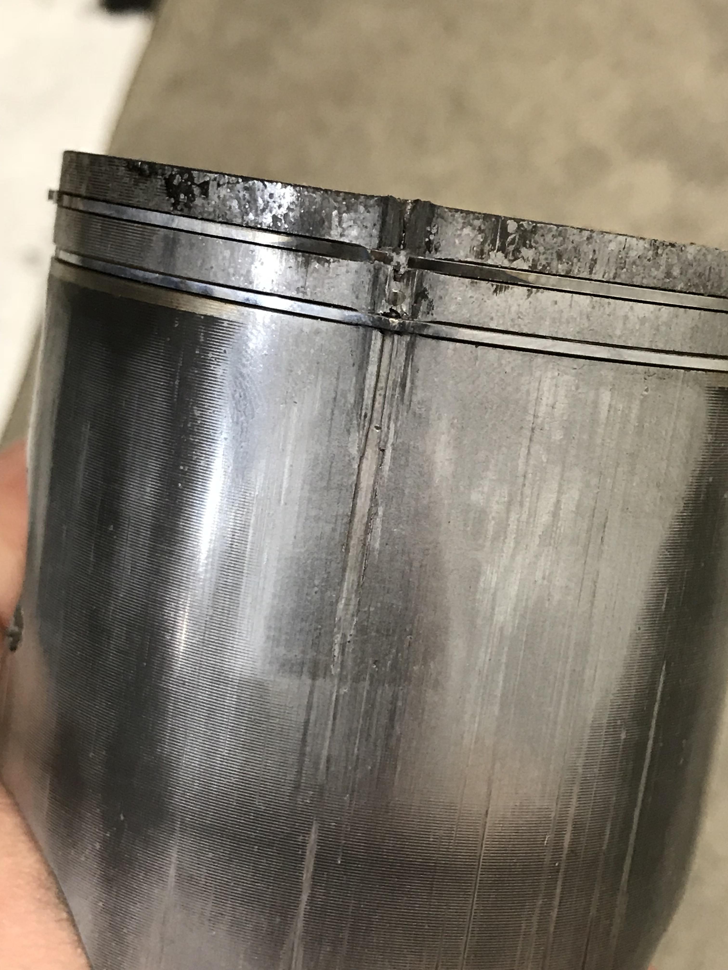

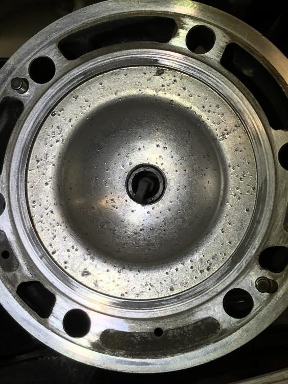

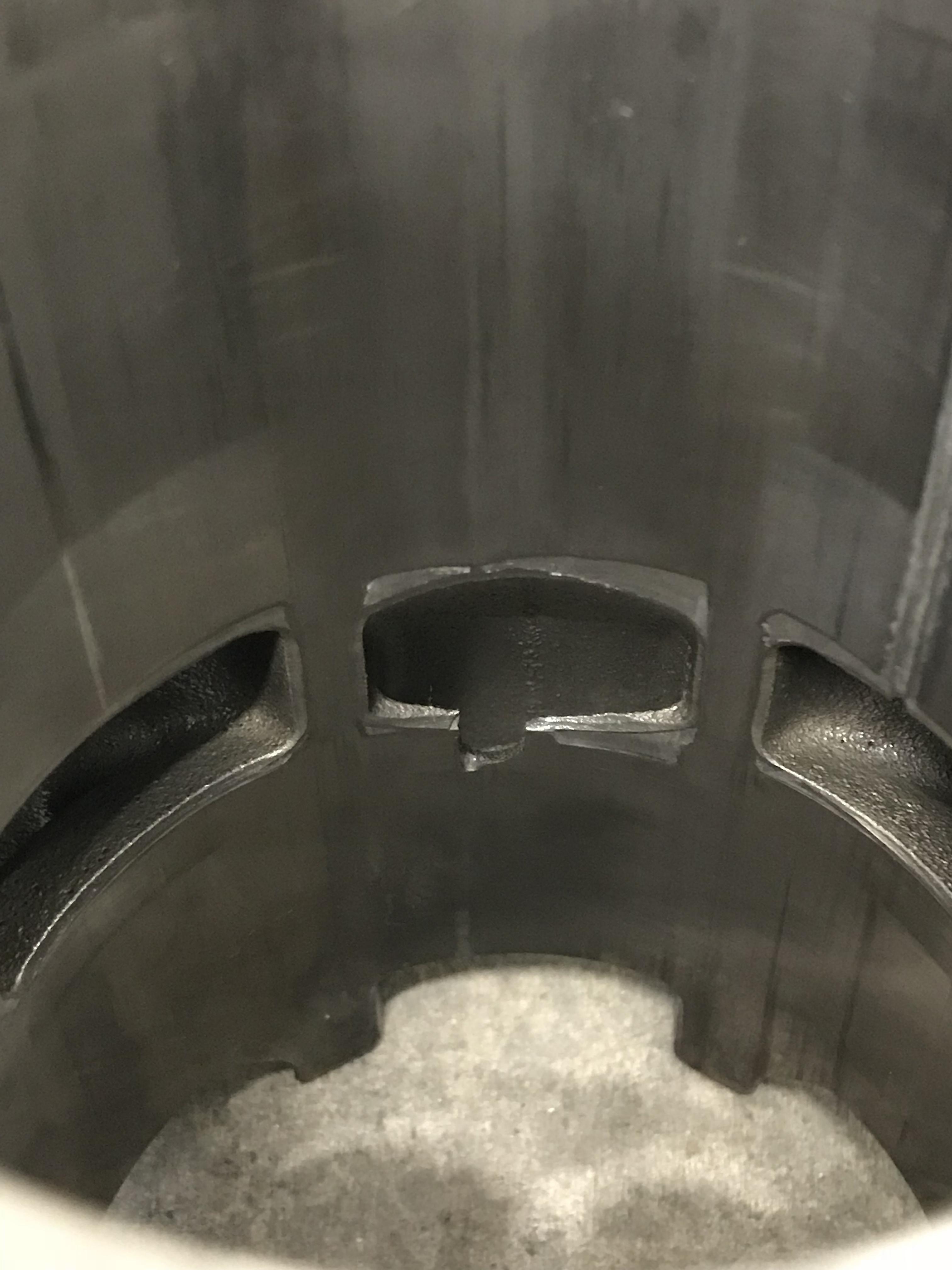

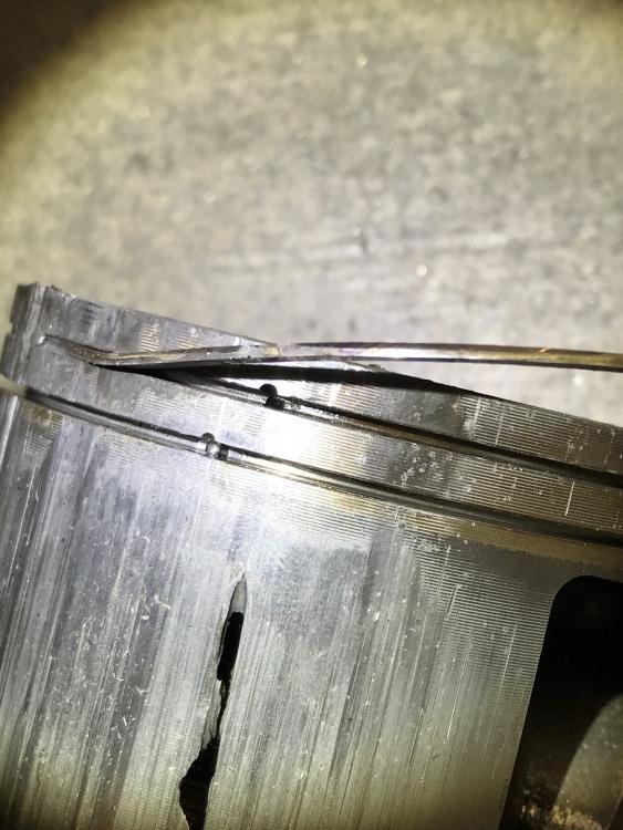

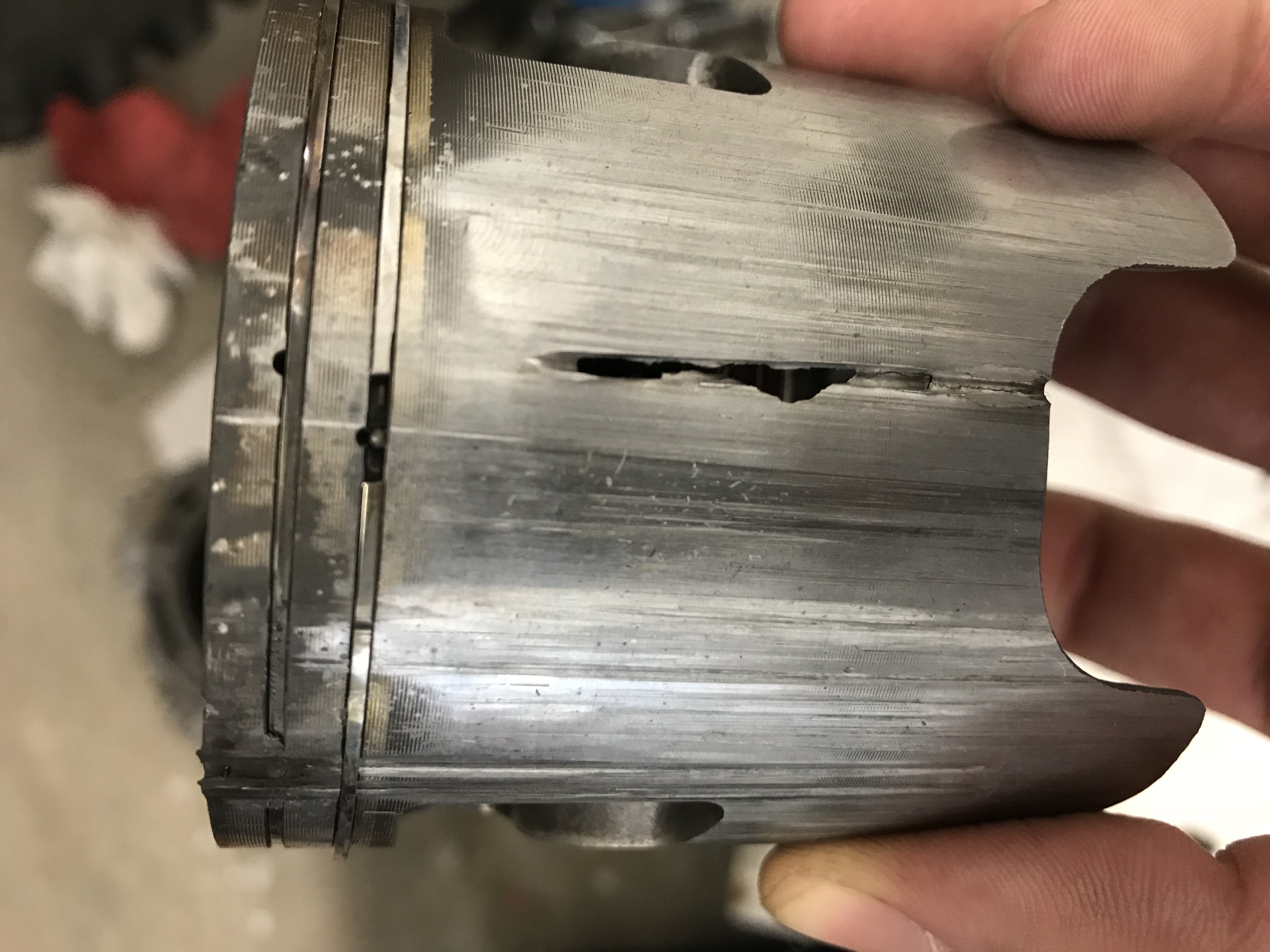

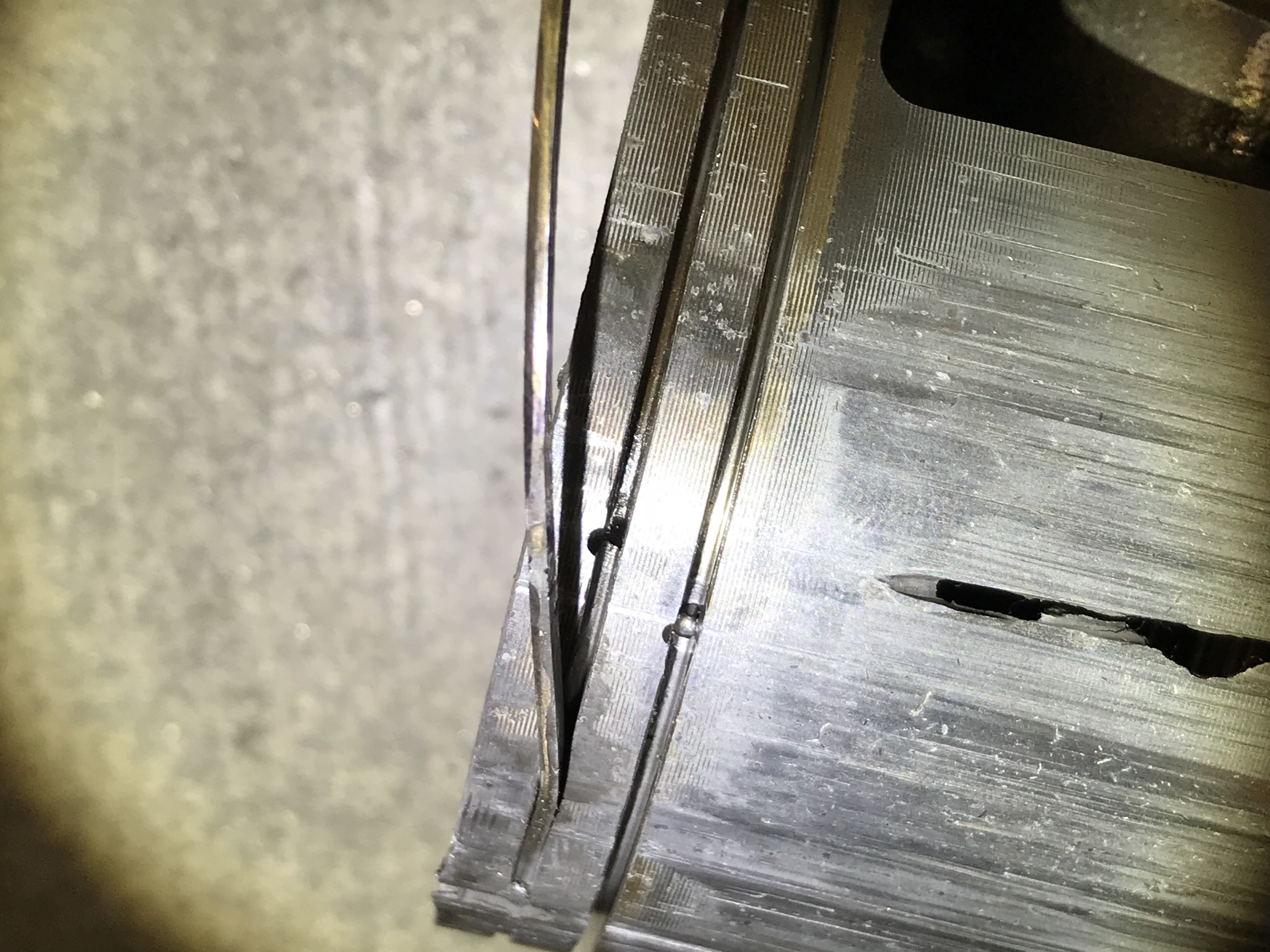

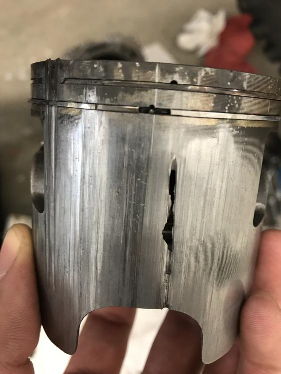

TexasDualler 32 Posted April 11, 2018 Cylinder is possibly beyond repair. Heavily scored and a sizable chip in one of the transfer ports. See for yourself: One of the piston rings is broke but it’s hard to say what started the terrible chain of events. Clearly some piece of metal made its way to the combustion chamber and was banging around in there for awhile. Aside from potentially needing a new cylinder if the original is beyond repair, my consern is there a bunch of shrapnel rattling around in the case. I couldn’t see any signs of damage to the crank or rod and everything is still tight and smooth but I can’t say for certain nothing is down there. Share this post Link to post Share on other sites
TexasDualler 32 Posted April 11, 2018 Upon further inspection of piston found the top ring wasn’t broken, the retaining pin was missing (fell out, came lose?) causing ring to rotate and resulting damage. Share this post Link to post Share on other sites
tntmo 971 Posted April 11, 2018 I guess that explains why it wouldn't run! Guess it's time to look for a replacement cylinder? Share this post Link to post Share on other sites

Oracle 207 Posted April 11, 2018 Wow... that's pretty bad. I think it's time for a new top end, cylinder and cylinder head. Don't even waste your time trying to repair the cylinder or head... Drop the coin, maybe a big bore kit, and get back to riding. Share this post Link to post Share on other sites

simicrintz 177 Posted April 11, 2018 Just now, TexasDualler said: My best guess is the pin that’s supposed to keep the top ring from rotating came loose somehow and caused all the damage. That was my first thought as well after you mentioned it. Share this post Link to post Share on other sites

isde97 30 Posted April 12, 2018 I have had that happen- the ring locating pin coming loose and doing a bunch of damage. I had the cylinder repaired, probably by Milennium. It was a while ago. At least get a repair evaluation on the cylinder. Knock the high spots off the head and you should be fine there. If you wanted to be a maniac, you could get the head resurfaced, but I'm not sure you would be able to tell the difference. As for the bottom end, split the cases and take a look. There is a good chance there is nothing down there, but it isn't that much more of a job if you are able to pull the top end off, and you need something to do anyway while the cylinder is away. At this point, it isn't worth the risk of damaging another cylinder+piston to avoid the couple of hours it would take to pull it apart and take a look. Share this post Link to post Share on other sites
TexasDualler 32 Posted April 12, 2018 Any suggestions on what kind of solvent to use for flushing bottom end? Preferably something that won’t damage the crank seals. Share this post Link to post Share on other sites
TexasDualler 32 Posted April 12, 2018 11 hours ago, isde97 said: I have had that happen- the ring locating pin coming loose and doing a bunch of damage. I had the cylinder repaired, probably by Milennium. It was a while ago. Spoke with Millennium. About $300 for the repair plus round trip shipping but it’s a gamble if it’s repairable, the chip in the port being the concern. Then I would still need a new head and main power valve (also damaged). So roughly by my estimate somewhere between $700-750 if I go that route. Slavens kit that contains everything I would need and a new CDI for $900. And then I could sell my old CDI on eBay for a steal at $100 (I see several other used CDIs going for $170). Plus maybe sell my old cylinder to Millennium and come out the same or maybe a little ahead if I go this route. Or at the very least only 100ish bucks more for a power gain over the stock set up. Share this post Link to post Share on other sites
