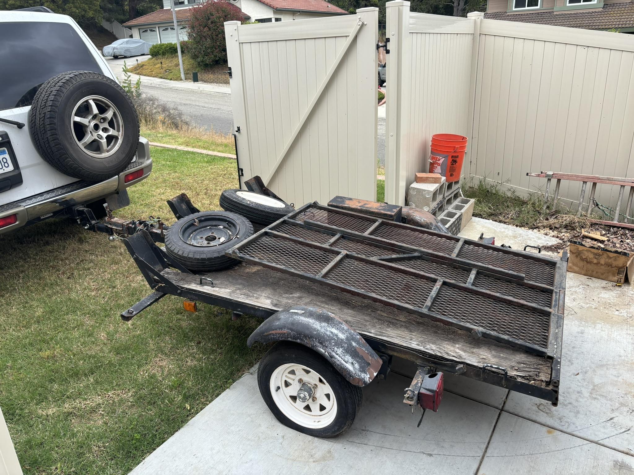

SpaceCowboy 71 Posted June 18, 2024 Thank you @DSM8 for coordinating with your neighbor and meeting with me so I could pick up this moto trailer. Initial to-do list: - 3 new tires - weld cracked frame - Cut off rusted in place ramp - replace deck wood - replace lights/electrical Share this post Link to post Share on other sites

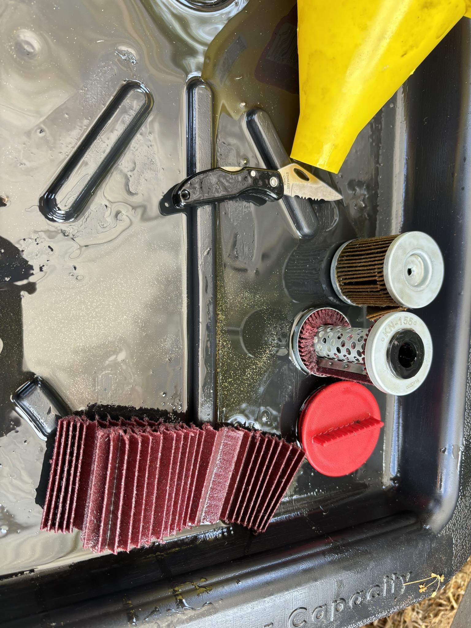

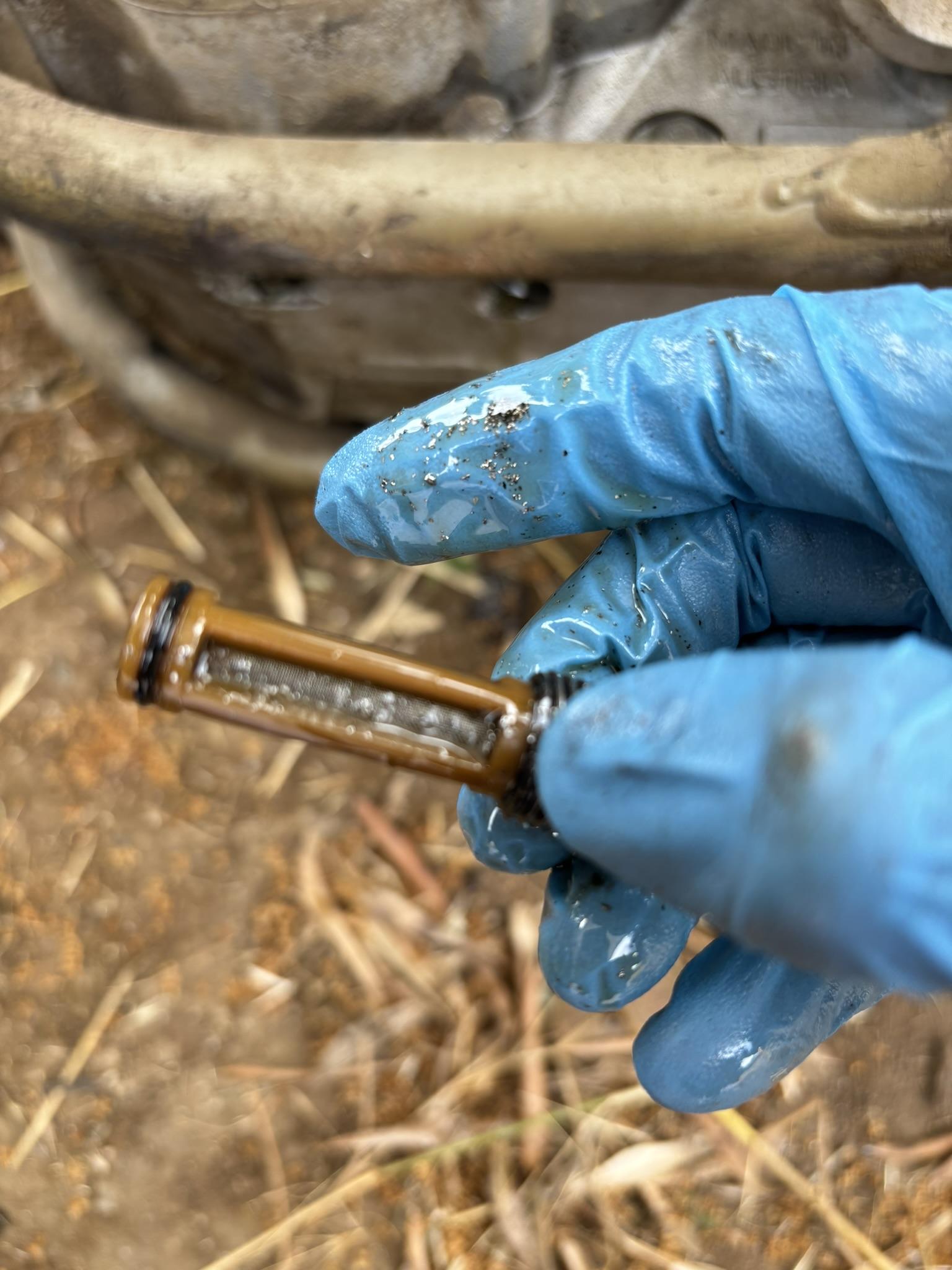

SpaceCowboy 71 Posted June 18, 2024 (edited) Oil filters and screen don't look great... I think that's the forbidden glitter I've read so much about Edited June 18, 2024 by SpaceCowboy 1 Share this post Link to post Share on other sites
DSM8 427 Posted June 18, 2024 ooo that is gonna be expensive, might be worth looking for a new motor that runs vs full rebuild, if you dig into it make sure to check for crankshaft spreading. Share this post Link to post Share on other sites

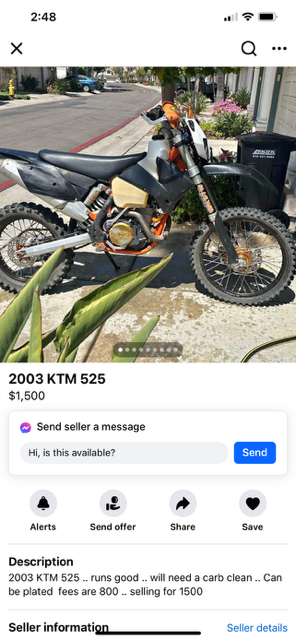

tntmo 971 Posted June 20, 2024 There’s a 2003 on FB marketplace for $1500 right now with $800 back fees. Would make a good donor possibly? 1 Share this post Link to post Share on other sites

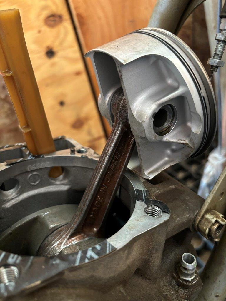

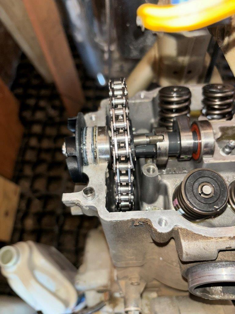

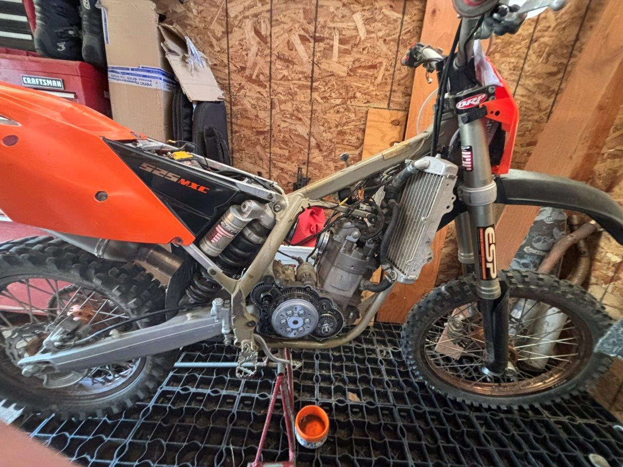

SpaceCowboy 71 Posted September 2, 2024 Got the 525 torn down... it wasn't as we thought... More to come tomorrow Share this post Link to post Share on other sites
tntmo 971 Posted September 2, 2024 The plot thickens…. Share this post Link to post Share on other sites
DSM8 427 Posted September 3, 2024 19 hours ago, SpaceCowboy said: Got the 525 torn down... it wasn't as we thought... More to come tomorrow so it's tomorrow. Post up slacker! Share this post Link to post Share on other sites
Pokey151 303 Posted September 3, 2024 yeah, we are waiting Share this post Link to post Share on other sites

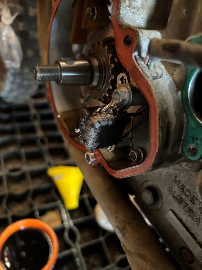

SpaceCowboy 71 Posted September 3, 2024 Something doesn't look right with that timing chain Share this post Link to post Share on other sites
SpaceCowboy 71 Posted September 3, 2024 Something doesn't look right with that magnetic thingy Share this post Link to post Share on other sites

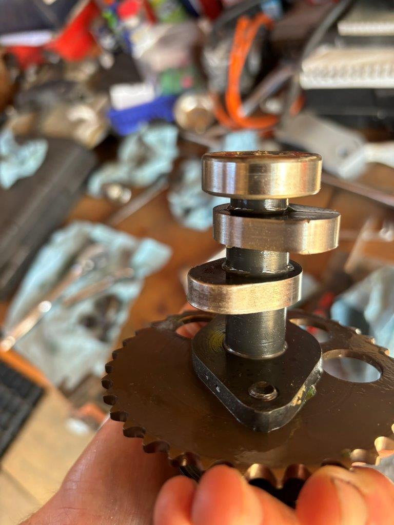

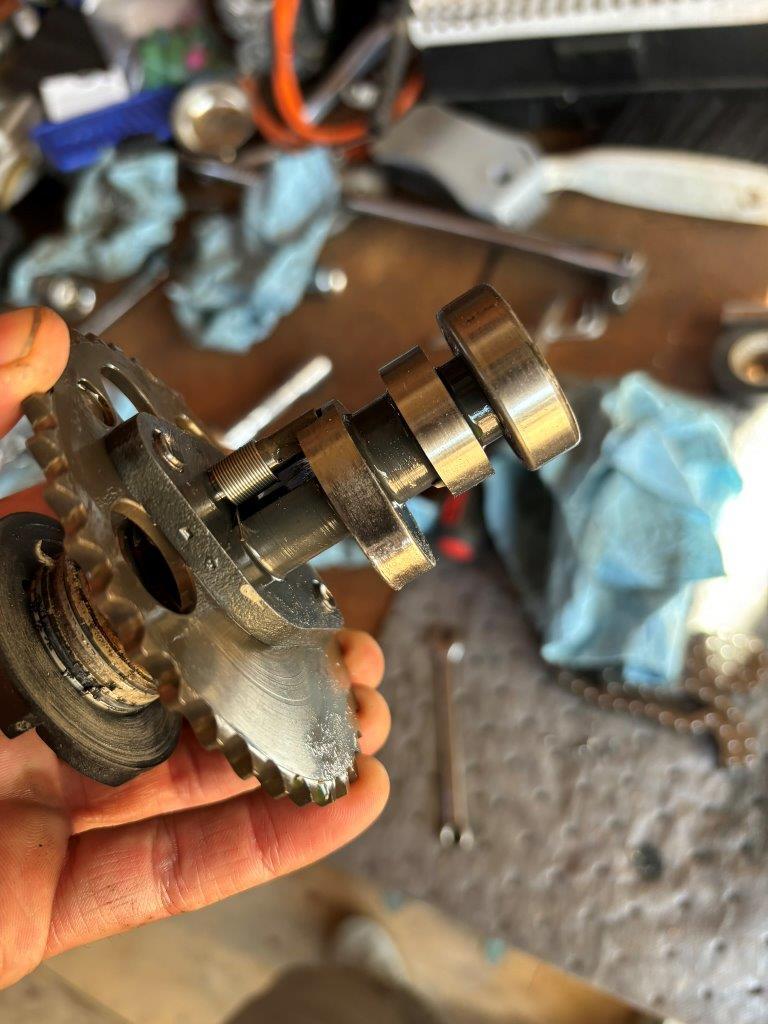

SpaceCowboy 71 Posted September 3, 2024 (edited) Disassembled bearing don't look right either Edited September 3, 2024 by SpaceCowboy Share this post Link to post Share on other sites

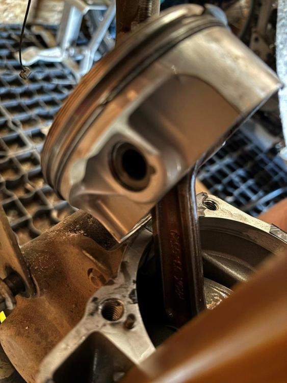

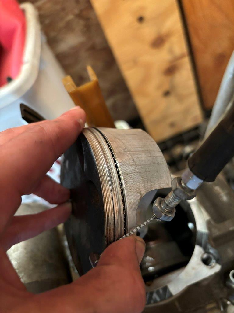

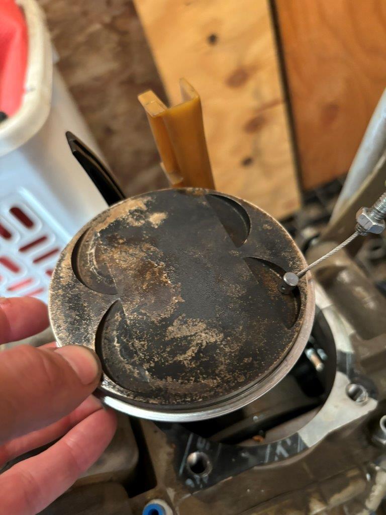

SpaceCowboy 71 Posted September 3, 2024 crank feels great. Piston got some wear, maybe ate some small metal pieces, but looks surprisingly nice. I've got a wosner piston on the way. And some ebay pre-owned rockers and cam and new gaskets too. I'll clean the bottom end out as well as I can, but won't be split the cases. Share this post Link to post Share on other sites

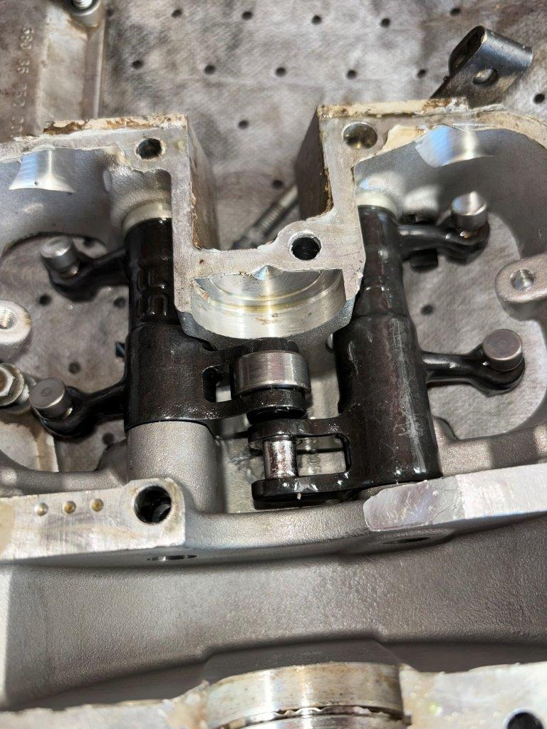

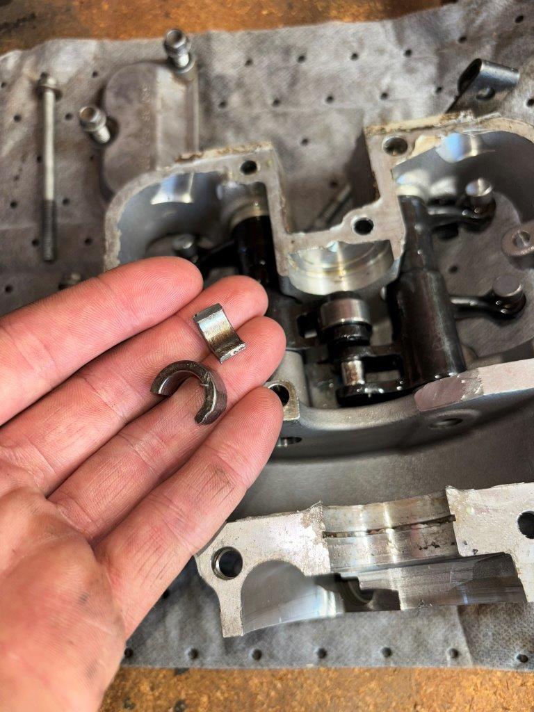

SpaceCowboy 71 Posted September 3, 2024 (edited) Valves look fantastic. I'm thinking/hoping this bike was recently rebuilt with that new crank, piston, and valves. Also, the internet says this rocker bearing failure is uncommon on RFS bikes. Do ya'll think I should replace the bearings on the pre-owned rockers? Or only replace them if they feel crunchy or loose? Edited September 3, 2024 by SpaceCowboy Share this post Link to post Share on other sites
tntmo 971 Posted September 3, 2024 I know someone else that had the same thing happen. Maybe it’s not common, but you’re not the only one that’s been down that road. 1 Share this post Link to post Share on other sites
DSM8 427 Posted September 3, 2024 you have it this far apart, only makes sense to replace what you can that is in your budget to give it the best change at longevity if you intend to keep it. Now about that trailer........ 1 2 Share this post Link to post Share on other sites
