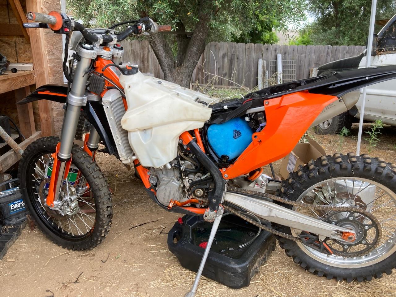

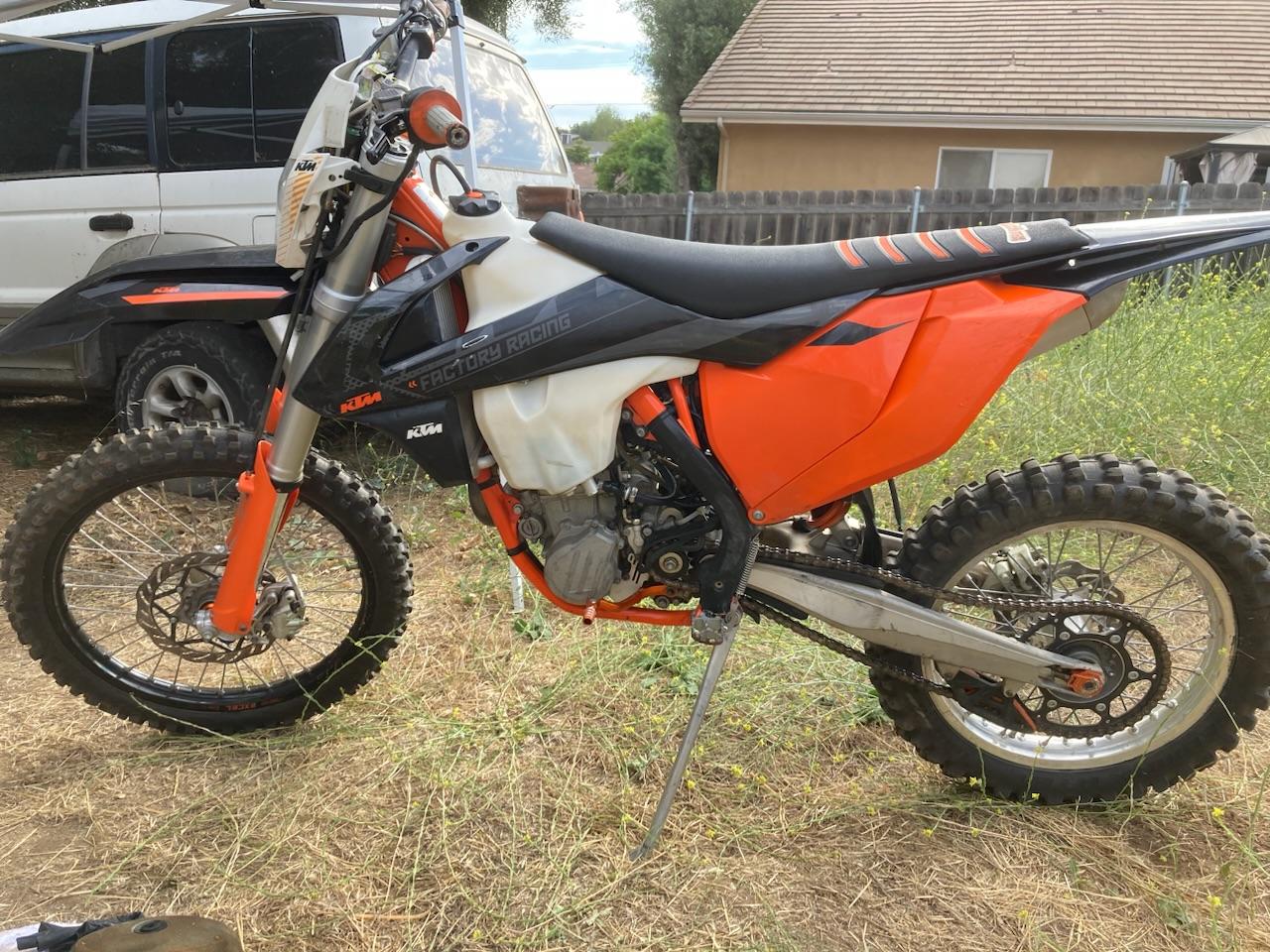

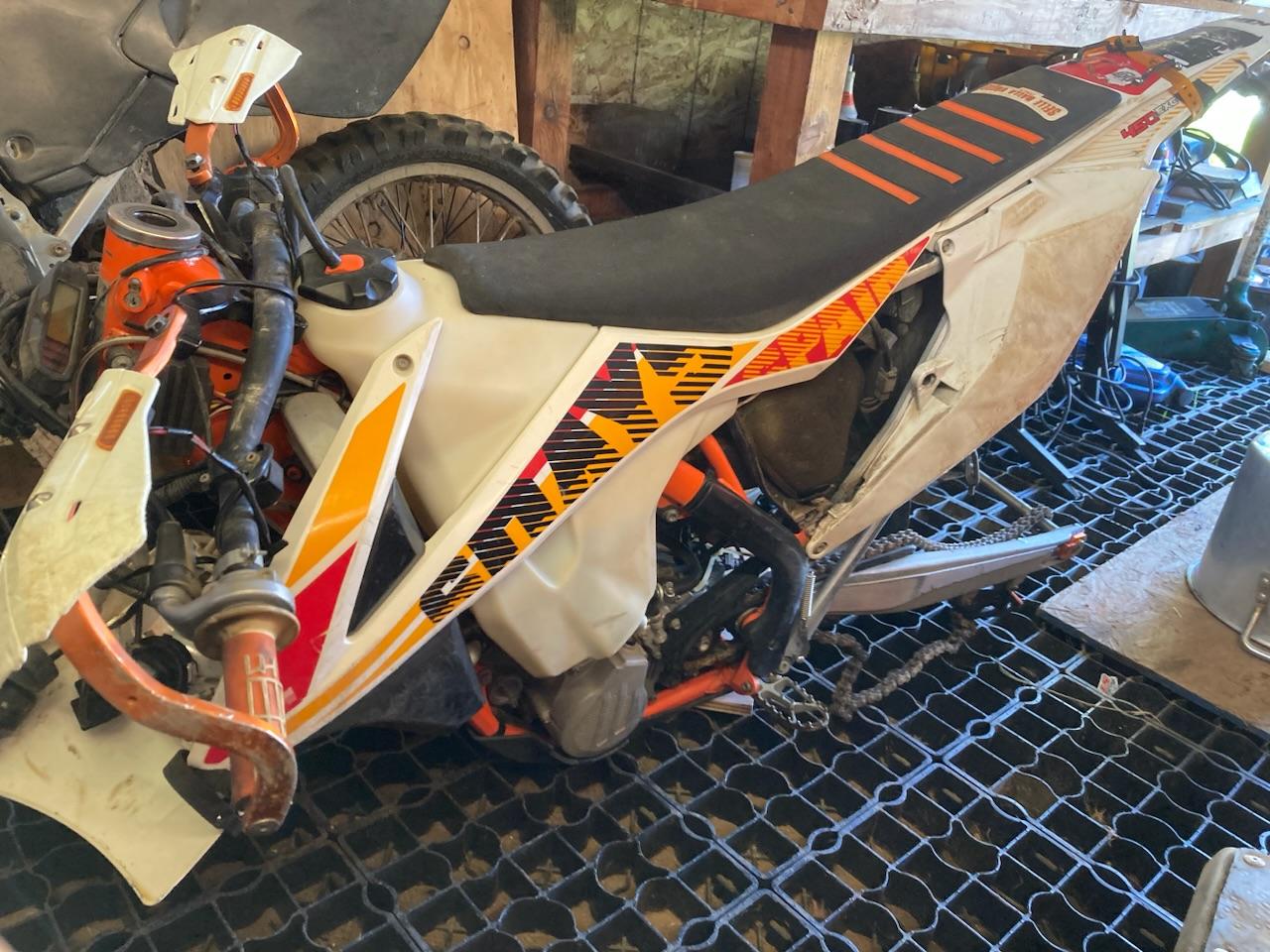

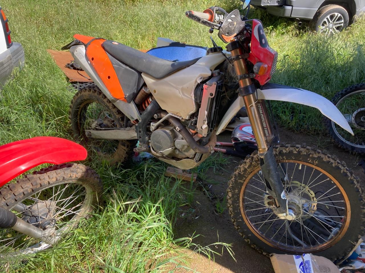

SpaceCowboy 71 Posted March 27, 2023 (edited) A few of you know my 2009 400 xcw that I’ve been ragging on for a while. Keeping alive with rotella and clean air filters. Drinks oil like a two stroke: A few weeks ago I picked up a salvaged 2017 450 exc that had been t boned, then stripped of the wheels, brakes, triples, some other stuff any guesses what the plan is? Edited March 27, 2023 by SpaceCowboy 1 Share this post Link to post Share on other sites

SpaceCowboy 71 Posted March 27, 2023 (edited) 17 hours ago, tntmo said: Install pedals, get giant calves? 17 hours ago, Mr.JAJA said: Build a 3 wheeler? 3 hours ago, robertaccio said: Make 1 good one from 2 bad ones. 2 wrongs can make a right. I love projects... this is another good one. Best of show!! 3 hours ago, DSM8 said: Give up riding and take up hiking, delivering food in your spare time when not working as an uber driver? My brain don't work good enough to balance on two wheels and pedal at the same time. My brain do work good enough to never ride a 3 wheeler. The uber thing dont sound too bad, at least I'd be making money instead of always spending on dirt bikes. 3 hours ago, robertaccio said: Make 1 good one from 2 bad ones. 2 wrongs can make a right. I love projects... this is another good one. Best of show!! 2 hours ago, dirt dame said: Make two expensive boat anchors?👀 WINNER WINNER hoping to end up with at least one running motorcycle. May end up with a couple of boat anchors... Only one way to find out Edited March 27, 2023 by SpaceCowboy 1 1 Share this post Link to post Share on other sites

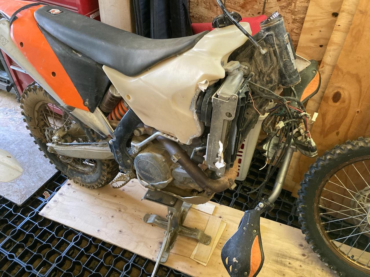

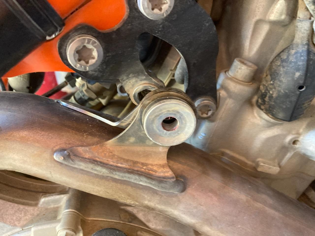

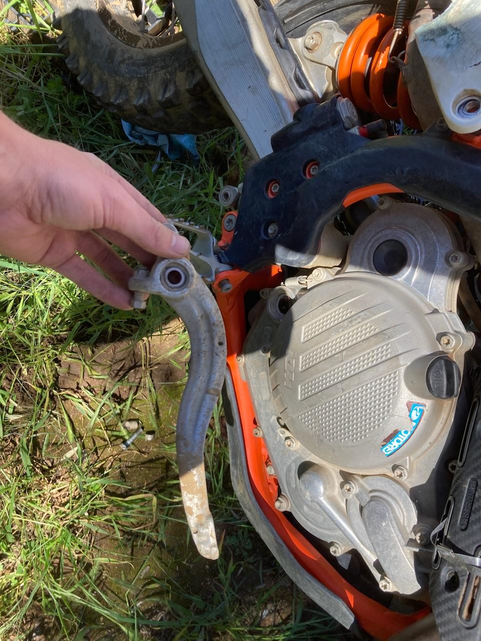

SpaceCowboy 71 Posted March 27, 2023 Progress Close up of the damage from the t bone. Subframe and exhaust bent in, touching the spring. Shock body broke leaking all the goo out. New(used) subframe and exhaust on the way. Hoping to rebuild shock, replacements are tough to find (expensive) for the pdf katoom: 1 Share this post Link to post Share on other sites

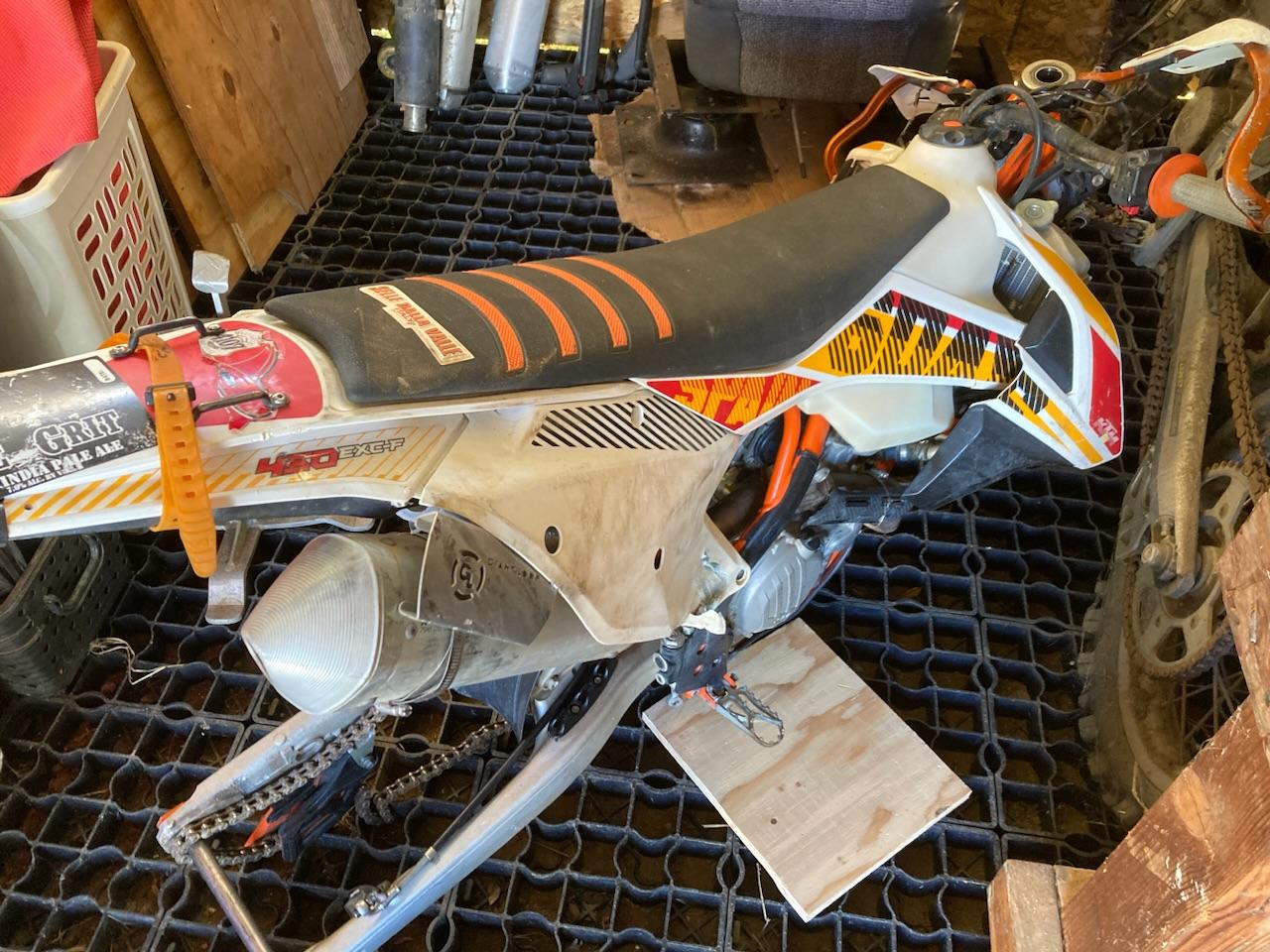

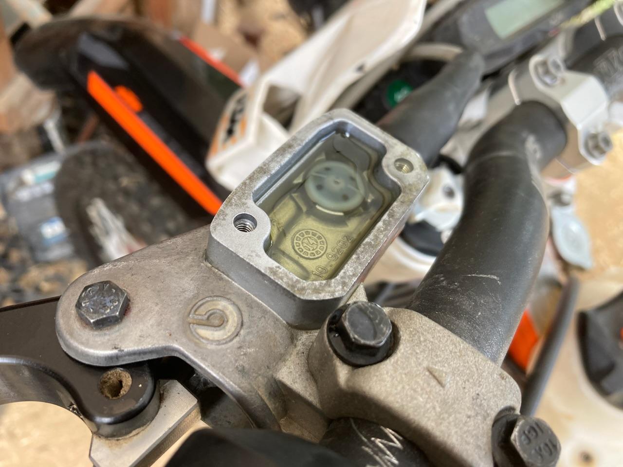

SpaceCowboy 71 Posted April 2, 2023 Back wheel, spacers, axle and brake caliper swap over. Brake pedal is different bike is complete and ready for test ride (minus rear brake) clutch master swapped over and works great. Shifter fits but isn’t perfect 1 Share this post Link to post Share on other sites
SpaceCowboy 71 Posted April 2, 2023 (edited) Damn this bike sucks, there’s no power. Got back to the shed underwhelmed. I realized I didn’t tighten the throttle tube on the handle bars, so when I twisted the go tube, it was spinning on the bars and not actuating the go cables. Tightened those two 8mm and tried again. GODDAMN we have power. This bike runs great. Starts right up and did I mention the power? Kinda sketchy riding all that power around with no rear brake. also, apparently if the shock has no goo inside, then shock has no damping. at all. really sketchy riding a rocket ship around with no rear brake and a pogo rear end. Edited April 2, 2023 by SpaceCowboy 1 Share this post Link to post Share on other sites

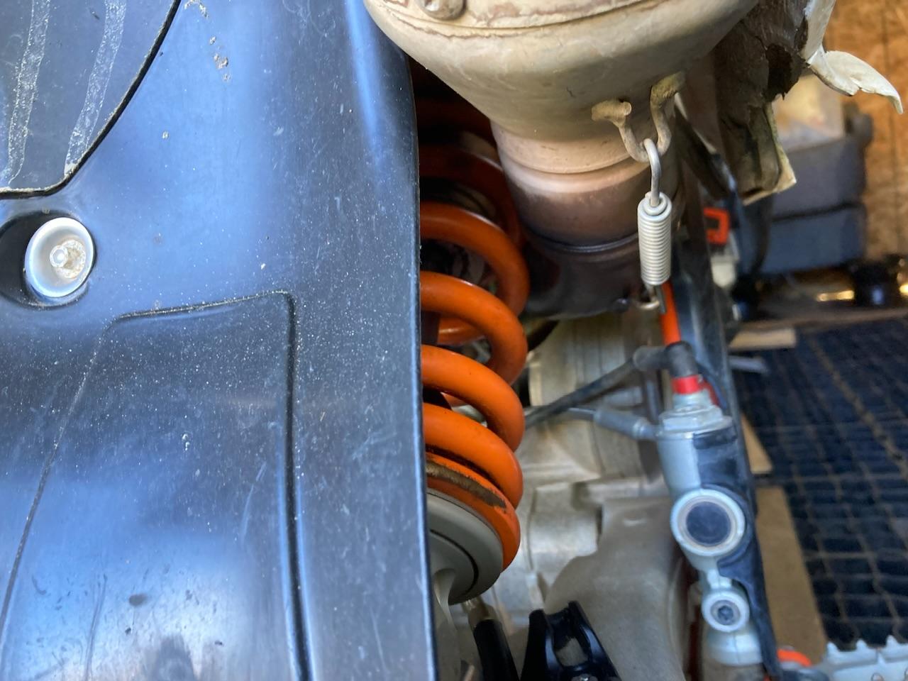

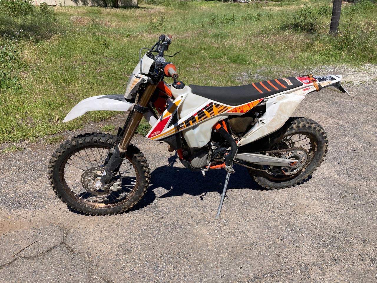

SpaceCowboy 71 Posted April 2, 2023 (edited) Now that I know it rides great, time to replace the subframe and exhaust and shock. All got bent in the crash. All are expensive. Edited April 2, 2023 by SpaceCowboy 2 Share this post Link to post Share on other sites

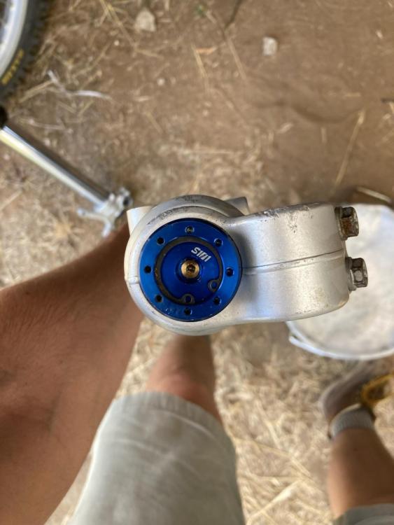

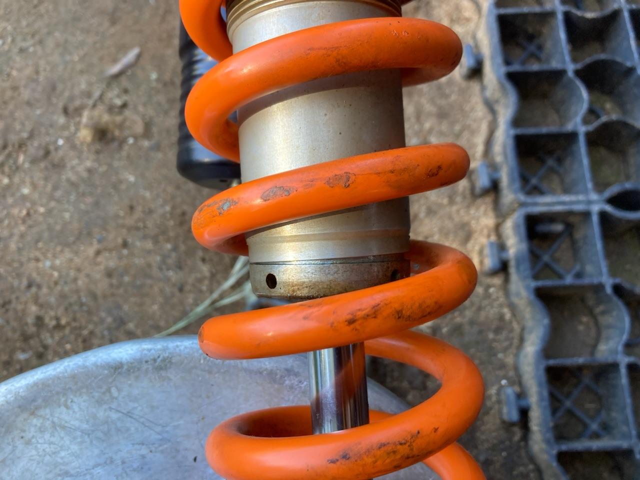

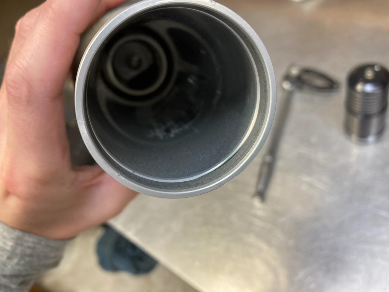

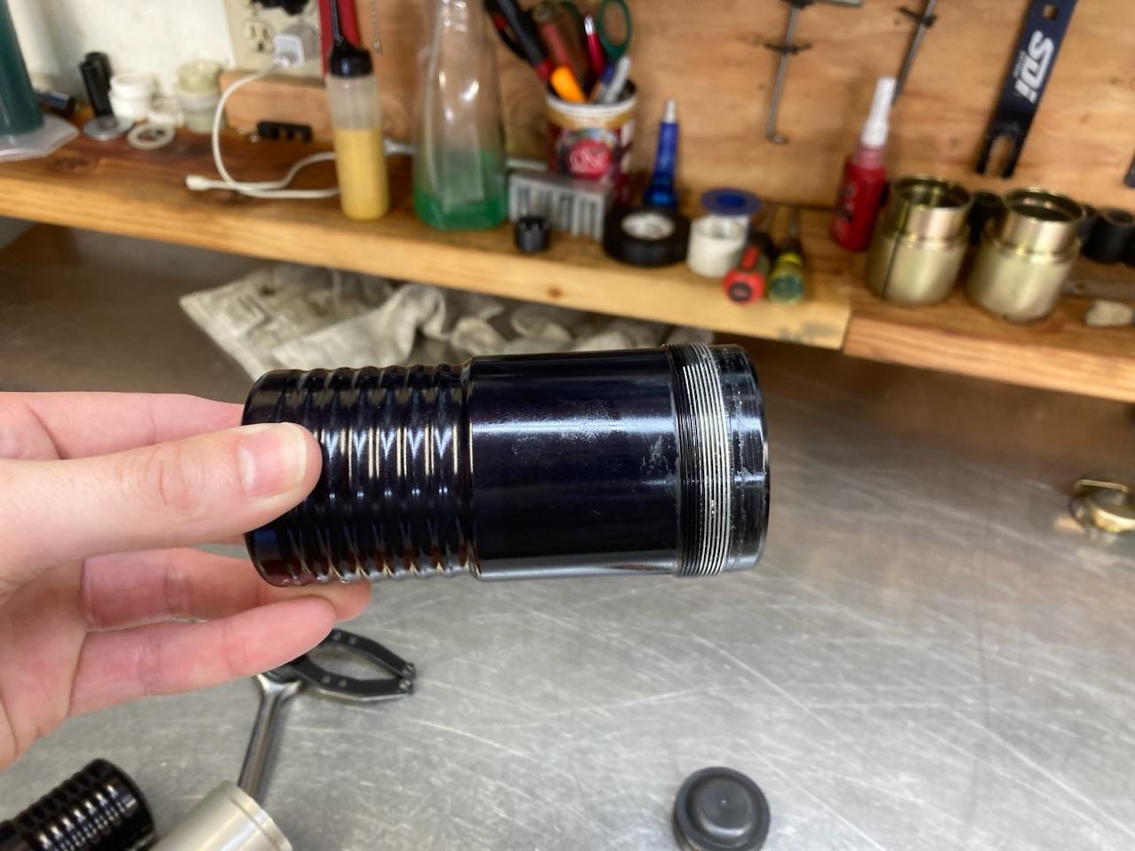

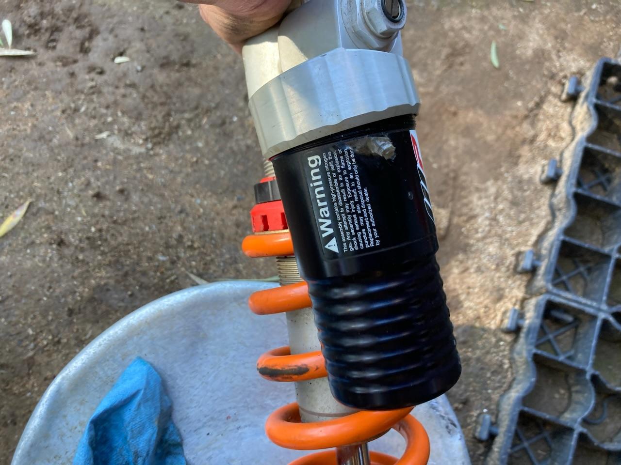

SpaceCowboy 71 Posted May 21, 2023 (edited) got real busy. Continue - Shock looked not good: seal head knocked free, reservoir not straight, inside of shock body gauged. More to come Edited May 22, 2023 by SpaceCowboy 1 Share this post Link to post Share on other sites

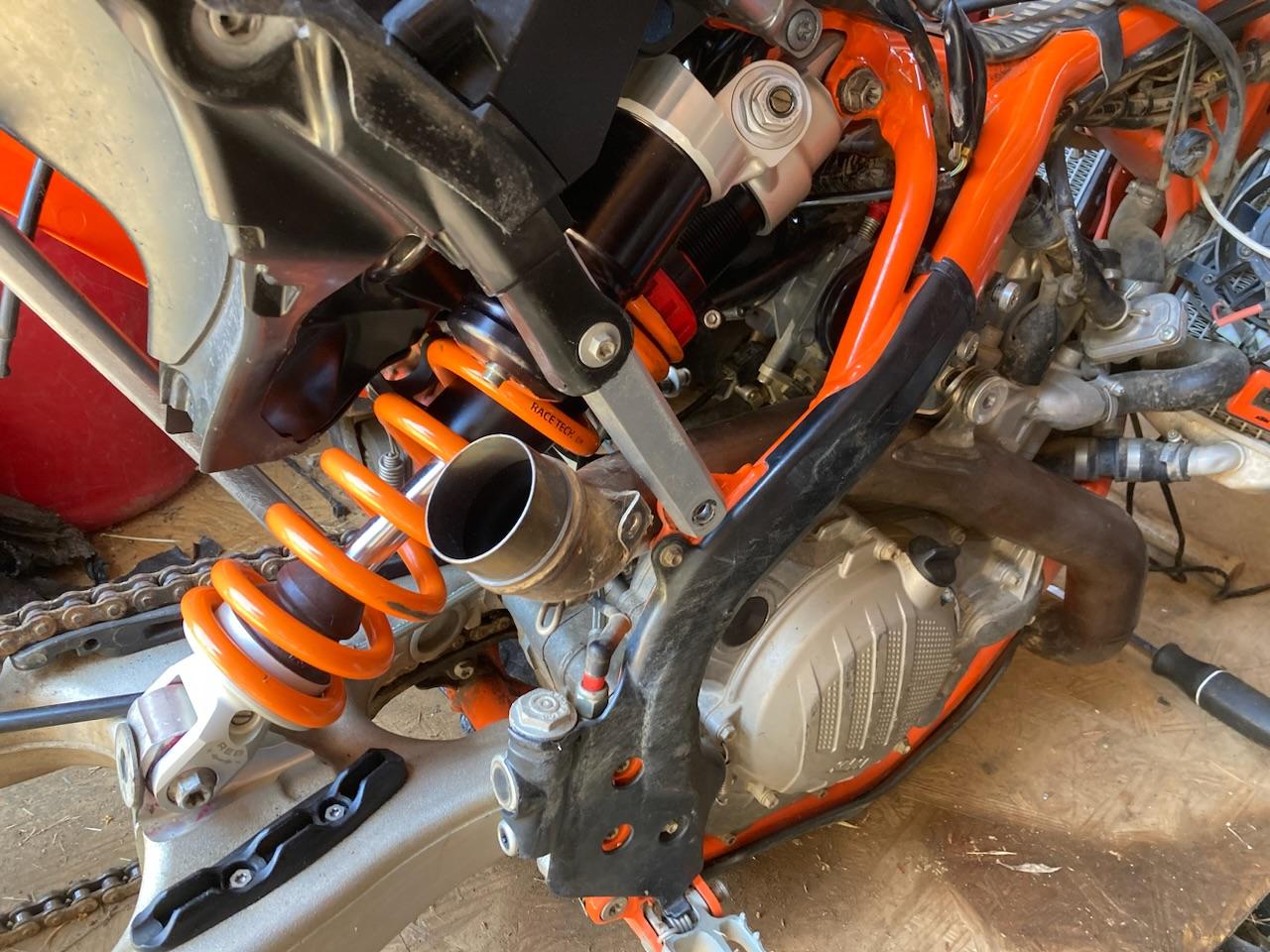

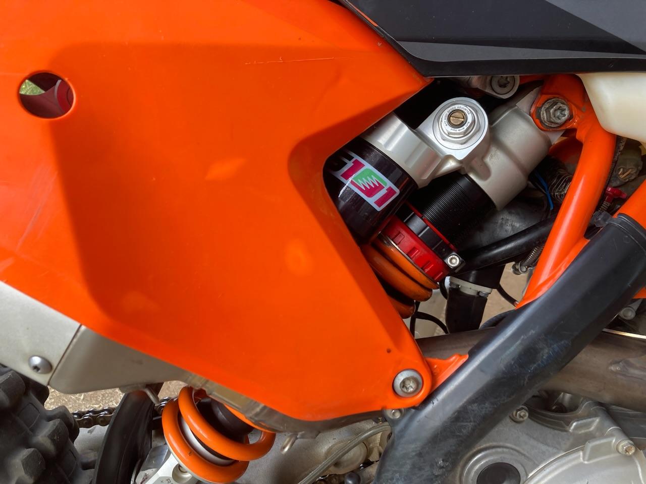

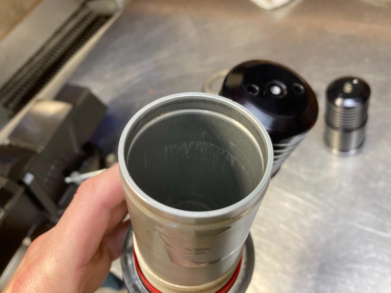

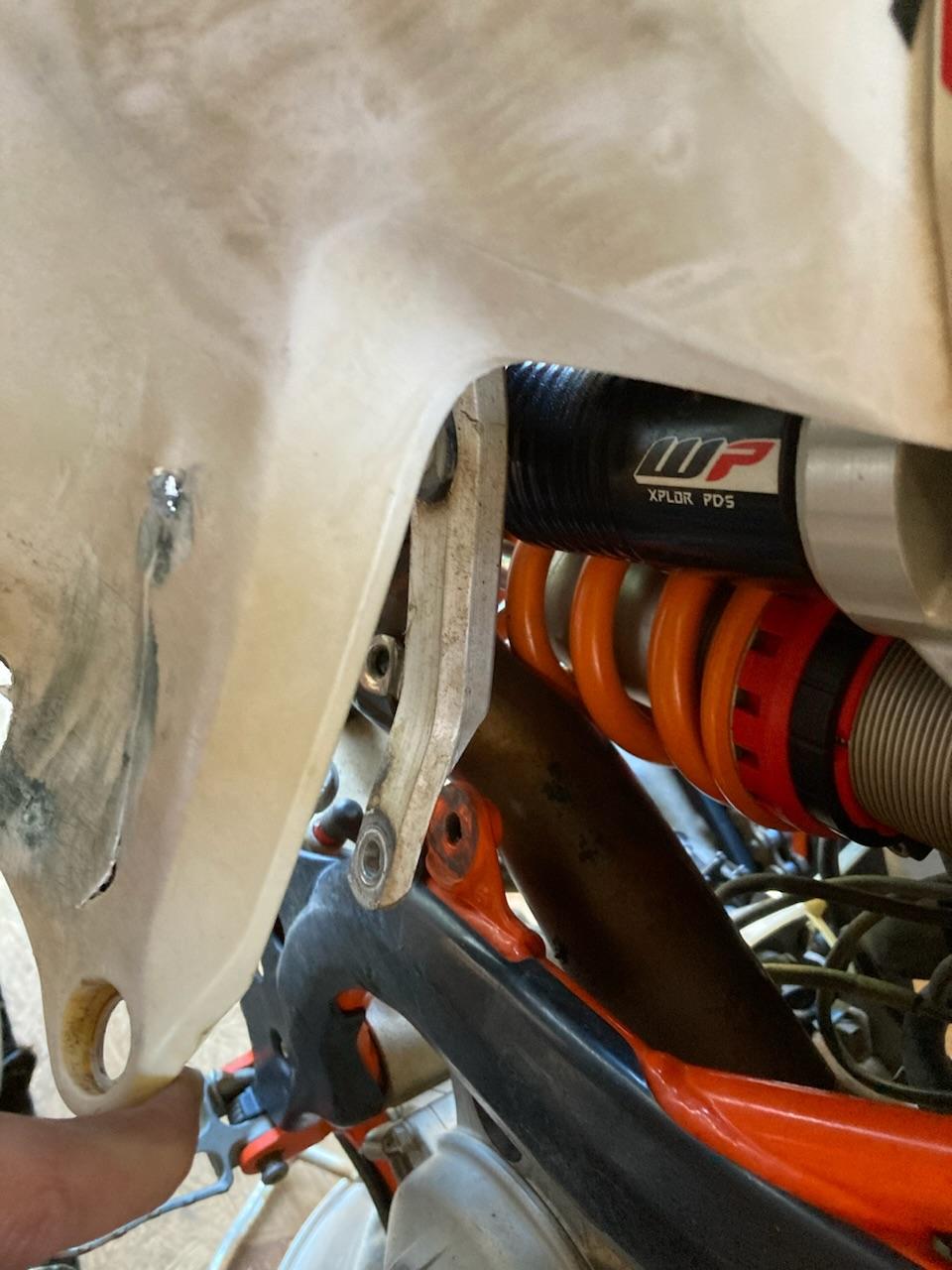

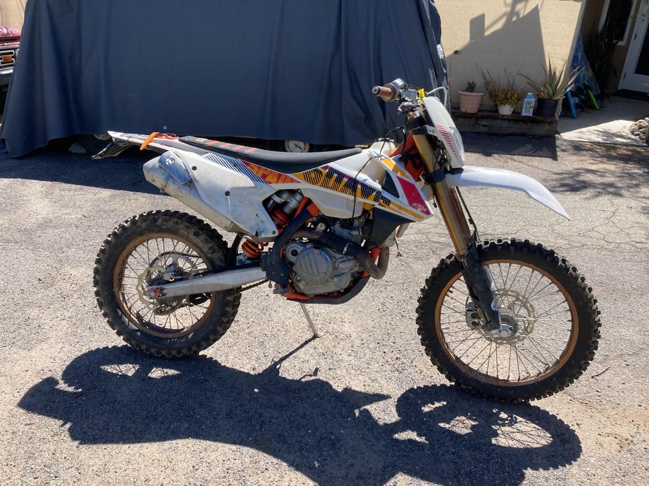

SpaceCowboy 71 Posted June 18, 2023 Suspension 101 was able to salvage the shock! And while we were in there… no point in rebuilding it to stock specs. Might as well do the personalized revalve… and might as well get the special anodizing coating… existing spring was swapped by the PO and is one rate stiff for my weight, but I ride with a heavy pack, so we’ll save $ and try it out. I’ve since lost a few lbs so that might have been a mistake. Anyway, here is the pretty new shock installed also notice the new header. Looks like I’ll also need an exhaust/engine mount and here’s my list of what’s still needed: Ktm 450 need: Rear and front wheel seals, bearings, spacers Sprocket bolts Disks bolts Triple clamp top bolt Grips Engine/exhaust mount Gas tank rubbers Fork guards Sub frame bolt Shifter 3 Share this post Link to post Share on other sites

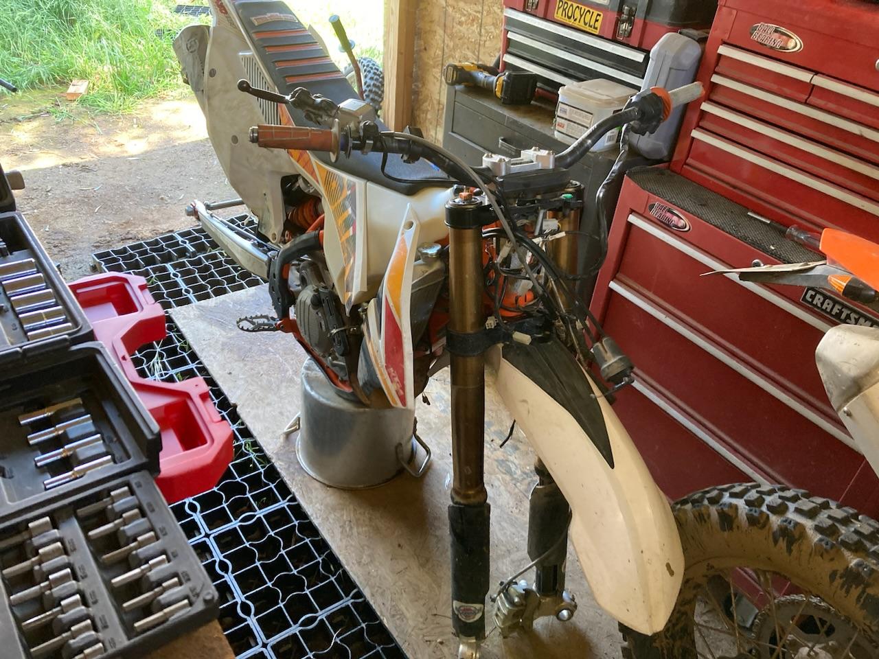

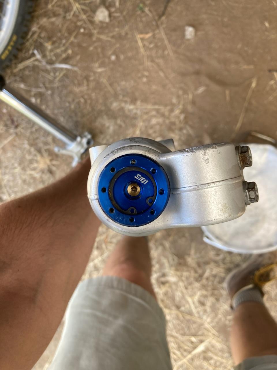

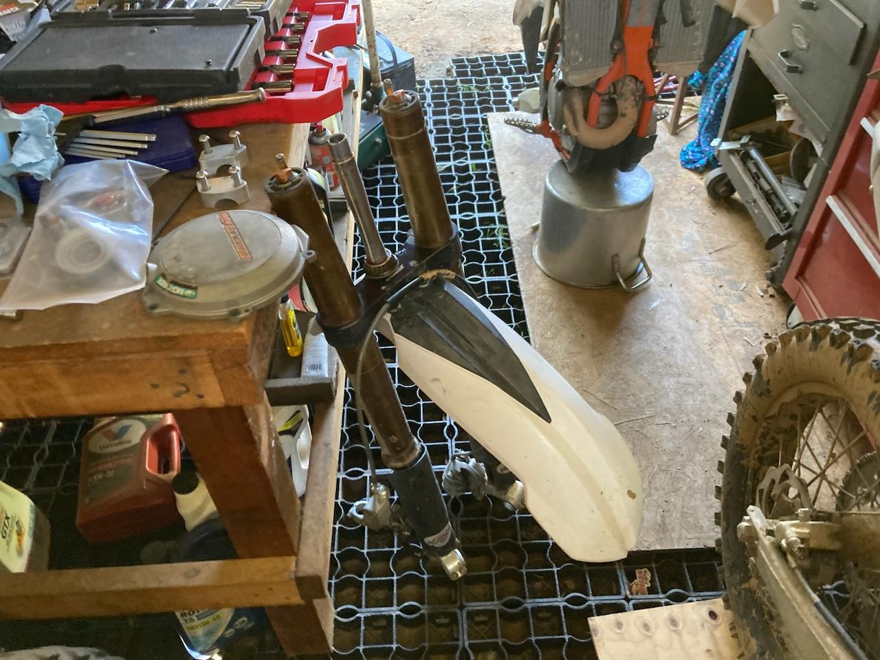

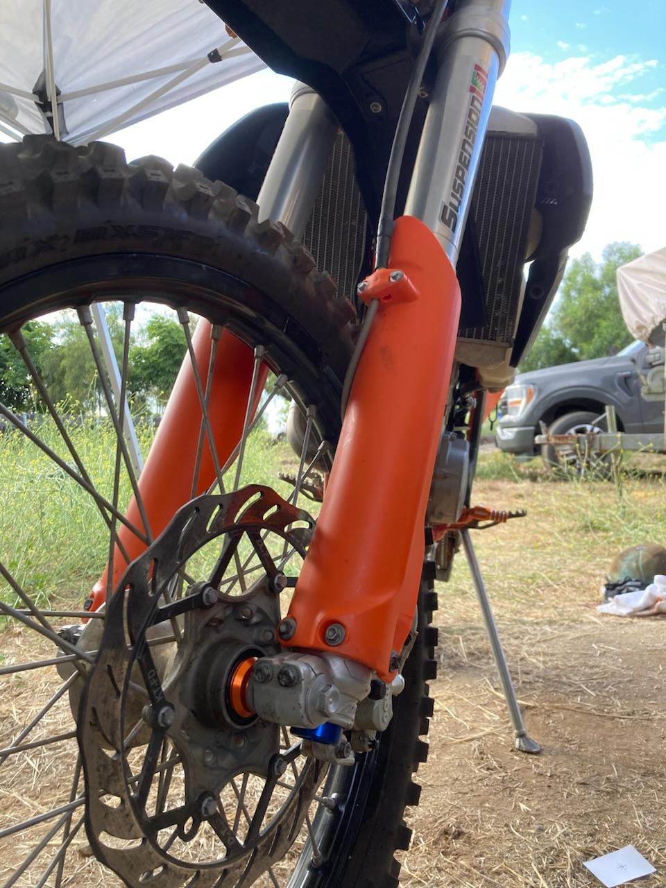

SpaceCowboy 71 Posted July 5, 2023 Got everything together and noticed my forks seals are leaking. I guess another trip to George at Suspension 101 is in order. And while we’re there, might as well try out the gobblers. Dropped off the forks this morning. I’ll keep y’all posted. Never had a bike with both the front and rear freshly setup for me. Super stoked. 4 Share this post Link to post Share on other sites
Bagstr 295 Posted July 6, 2023 SC,, You are going to like that suspension, incl. Gobblers. Fun project. 1 Share this post Link to post Share on other sites
SpaceCowboy 71 Posted August 9, 2023 (edited) suspension 101 all the way around Edited August 9, 2023 by SpaceCowboy 1 Share this post Link to post Share on other sites

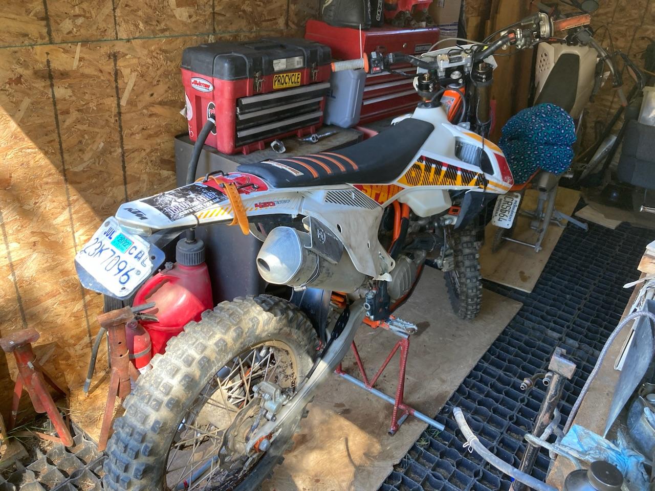

SpaceCowboy 71 Posted August 9, 2023 new clutch blood for the second time after swapping master cylinders again. Also new brake blood front and rear. I’m getting good at this bleeding thing. New oil, air filter, used plastics from OfferUp Share this post Link to post Share on other sites

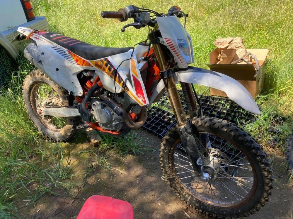

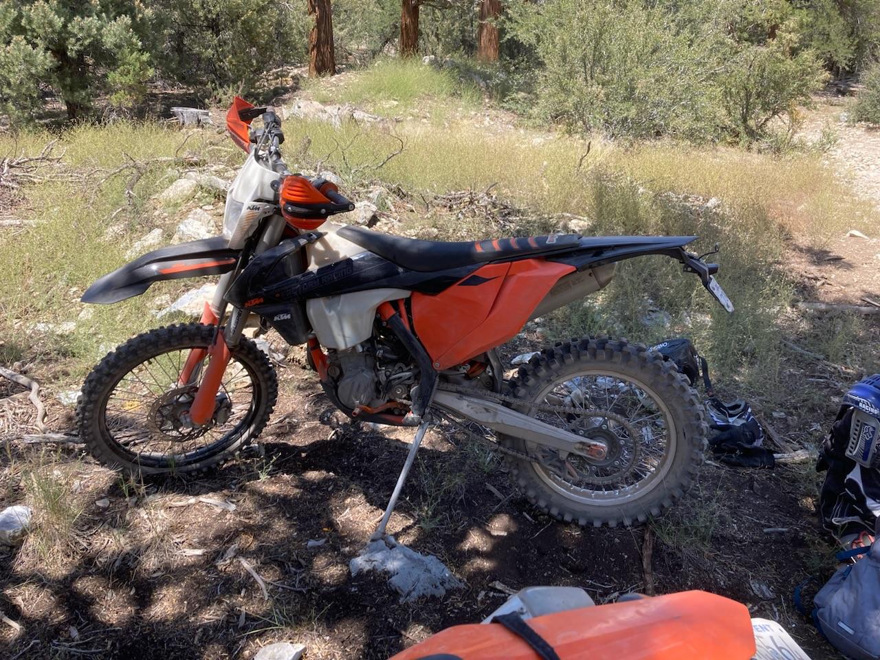

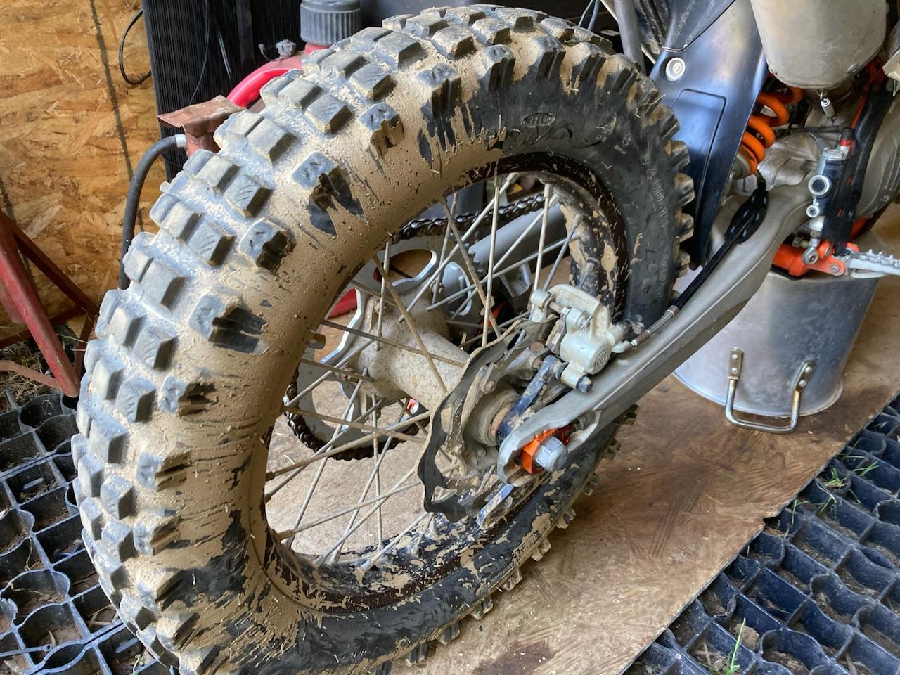

SpaceCowboy 71 Posted August 9, 2023 new rear tire, license plate holder, hand guards. Bike worked great on its first outing. 2 days in big bear. My brother was in town, so he rode this one for the weekend while I rode my 400. I can’t wait to try this 450 out on an extended ride for myself. At first the fan wasn’t hooked up. I thought it wouldn’t matter, as I’ve had tons of dirt bikes without fans. But we boiled over 3 times within 20 mins before plugging in the fan. Then it stayed right at 200 degrees the entire weekend. I guess the fan is really important on these 2 Share this post Link to post Share on other sites
