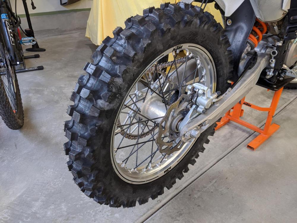

Vintage Veloce 29 Posted January 14, 2020 Ok, I'm just not very good at this. I've watched a zillion videos, read directions, etc. I even posted directions on my own blog, just so I have them handy when I change the tire myself!: https://www.vintageveloce.com/2014/02/detailed-tire-changing-directions-how.html I just changed the rear tire on my KTM, a new Pirelli Scorpion XC Mid Hard 110/100-18. Darn, I have a hard time with it. I do it myself because I want to know how to do it... but I'll be in a nightmare if I have to fix a flat on the trail. New tire, new tube, baby powder, lube, a couple minutes cleaning and checking the directions an torque. In my own garage: took me 90 minutes! I've watched the videos with motocross tires, and it looks like those tires are made of soft bubble gum. Mine just don't go on like that. I want to watch someone experienced do this, with a stiff XCMH. (And yes I know about getting the tire in the down in the drop center!) Share this post Link to post Share on other sites
Covered in Dust 165 Posted January 14, 2020 Summertime put tire in the sun, winter a heat gun is your friend. I have supervised many a flat repair on the trail. CiD Share this post Link to post Share on other sites
Vintage Veloce 29 Posted January 14, 2020 I did put it in the sun today... so it wasn't "cold" but it wasn't really warm either. Like getting the valve in: reaching in one side of the tire would pull the tire up toward the side with my hand. This meant the far side of the tire pulled in, actually past the hole so that the hole was no longer reachable inside the tire. I can't imagine having strong enough fingers to push the far side of the tire out of the way! I ended up just getting lucky when the valve accidentally fell in the hole with my hand out of there. Share this post Link to post Share on other sites
