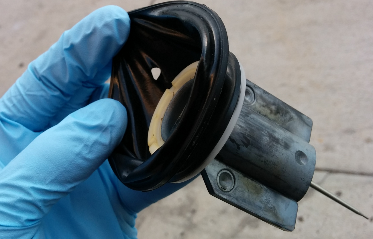

bfar33 175 Posted May 9 The 'ol mule used to do that when the carb diaphragm developed a tear. It would run great until ~4k RPM or so? Then the throttle just didn't do anything, like it hit a wall. I had to replace the slide assembly 3 times over ~70k miles if I remember (can be bought from a Harley dealer for 1/2 price of Kawi part). Guess the new carb rules that out though. Any other source of vacuum leaks? Does the new carb have the petcock vacuum port capped like the original? When you say 'no power' you mean it won't climb RPM anymore? Or it chugs/surges/misfires? What exactly does it do after 4k? 1 Share this post Link to post Share on other sites
Rjg967 75 Posted May 9 1 hour ago, bfar33 said: The 'ol mule used to do that when the carb diaphragm developed a tear. It would run great until ~4k RPM or so? Then the throttle just didn't do anything, like it hit a wall. I had to replace the slide assembly 3 times over ~70k miles if I remember (can be bought from a Harley dealer for 1/2 price of Kawi part). Guess the new carb rules that out though. Any other source of vacuum leaks? Does the new carb have the petcock vacuum port capped like the original? When you say 'no power' you mean it won't climb RPM anymore? Or it chugs/surges/misfires? What exactly does it do after 4k? It's worth inspecting again. No surging, misfires, or anything. Runs amazing but gutless, but absolutely WFO the best I've been able to get is 62 mph. 1 Share this post Link to post Share on other sites
bfar33 175 Posted May 9 So weird, that's exactly the way it used to present when it had that issue in the past. Sometimes the tear was small and could only be seen when I stretched the diaphragm a bit like shown above and looked for light coming through. Good luck 1 Share this post Link to post Share on other sites

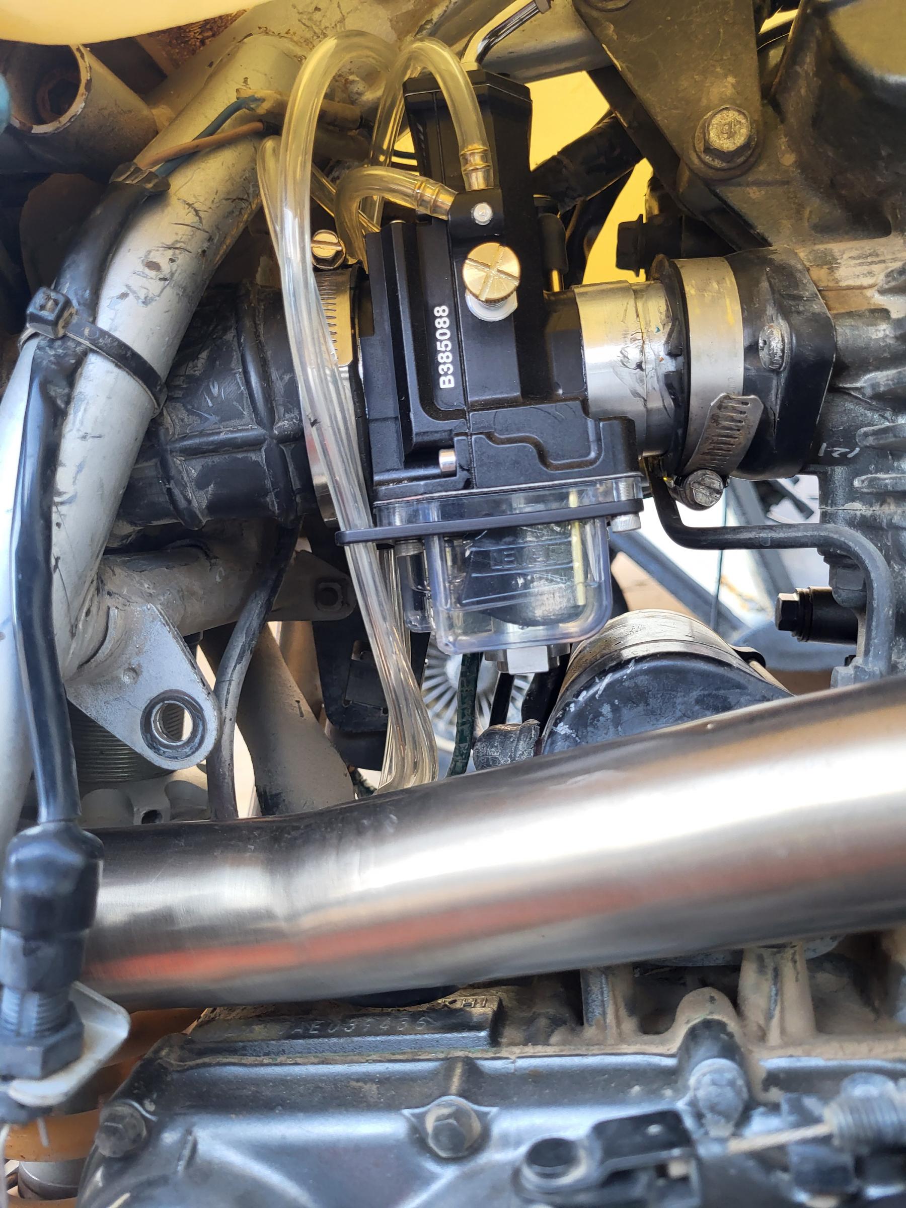

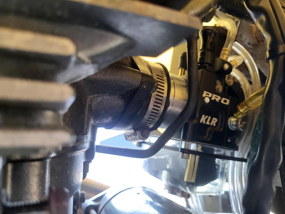

Rjg967 75 Posted Tuesday at 12:05 PM (edited) So to bring back a dead thread, I did want to mention I figured out the issue. The barrel for the enriching valve was leaking air, so it was just running super super rich, despite the spark plug looking clean. I ponied up and got the Lectron carb. The throttle response is weirdly fast, like a tuned EFI bike. It has power everywhere. Also, these don't have a choke or enrichening valve, so you just start your bike, it's weird. Lol PS: never mind the incorrect hose clamps, the correct size ones are already installed... Edited Tuesday at 12:06 PM by Rjg967 2 Share this post Link to post Share on other sites
bfar33 175 Posted yesterday at 03:43 AM I don't understand all of these technical terms, does it wheelie or not? 😁 Glad to hear it's back on the roads/trails, congrats! 1 Share this post Link to post Share on other sites
Rjg967 75 Posted 7 hours ago 19 hours ago, bfar33 said: I don't understand all of these technical terms, does it wheelie or not? 😁 Glad to hear it's back on the roads/trails, congrats! KLR, wheelie? First, maybe second gear. This thing is basically like an '80s motorhome with a big block, sounds pretty good, has plenty of torque, but it sure isn't going fast. Lmao Share this post Link to post Share on other sites
