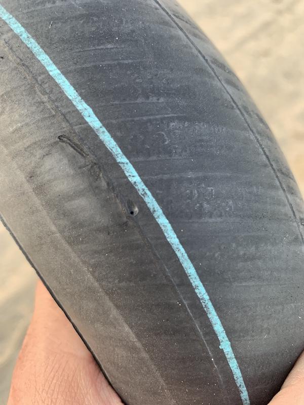

Goofy Footer 549 Posted January 12, 2021 Smacked a rock on wait for it... Rockhouse Canyon Rd and noticed tire deflation after. 4 ply Desertone GoldenTyre 216AA Fatty -- is the 4py no longer in production? -- with IRC HD tube blend of natural and butyl rubber I didn't use Slime. Do you think it would have stopped this leak? Share this post Link to post Share on other sites
DSM8 423 Posted January 12, 2021 That is exactly the kind of leak it was meant for, small pinholes. I use the ATV?Offroad version of slime it has more leak blocking fibers in it than the standard stuff. I never run HD tubes on the 990. Share this post Link to post Share on other sites
