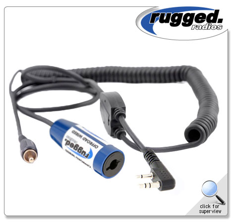

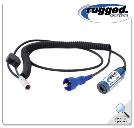

beniflas 9 Posted January 23, 2018 (edited) Another thing to consider about that kit is that it's hardwired for the RH5R or Kenwood radios only. They offer a harness that can accept different "jumper cables" depending on what radio you're using. This can come in handy if happen to use a different radio brand/model. All you would have to do is get the corresponding jumper cable. https://www.ruggedradios.com/index.php?main_page=product_info&cPath=1104_1239&products_id=147 1st pic is the hardwired version, 2nd pic is the one that can use different jumper cables Edited January 23, 2018 by beniflas Share this post Link to post Share on other sites
Bagstr 295 Posted January 23, 2018 2nd Picture Please Share this post Link to post Share on other sites
beniflas 9 Posted January 23, 2018 Hardwired harness Share this post Link to post Share on other sites

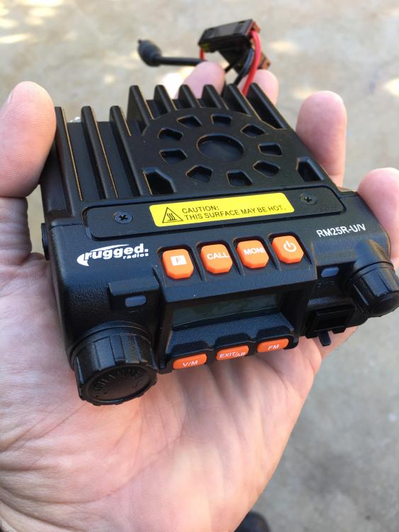

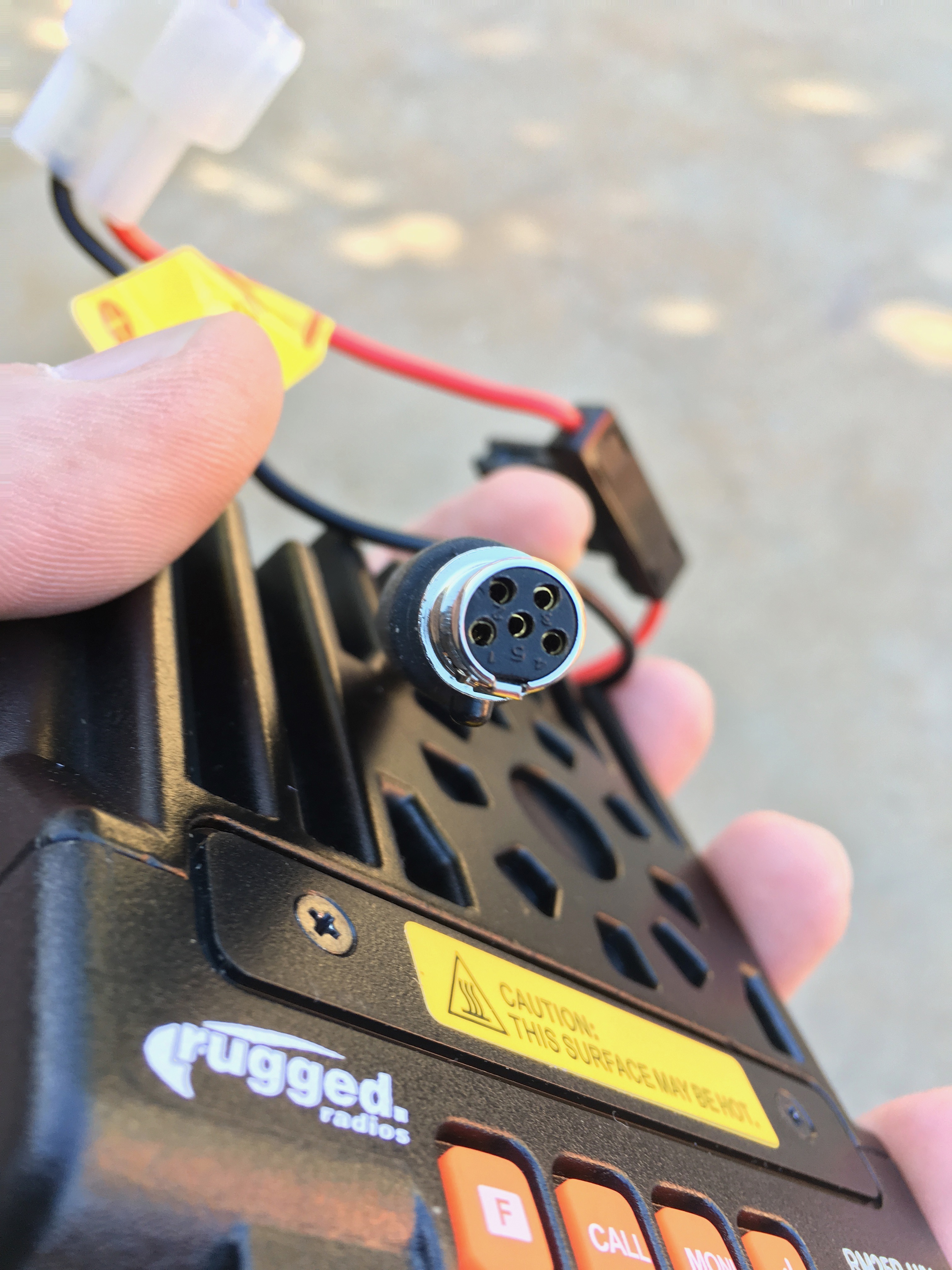

paulmbowers 236 Posted January 26, 2018 Since we started using comms I've been a bit disappointed with the range. I've wanted a solution where I can use a higher-watt radio and an external antenna, but continue to use the existing helmet setup- works pretty good. Not a lot of options to do so, and would take a bit of soldering and fiddling. But I was trolling the Rugged site the other day- lots of new options, especially for the SxS market. I found this radio in the demo section for $100. Compact size- not much bigger than a walkie-talkie. 25 watts, dual-band- it's a rebranded BaoFeng at slightly premium cost. BUT! They've done a little micro-surgery and lookie here at the familiar pigtail they've added! Plugs right into the RR harness system. I popped the case off to have a look- it's not something I'd really undertake as a DIY job, which means should I go this route, I'd be unable to buy a cheaper BaoFeng off radio from Amazon and convert it myself. Besides, they've done the work, they deserve the extra $35-ish out of my pocket. They also offer a very similar radio that is waterproof. Stay tuned. (Isay that's a joke, son) I'll be working on a bike-mounted box/container and an external antenna solution. Share this post Link to post Share on other sites
Sneeker 29 Posted January 26, 2018 That looks like neat radio. I've been looking at similar configurations. Very interested. So what's the antenna and ground plane solution for the 25 watts? The antenna is always the pinch point, otherwise you're just turning the added watts in to heat energy instead of radio frequency output. Share this post Link to post Share on other sites
paulmbowers 236 Posted January 26, 2018 Antenna is certainly a problem. Easy enough to mount one, and they even offer antennas that “don’t require a ground plane”. It’s nice they say that, but it does not cancel out the laws of physics. I suspect any external mounting solution will outperform a rubber ducky stuffed in a backpack, but by exactly how much is subject to real-world testing. Other antenna issues- does it get in the way? Can I swing my old leg over it? Does it stab me in sensitive areas of my body during a fall? Does it break off during a fall? Is a 1/4 wave length sufficient? Who knows? Share this post Link to post Share on other sites
PbdBlue 46 Posted January 28, 2018 In order to use an antenna without a ground plane it must be a half wave antenna. A half wave antenna without a ground plane will perform essentially as a quarter wave with the other quarter wave segment acting as a ground plane. Not very efficient but much better than a rubber duck. Any quarter wave antenna must have a ground plane to perform correctly and you will not be able to tune a quarter wave antenna to an acceptable SWR without a ground plane. Not good for performance and not particularly good for the transmit section of your radio. Half wave antennas are typically ~38" long however Comet makes a shortened version using a loading coil that's 27". Still kind of long but a little better. https://www.amazon.com/Comet-SS-680SB-Spring-Antenna-Warranty/dp/B00Q5I8OK4/ref=sr_1_1?ie=UTF8&qid=1517174214&sr=8-1&keywords=ss-680sb Share this post Link to post Share on other sites
