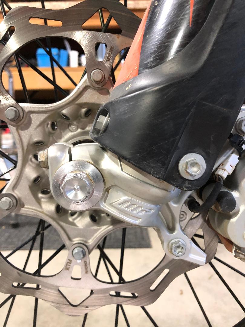

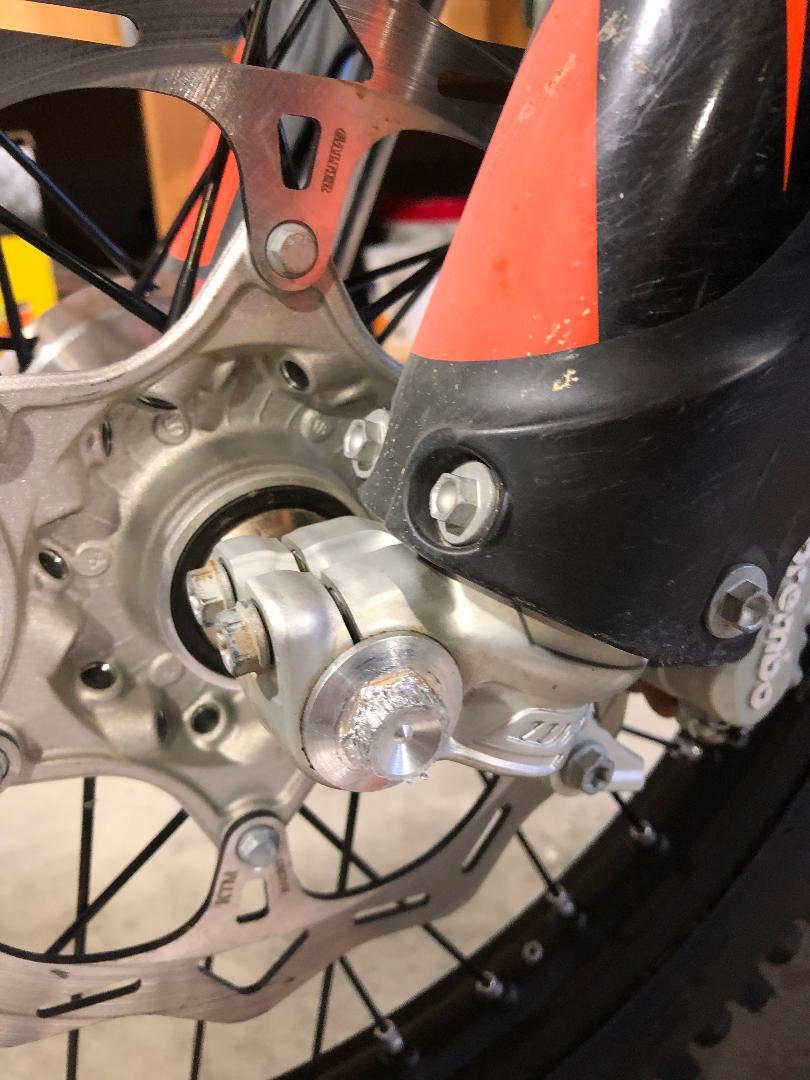

simicrintz 177 Posted November 3, 2019 It's a nut that threads in to the bottom of the fork and captures the axle. Once you loosen the 10 mm bolts you unthread that nut and then the axle slides out. All went well (and easy) until I went to put it back together and snugged the nut too hard and then slipped with the torque wrench. While embarrassing, here's a few pics of the damage in the current state. Heading up to Mom's for the work party soon and hoping to get back on this this afternoon. Share this post Link to post Share on other sites
simicrintz 177 Posted November 3, 2019 If I remember correctly, the nut threads into the axle (I did not look real close since I didn't expect to have problems!). I have not found any good diagrams online yet to confirm this and am still looking. My first blush at this point is to try and get a small pipe wrench on this while I still have some surface like Tom said. Probably try and grind some flat spots to get a good platform like LB suggested first. If that does not work I imagine that I will be looking more along the lines of drilling or a reversing drill bit. The other side (right side looking down from the seat) also has a nut and it just spins. The shoulder is much thinner so I am being very careful turning it, but that seems odd to me as it was all connected to the axle. Maybe the axle is just captured by the nut on the other side and is floating inside of it. Again, if I could find a good exploded diagram I wouldn't have to be guessing 😡 While I would like to blame the torque wrench (I still may take it back and get a better quality one), it was my fault. When you guys field change a tube and have to do this, are you just using a wrench and tightening to feel? I'll be honest and say that I never really paid much attention to torque specs and have always tightened by feel without any issues. For some reason I felt the need to "do this right" this time. Share this post Link to post Share on other sites
Beta450 1 Posted November 3, 2019 I would spray WD40 or equivalent penetrating oil on the left side of the axel in the pinch bolt area and let it sit for about 15 minutes.  The right side pinch bolts should be tight so the axel can't spin.  From the pic the nut looks rounded so, try the vice grips fist and make sure you get a good bit on the nut and try to turn it.  I can't believe you are having such a hard time with the axel nut but, things happen. Another method that I have used with great success is the use of a punch and hammer.  Be careful not to damage the axel threads. Share this post Link to post Share on other sites
