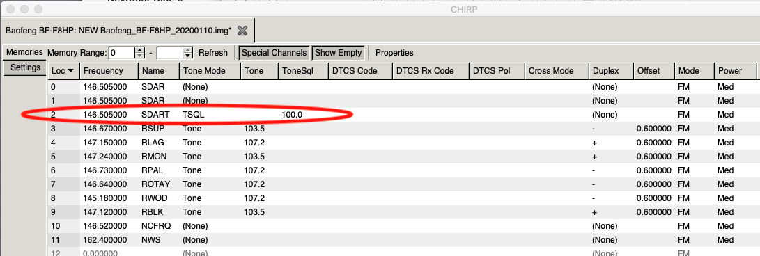

paulmbowers 236 Posted January 14, 2020 38 minutes ago, MacDuncan said: It is always funny how quickly these snippets of info go beyond my knowledge - but I still want to learn. From last Saturday's ride: 1) about half way through the ride, I took the my rugged rh5r radio off my chest protector, on front, in a pouch ), and took the short standard ducky antenna off, and put on a ~ 14 inch rugged long ducky antenna on it, and then put the radio deep down my camelbak except for about 3-4 inches of antenna sticking out (so it wouldn't tap my helmet) (I haven't done that before because I like to be able to reach my on-off and volume). Immediately, I heard my buddies with far better clarity and they said my voice was significantly more clear (They have the Baofengs, uv5r with short standard antenna strapped on their chest protectors - but in the box that their radios came in, there is a longer antenna to use (careful if you buy the box of stuff because the longer antenna is hidden in the box under packaging - so don't accidentally toss it!)). We were having good conversations up to about 70 yards before the change, but that about doubled with just my antenna change. If they did the same change, but actually using that skinny ~14 inch antenna from Baofebg box, would there still be a significant benefit for all? Would we all benefit even more if we all used something as noted in this antenna topic strand like a "701"? 2) Strange, that one time when 2 of us lost the 3rd rider, I couldn't hear a reply in my helmet, but I could hear a reply coming through my friend's helmet, and we both had squelch set at 4. Is there another setting to be adjusted? My thoughts are that lower squelch, more static, and vice versa, right? 3) On occasion, I heard a loud consistent pulsating "scratch, scratch, scratch" at about 3 per second. It's a long shot, but it seemed like when I moved my push to talk up higher on my left mirror mount so the cable was further away from the metal of handlebar, it went away... could there be any logic in that... ? a ground-ing issue? other thoughts to avoid that? 4) one of the riders has a funky old chest protector and was wearing his radio under his armpit, but the antenna was at about a 45 degree angle from vertical. I told him that we need to find a place on his gear that the antenna could be vertical because it would be better. Is what I told him true, or a tale? Thanks, Mac 1. I've always run an aftermarket antenna on both my Yaesus and Baos. I do believe they make a difference, but I have no real data to support that. 2. There are any number of reasons one rider in the same location might hear a transmission and the adjacent rider can't. I've had it happen many times- could be antenna, proximity of the radio to the user's body, etc. Could also be magic, but it's bad luck to be superstitious. But you brought up squelch, and that's a PhDBlue subject. See below. 3. I recently returned a Baofeng BF-F8HP because of that awful sound- super annoying. It MIGHT be interference- power lines, a nearby repeater etc. But last ride I was using a new BF-F8HP, the 8-watt bigger brother to the UV5r (and blue Rugged equivalent) and it was making a helluva racket and appears to be getting worse. I stopped and swapped the radio out with a UV5r (yes, I carry a spare) and the noise stopped for the rest of the ride. I sent the F8HP radio back for exchange. PhDBlue is of the belief that squelch is the answer to all these issues. When he rides with his HomeCrew, he has set up their radios with an extra squelch tone. This means the radios are not just listening to any other radios transmitting on the frequency, they are listening for transmissions accompanied by a specific code sent by the transmitting radio. It's silent to the users. The presence of that tone/code will allow listeners correctly set up to hear that transmission. Anything else- other radio users, static interference etc will NOT be heard. I've used this setup and it works a treat- we should ALL adopt that protocol along with the 146.505 frequency, but it requires some programming either via CHIRP or in some tiresome sequence of keypresses directly on the radio's keypad. And Mac, I apologize- I'd forgotten about this when we programmed your radios- I should have remembered to add this to your list, but you might check to see if it's on yours anyway. Called SDART (SDAR + ToneSquelch). AND! PhdBlue also pointed me to an article about squelch settings on the Baofengs: http://www.miklor.com/COM/UV_Squelch.php . There's some belief the squelch can be programmed to improve rejection of spurious transmissions (like that annoying K-K-K-K-K-KK- for which I returned the F8HP. I programmed the replacement radio with the suggestions on the Miklor site and will look forward to the results in upcoming rides. You need to use CHIRP or the silly keypresses- I'm happy to help anyone with their setup. And- while chasing another rider through Baja a few years ago, I was having trouble hearing him. While he was a much faster rider (as most are), he'd placed his radio in the same pocket as his water bladder that was built into his jacket. I had him tie the radio up higher with the antenna sticking up out of the jacket, and his transmissions significantly improved. I use backpacks that have a pocket intended for iPods- the radio just fits and a little work with a soldering iron makes the perfect holes for the antenna and the cables, while keeping the antenna an um erm, erect posture. And yes, horizontal/vertical antenna polarization is a "thing", and can vary by frequency. For the 2meter band, vertical polarization is preferred and correct. The old Ham guys would often use a "long wire" antenna for reception- a very specific length strung between uprights. That's for different frequencies. Share this post Link to post Share on other sites
