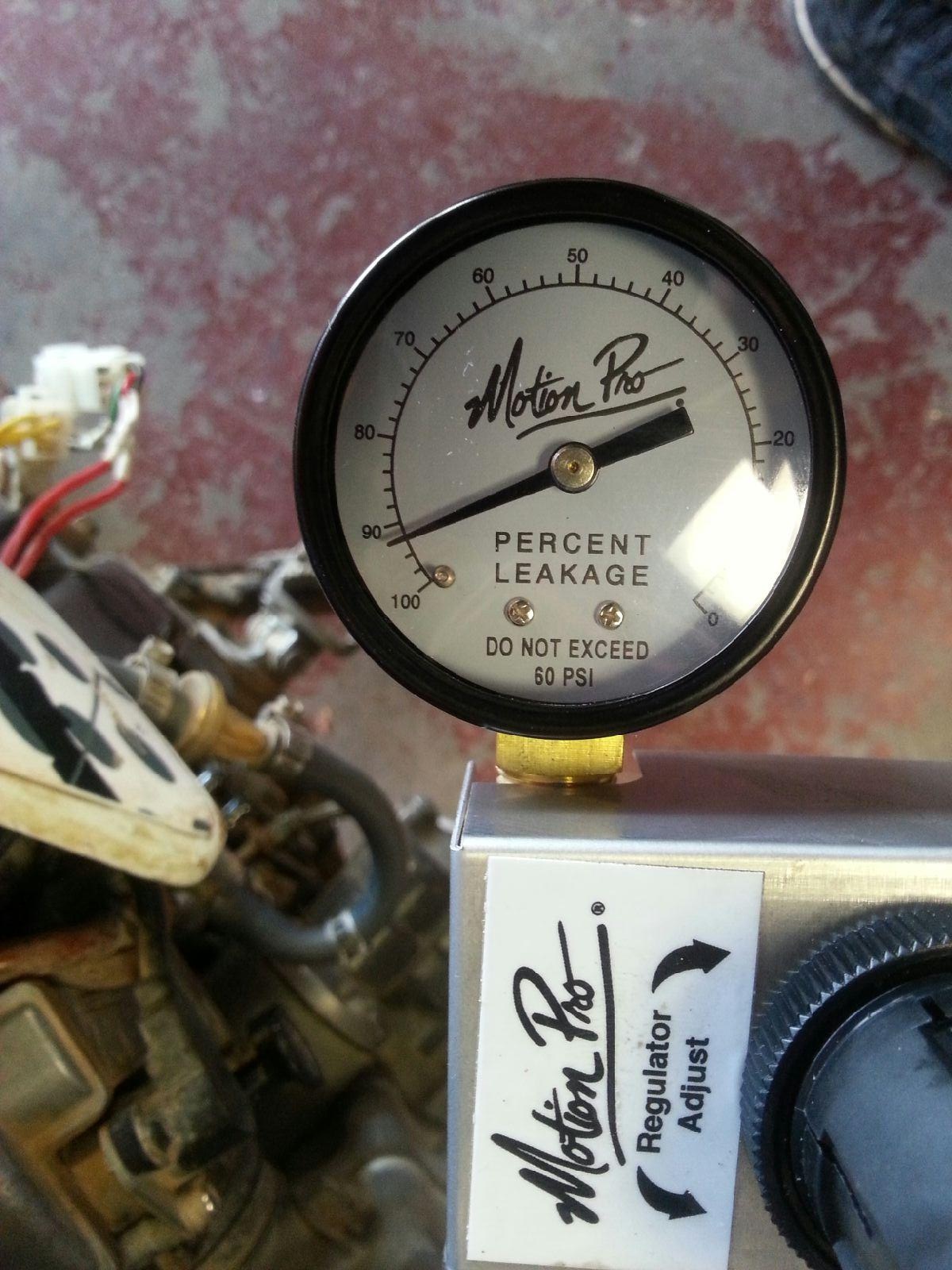

tntmo 971 Posted October 9, 2014 Pretty bad readings from the leak down test, air coming from the crank case. Looks like piston/rings. Share this post Link to post Share on other sites
Vacman 0 Posted October 9, 2014 Polished the cylinder walls from failed air filter? It's been known to happen. Share this post Link to post Share on other sites
PbdBlue 46 Posted October 9, 2014 IMG_6905.jpg Wow! I don't think that's from worn rings. Maybe a broken\stuck ring. Definitiely time to take it apart. Share this post Link to post Share on other sites
paulmbowers 236 Posted October 9, 2014 You guys are so pessimistic. To me, that's an Upgrade Opportunity Gauge. Share this post Link to post Share on other sites
350thumper 337 Posted October 9, 2014 how about giving it a wet test? if you put motor oil into the cylinder(thru the spark plug hole) ...only a little bit, quarter cup......the compression will come back up . if so then its definitly time for the upgrade .... if not then your looking at valves or something in the top end because oil goes downward (gravity)... normally compression comes right back up around 150 with a wet test .unless its a valve issue Share this post Link to post Share on other sites
paulmbowers 236 Posted October 9, 2014 normally compression comes right back up around 150 with a wet test .unless its a valve issue Or something more piston/cylinder catastrophic, like, say, a cracked piston? Go ahead, ask Vacman how he knows... Share this post Link to post Share on other sites
