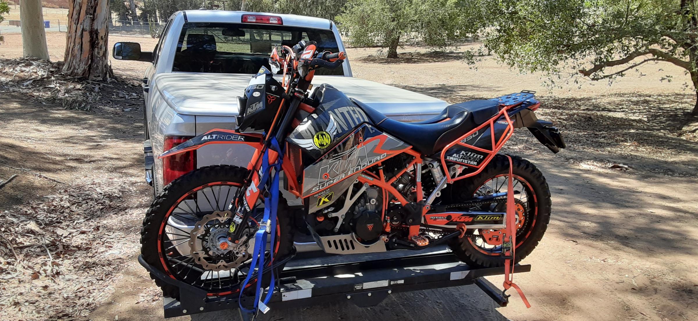

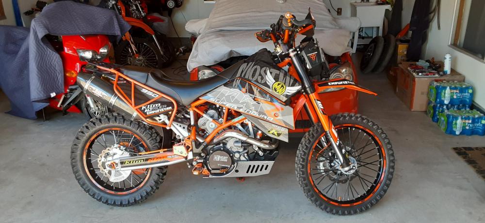

cmbthumper 164 Posted August 13, 2022 As my enjoyments grow for dirt and street riding i often change my mind, sell a bike and get another until i am satisfied. I don't get to ride much due some ongoing medical conditions but when i do, i want nothing but a Sh*t eatin grin on my face, even if it is only for a few hours. I always wanted to try a "Big" KTM so i started my research and hunt about 6mo ago. A few popped up that i would have jumped on but i still had bike for sale. No sale No buy is how i keep my sanity. Then this monster of a bucket list bike showed up and i was right in the middle of a sale of my KTM 525. Figured it would be gone by the time things went through. Contacted the seller and communicated i was very interested but had to have some sales go through first and would totally understand if it sold by the time i called him back. Well, my bike sold, i called the seller and i now own an AMAZING bike with INCREDIBLE history. Some of you will know this bike without question when i say who owned further into my short story. It will likely be unrecognizable now as the previous owner (Wont say his name without his permission) and SDAR member (Don't know his member name) i bought it from updated, upgraded, upgraded some more and poured a lot of long nights and put a ton of care into it before i came along. Check out the Upgrade list i compiled from the For Sale ad and 6" book of receipts and notes. I honestly have no idea the exact dates Crawdaddy purchased it and when he sold it to the Own i bought it from. I love bikes with history but was too excited to remember to ask. Onto the show... Before: Last known pic i could find of Arnie Fry's bike when Crawdaddy purchased it from Christi (Arnie's wife) After: Yeah tell me about it. I am certainly a lucky man. I have 10% of the skills needed for this bike but 1000% drive to tame this beast as best i can when i can. When i get scared i'll hop on my 07' KTM 450 EXC for a little back to reality. Currently in Surgery for coolant leaks on the Samco hoses. Took me 45min to finger out how to remove the tank (Don't have a manual yet) but now it is an easy fix. Look forward to it cooling down a little to test ride it. 2 Share this post Link to post Share on other sites
tntmo 971 Posted August 13, 2022 It’s too pretty to use it the way it should be used! Nice machine, A always takes care of his bikes and you reaped the benefits of that. Share this post Link to post Share on other sites

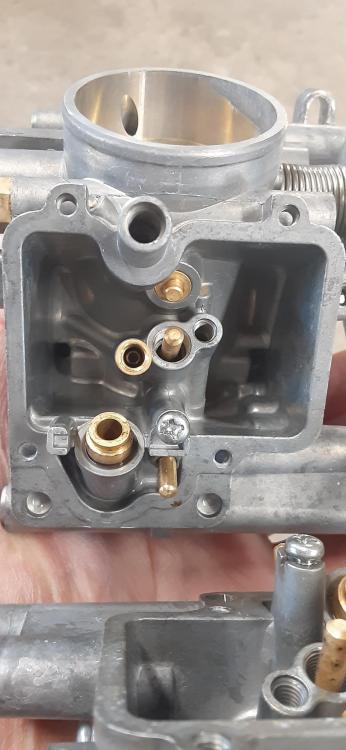

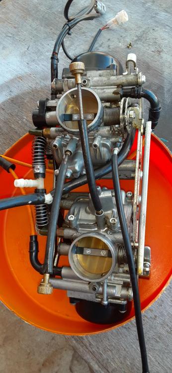

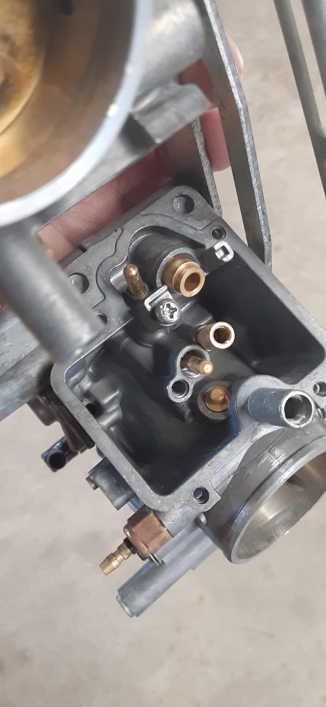

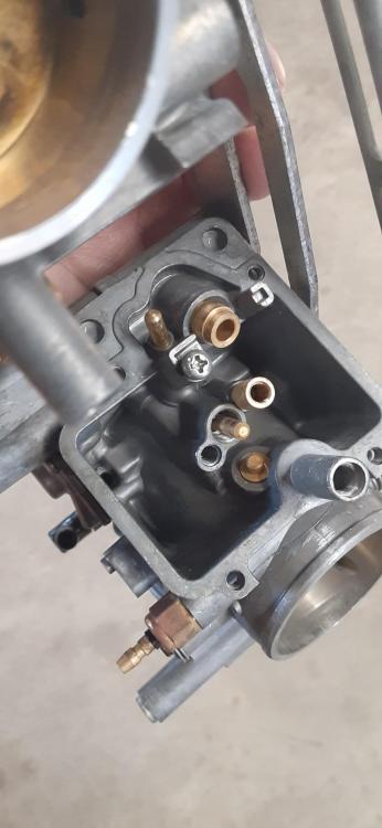

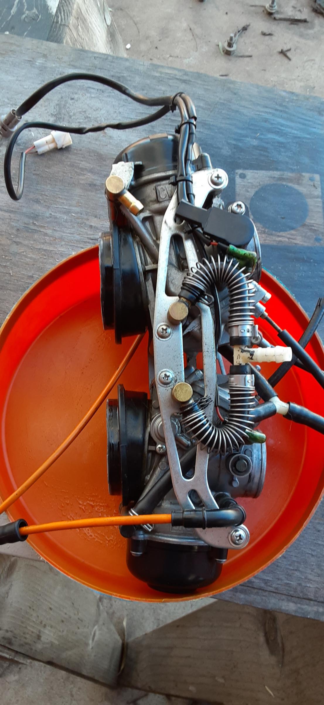

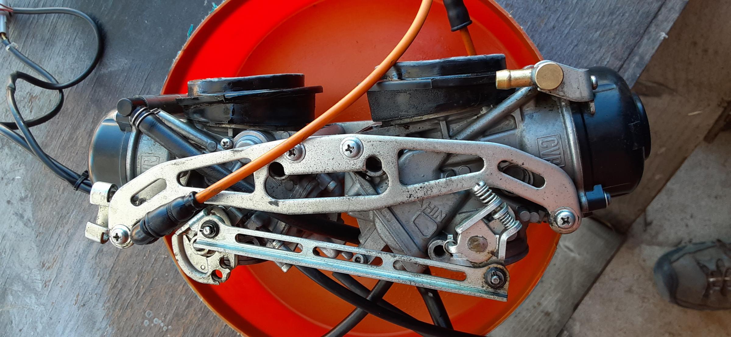

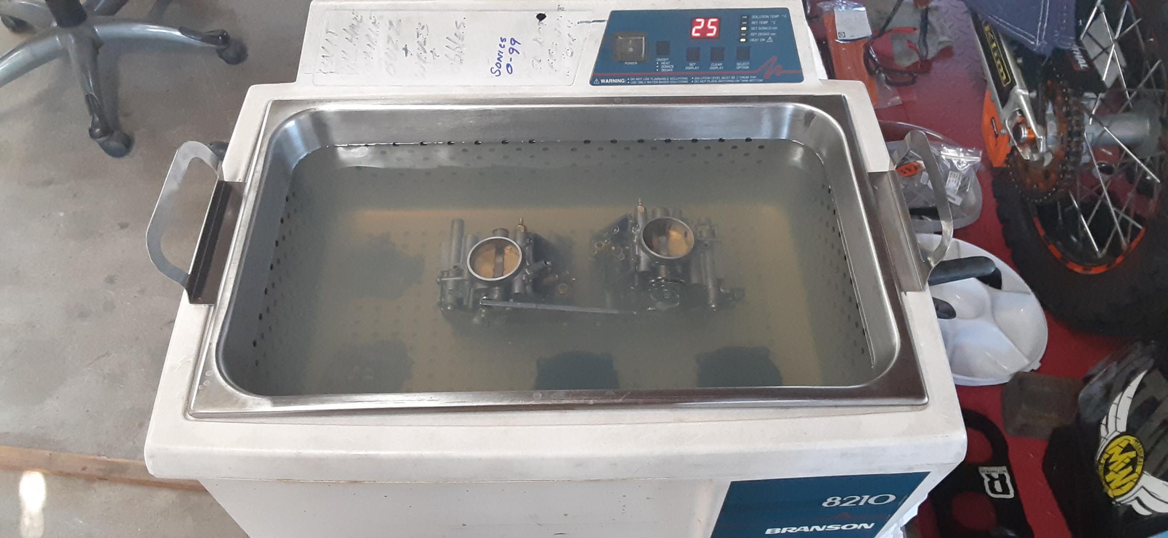

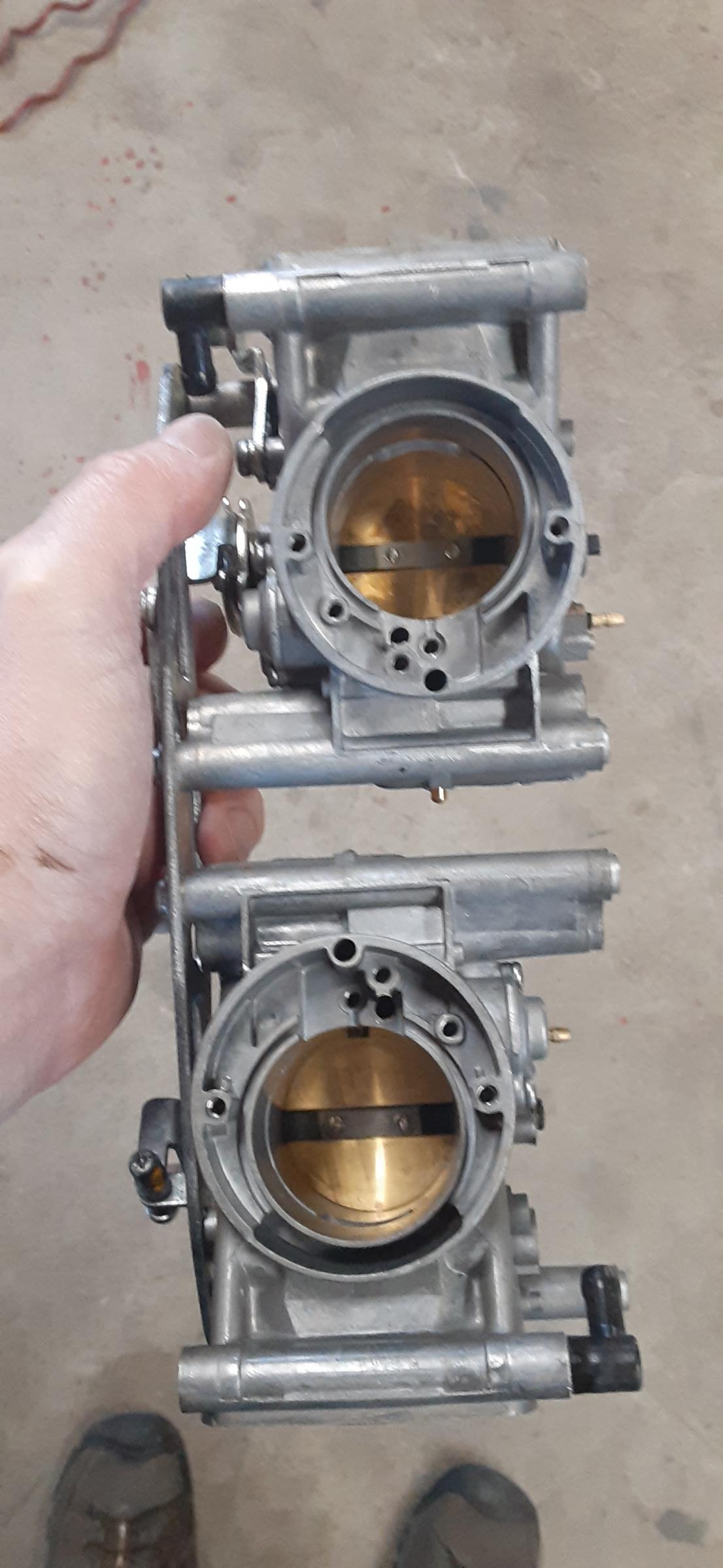

cmbthumper 164 Posted November 12, 2022 Finally getting around to cleaning the carbs. Se pics just in case anyone was curious what one of those carb things look like. I can say with 100% confidence that i will only be doing this once and will do my best to get it right. If not, she will go up for sale to an owner who can keep her breathing and eating right. 1 Share this post Link to post Share on other sites

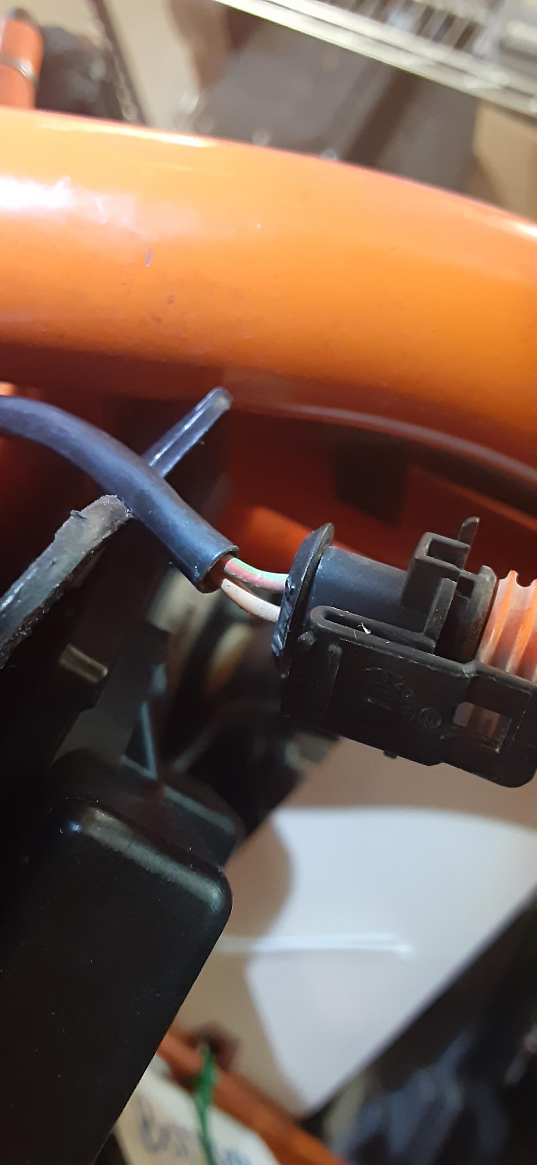

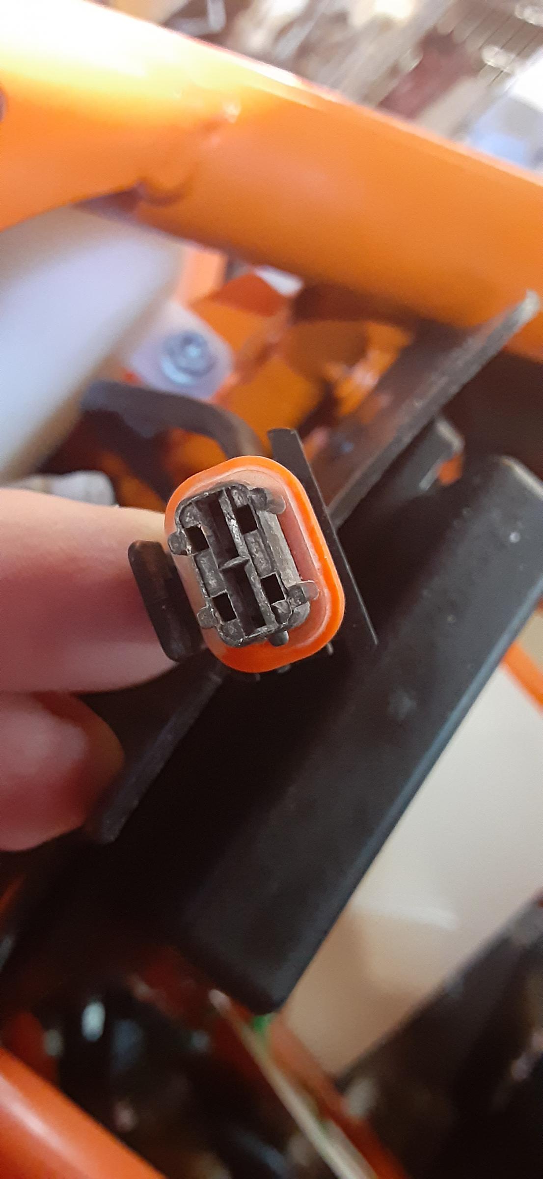

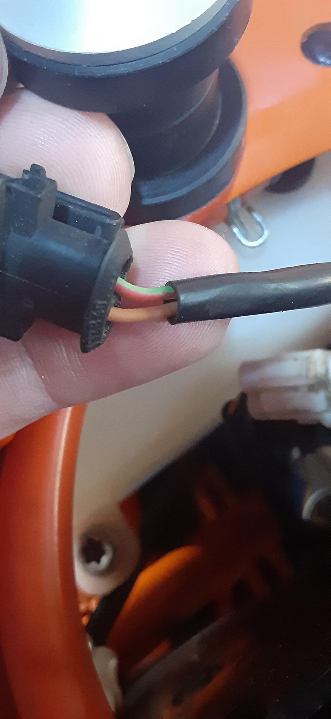

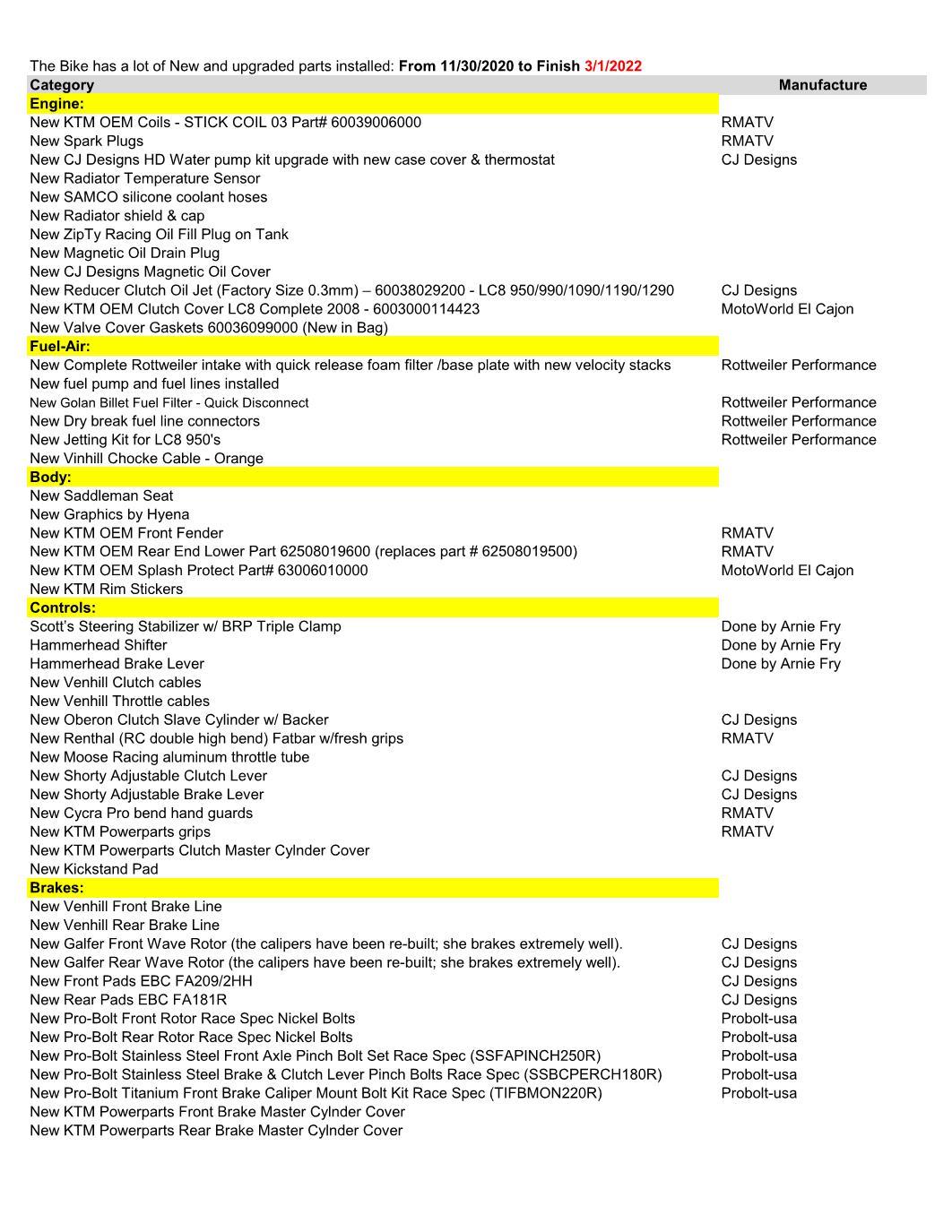

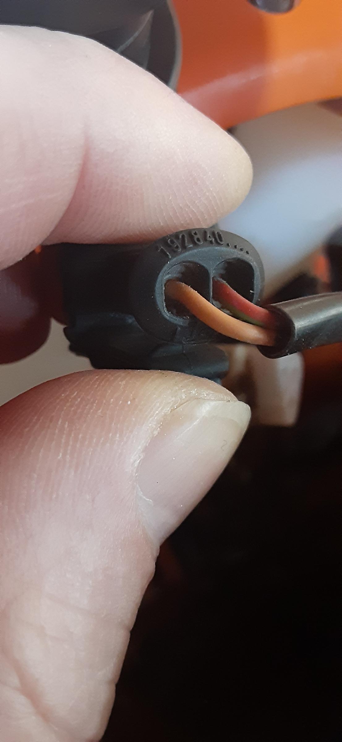

cmbthumper 164 Posted November 18, 2022 Since there were and possibly still some 950SE owners on here i figured i would ask for some help. Remember total 950SE noob owner here. I pulled my carbs to clean them, check jetting from PO etc etc. What i need help with is identifying this connector and what it was for. While pulling the TPS and Carb heater connections i needed to get some slack in order to do so. The slack was buried just under the coolant tank and this connector came with the slack. By the looks of it and the dirt on the weather tight portion it hasn't been plugged in for quit a while. I can guarantee i didn't unplug it. I have looked at the wiring diagram and the only place the Solid Orange and Green w/Red tracer shows up is for the EPC1 and EPC2 but those are plugged in and different connectors. It is not aftermarket add on as it is seems to be in the same harness as where the TPS/Heater comes from before diving into the main harness. I can list my modifications surrounding this area and that might help ID this thing. I'll keep researching and thanks a 1000% if you know what this is for. Bike Mods in this area the PO did before i bought it Engine: New KTM OEM Coils - STICK COIL 03 Part# 60039006000 New Spark Plugs New CJ Designs HD Water pump kit upgrade with new case cover & thermostat New Radiator Temperature Sensor New SAMCO silicone coolant hoses New Radiator shield & cap New ZipTy Racing Oil Fill Plug on Tank New Magnetic Oil Drain Plug New CJ Designs Magnetic Oil Cover New Reducer Clutch Oil Jet (Factory Size 0.3mm) – 60038029200 - LC8 950/990/1090/1190/1290 New KTM OEM Clutch Cover LC8 Complete 2008 - 6003000114423 New Valve Cover Gaskets 60036099000 (New in Bag) Fuel-Air: Complete Rottweiler intake with quick release foam filter /base plate New Rottweiler Pre Cut Velocity Stacks New fuel pump and fuel lines installed New Golan Billet Fuel Filter - Quick Disconnect New Dry break fuel line connectors Factory Pro Jetting Kit for LC8 950's New Vinhill Choke Cable - Orange Share this post Link to post Share on other sites
cmbthumper 164 Posted November 18, 2022 From ADVrider and makes total sense now. I'll bag and tag it "Boatman said: It's a plug from one of the EPC valves that was removed when it was desmogged." 1 Share this post Link to post Share on other sites
tntmo 971 Posted November 18, 2022 That’s what I figured, only worked on 3-4 of those so could not remember. Get her humming again and enjoy that machine! Share this post Link to post Share on other sites

cmbthumper 164 Posted November 30, 2022 1 hour ago, DSM8 said: So whats the status on this project? Appreciate you asking. Carbs, jets etc got sonic cleaned for 1hr on each side last weekend. Need to set/check the floats are at 4mm, put back on the TPS (Took off for cleaning) and adjust if needed. Throw them back in the bike, double check everything and hit the start button with fingers crossed i didn't mess anything up. Then Sync the carbs with my Carb Tune and throw it the rest back together. I am slow and this is very intimidating for me so i am taking my time. 4 Share this post Link to post Share on other sites
