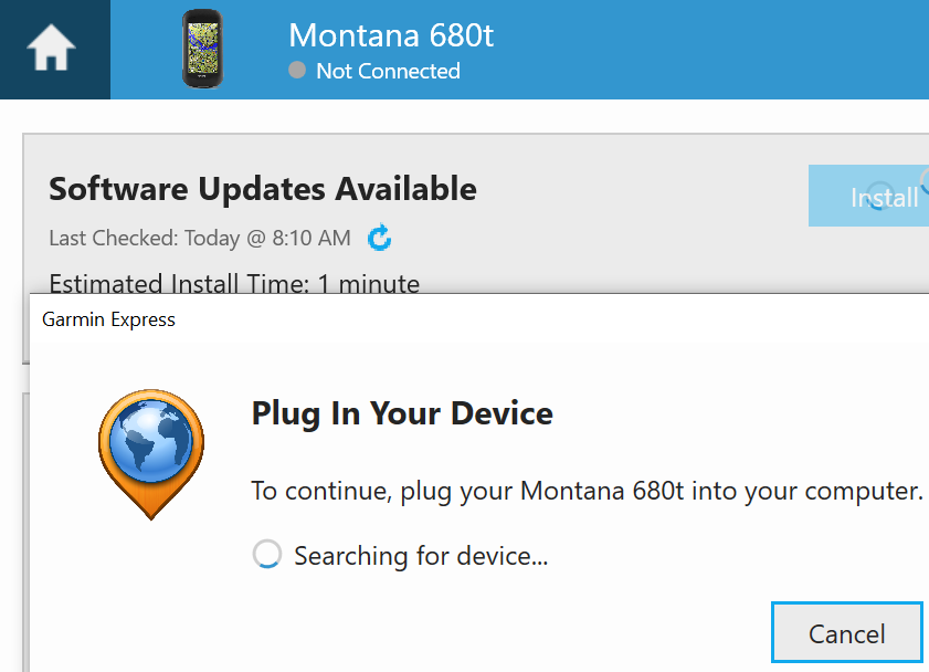

thecerver 6 Posted April 15, 2021 Unfortunately, I can't transfer anything to the device because it's not being recognized by the PC as a device. I have updated the software before, but I can't use it now. Neither BaseCamp or GarminExpress can find the device when I have it connected. This is basically what I get: Share this post Link to post Share on other sites

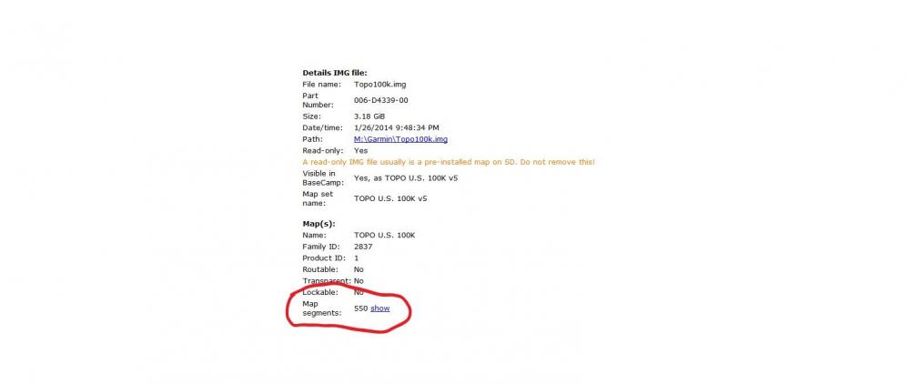

PbdBlue 46 Posted August 13, 2021 Hmmm...... it sounds like one of your map files may be corrupted. If the maps are loaded into the main memory there's probably no way to delete them since it won't connect. I've been keeping all of my map files on the sd card so I can just remove it if something happens to them. Then create a new sd card image offline. A coupe of possible causes come to mind. One is disconnecting the GPS usb cable without unmounting the device in windows first. The other is too many map segments are loaded. Not only is there a limit on memory but more importantly there's a limit on the number of map segments stored. For instance City Navigator contains ~190 map segments while Topo 100k has ~550. The Topo24K series maps contain many more and you can easily exceed the max which is around 4000 map segments. Once you do weird thing happen. Most often it starts truncating the maps but I suspect it may also cause loading issues. In your case not sure what happened or what can be done. Did you ever try completely removing the SD card? It doesn't need one installed to boot up. Share this post Link to post Share on other sites
