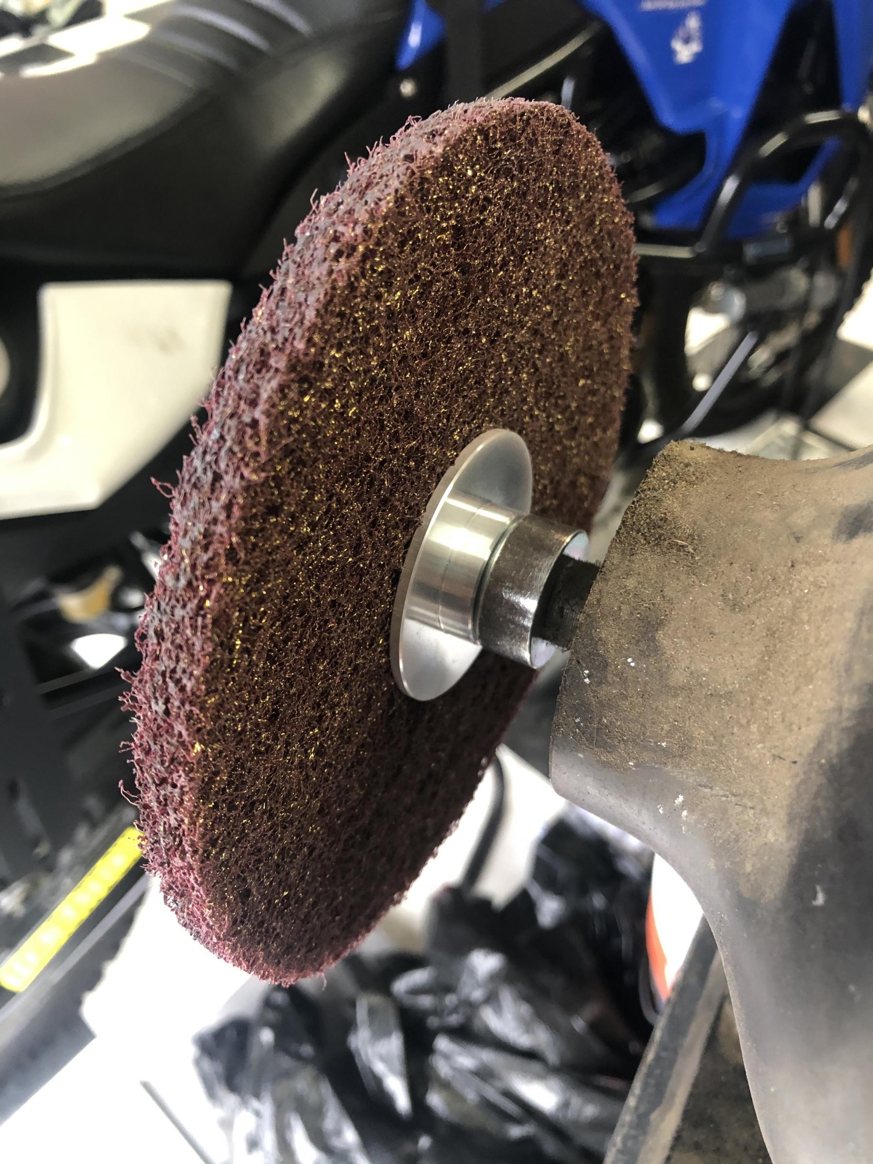

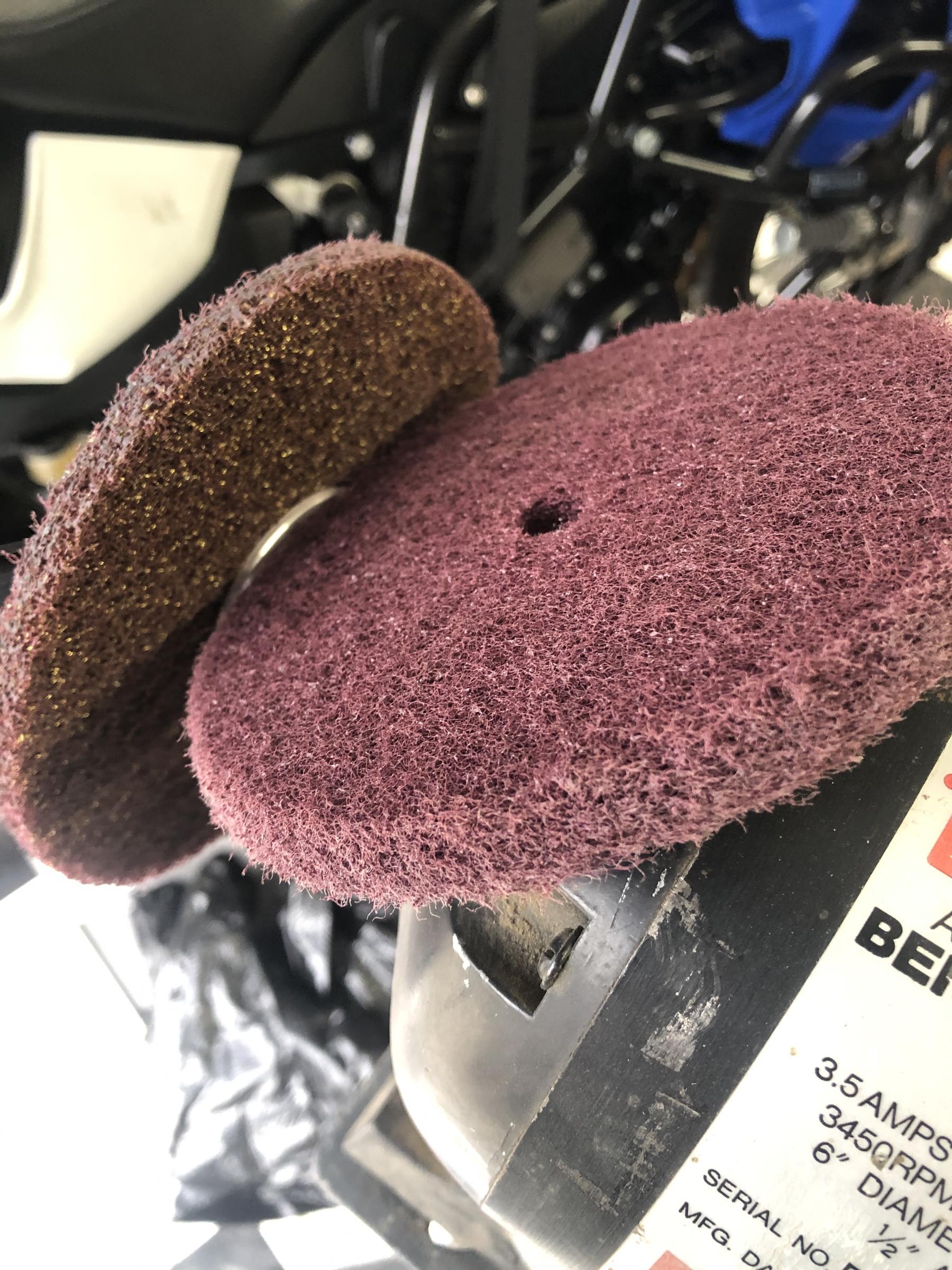

Pokey151 303 Posted February 20, 2021 Wd 40 and a green scotchbrite. Works magic on aluminum If it’s really bad people use mag wheel cleaner here is a thread on it. https://thumpertalk.com/forums/topic/1355446-eagle-one-mag-wheel-cleaner/ all my MX bikes I have owned, I use the WD40 with scotchbrite Just spray in on the aluminum and scotchbrite and scrub It literally takes a few seconds to see results It will leave a gray wet film, just wipe it off or spray it down and you are done Share this post Link to post Share on other sites
