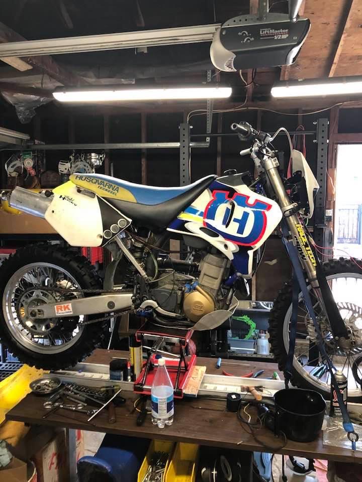

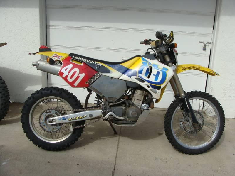

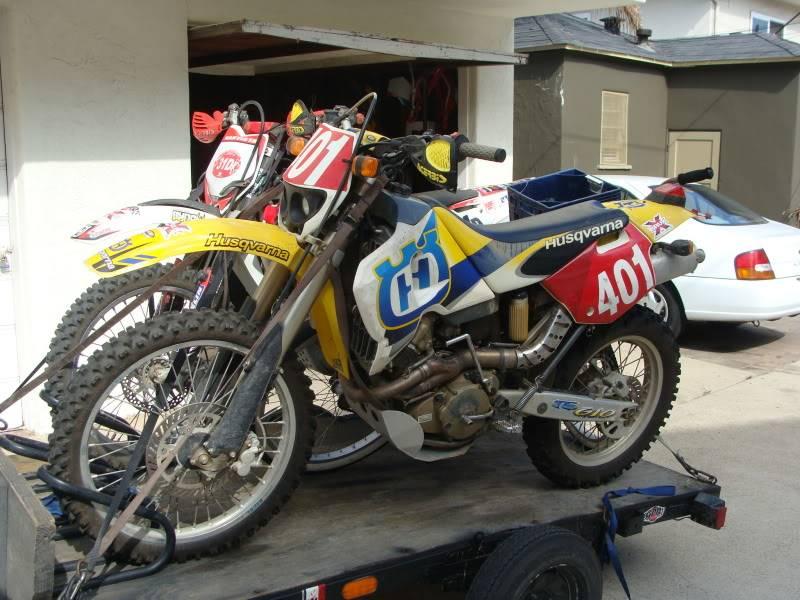

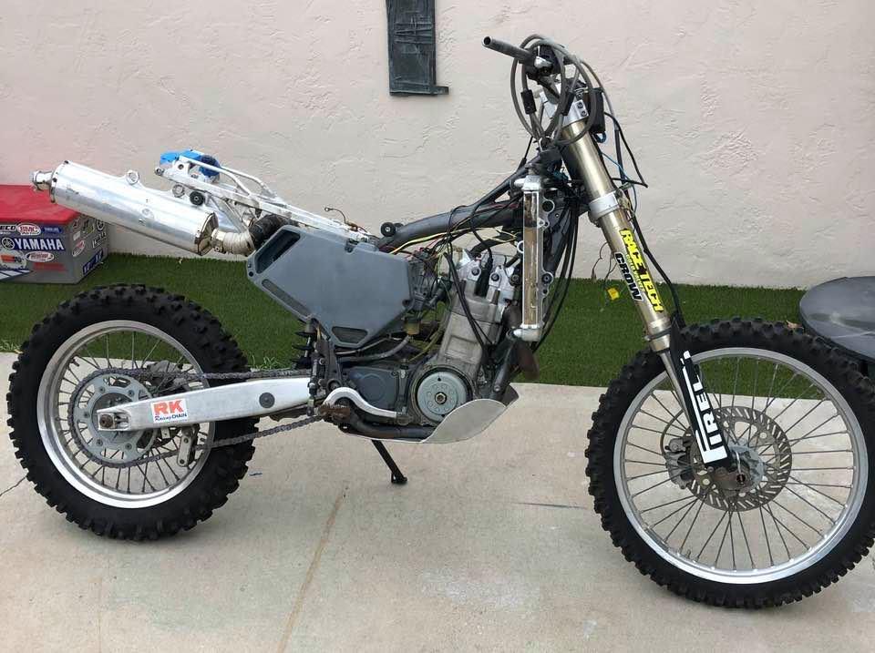

robertaccio 436 Posted July 28, 2020 10 years ago I owned this plated TE610 and she looked like this. Kind of an Anders Eriksson theme world enduro look. Share this post Link to post Share on other sites

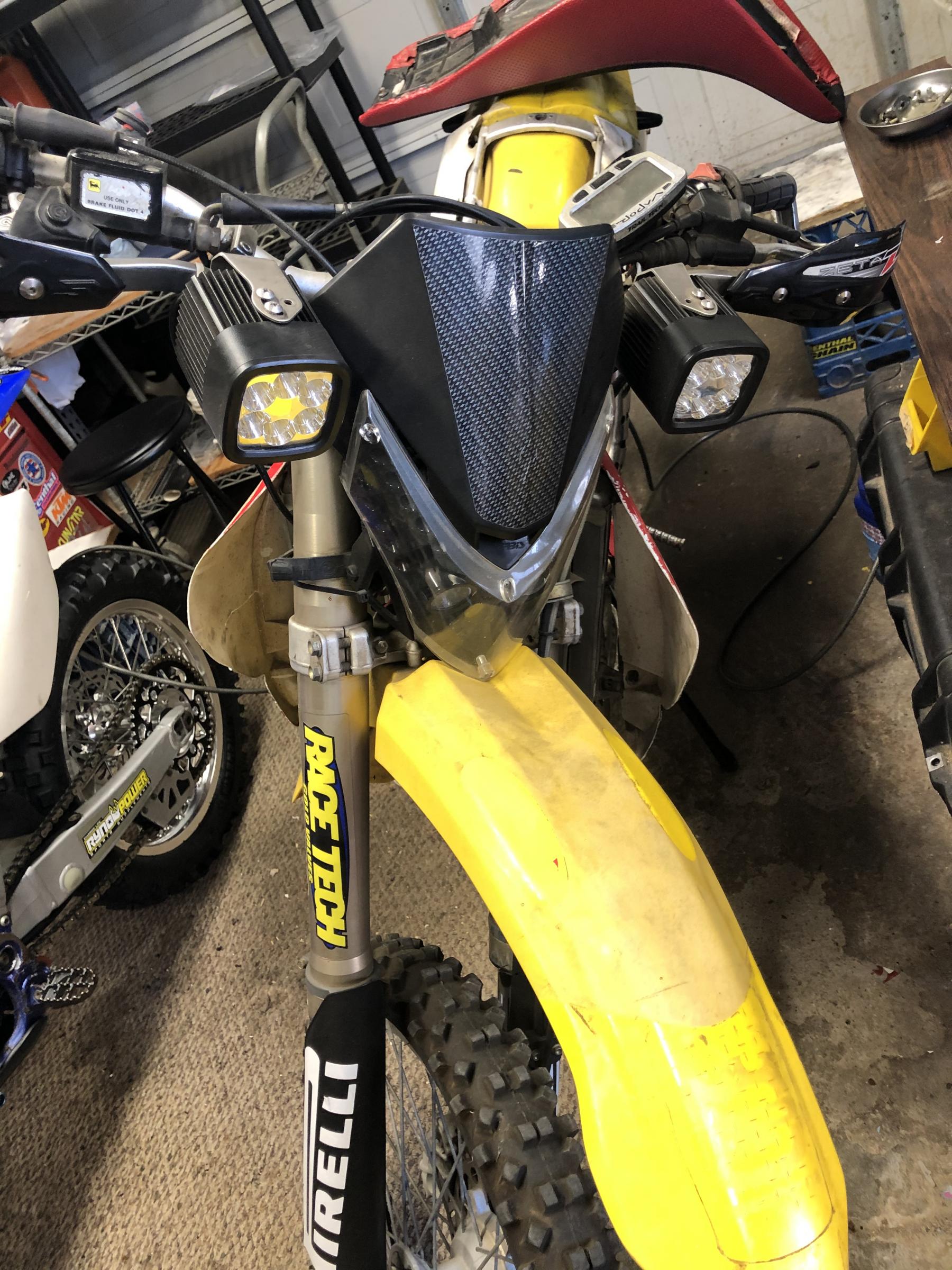

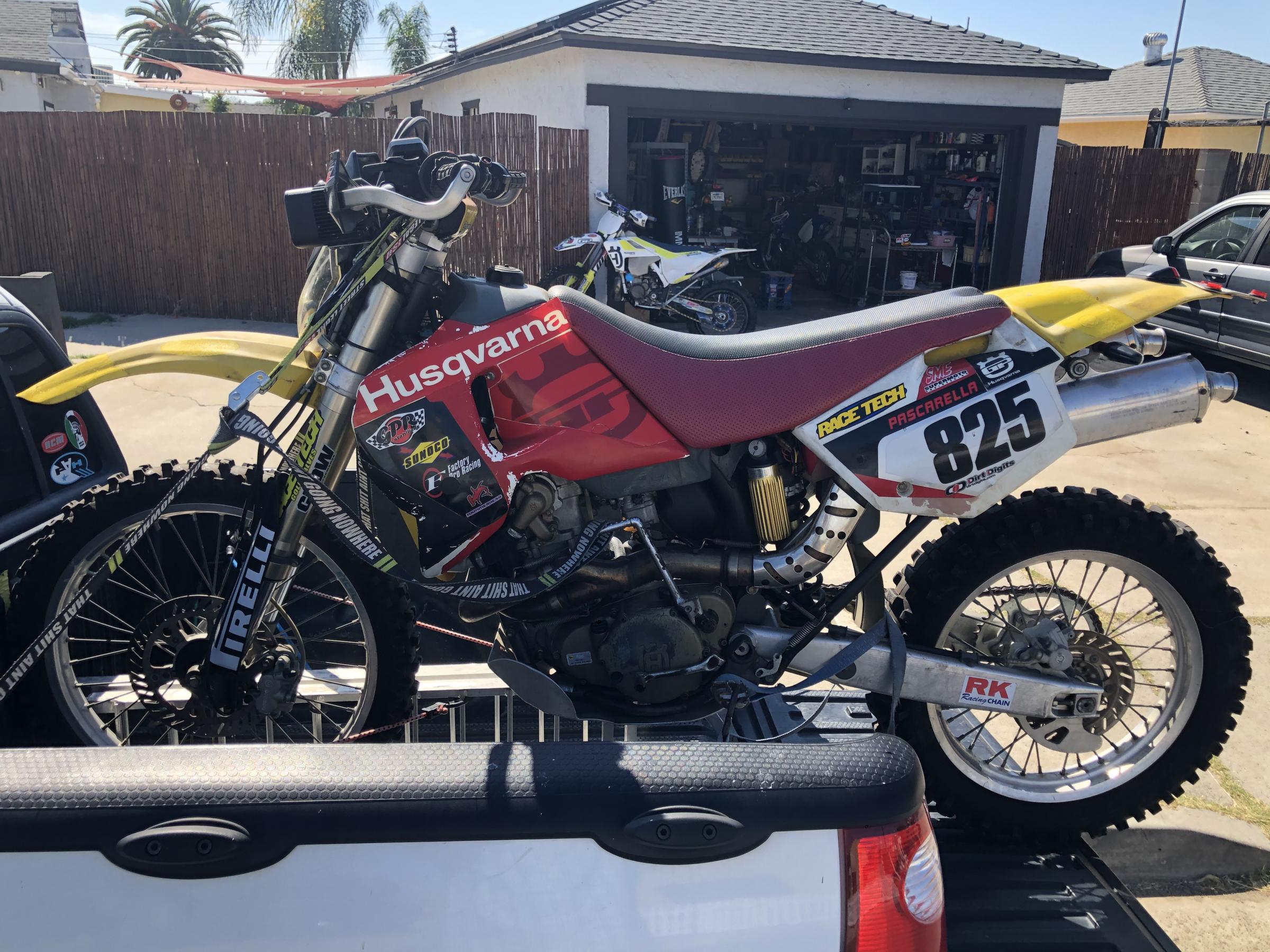

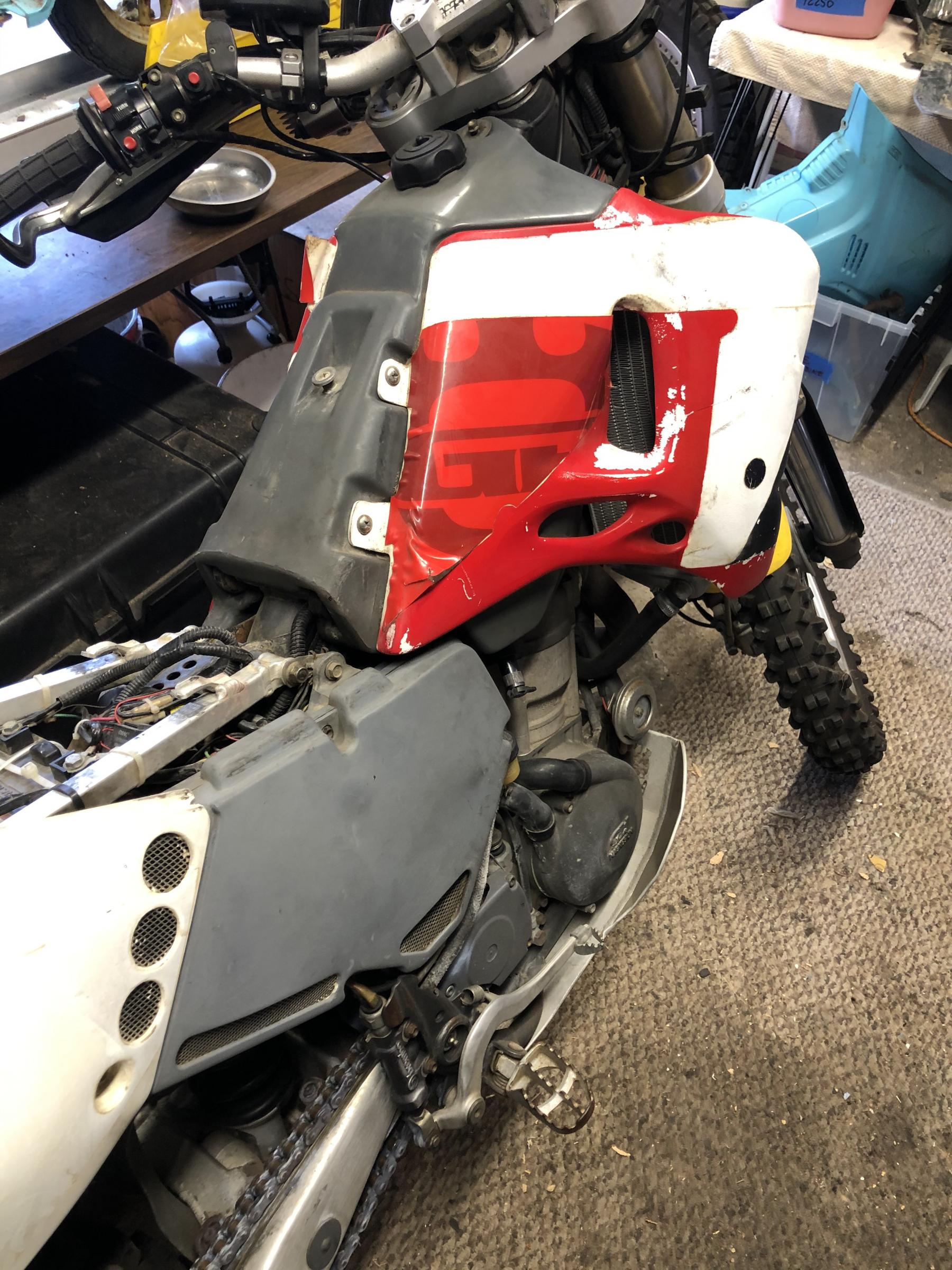

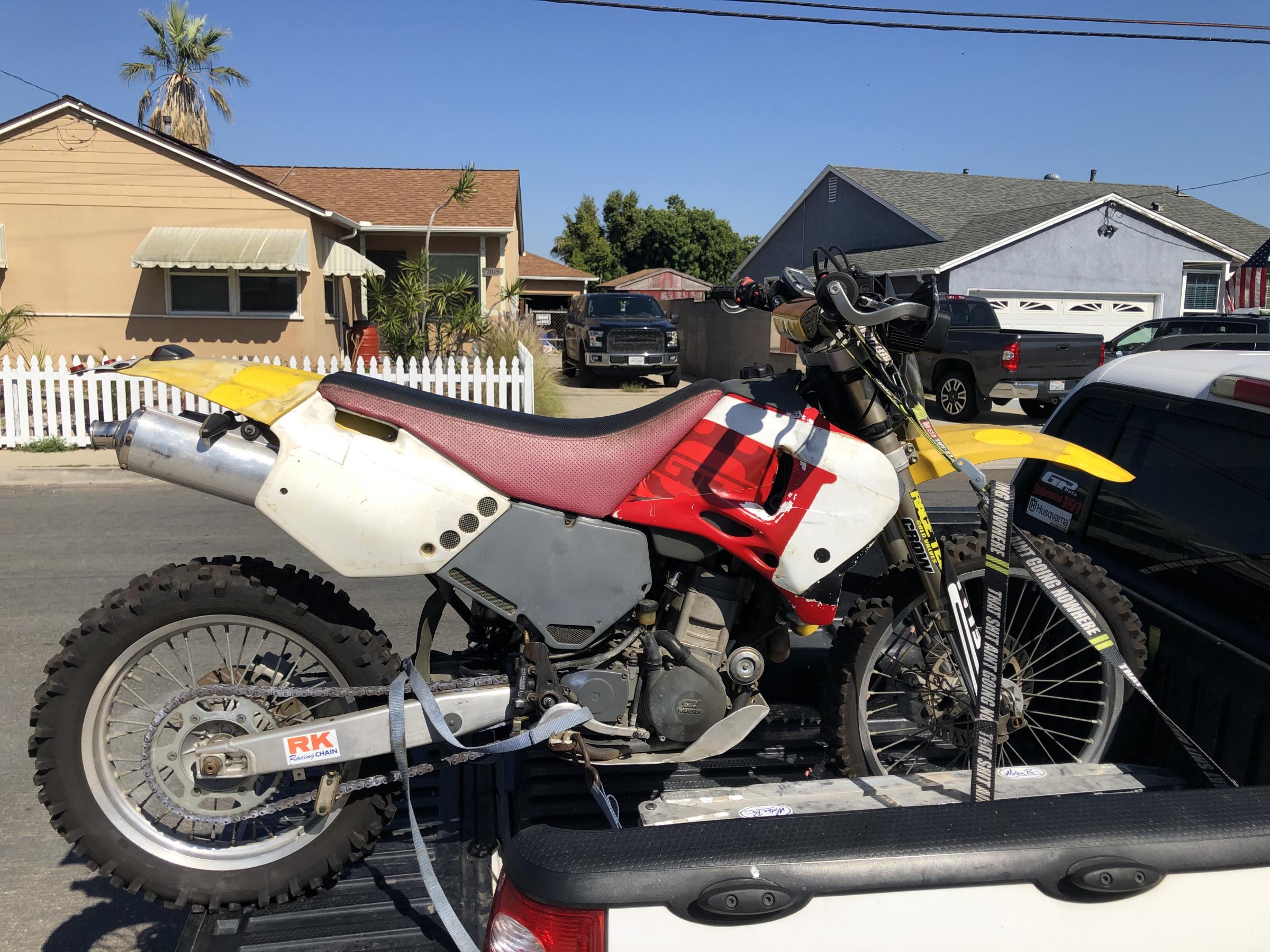

robertaccio 436 Posted July 28, 2020 This is how she came back to me. 1 Share this post Link to post Share on other sites
Dress4Less 162 Posted July 28, 2020 Looks like she could use a little TLC... Share this post Link to post Share on other sites

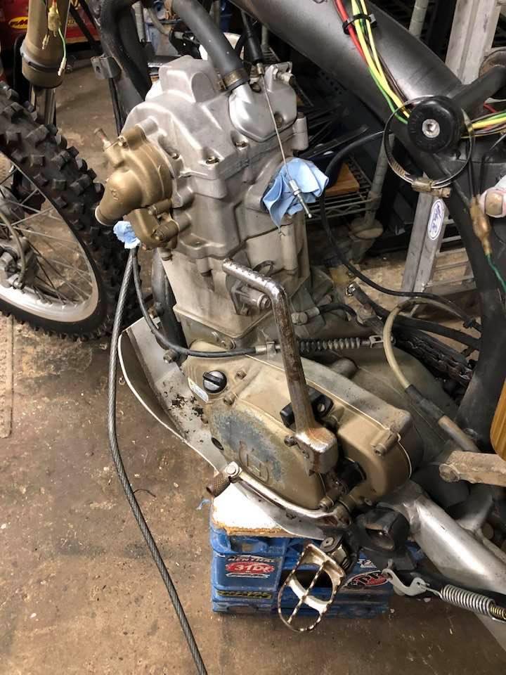

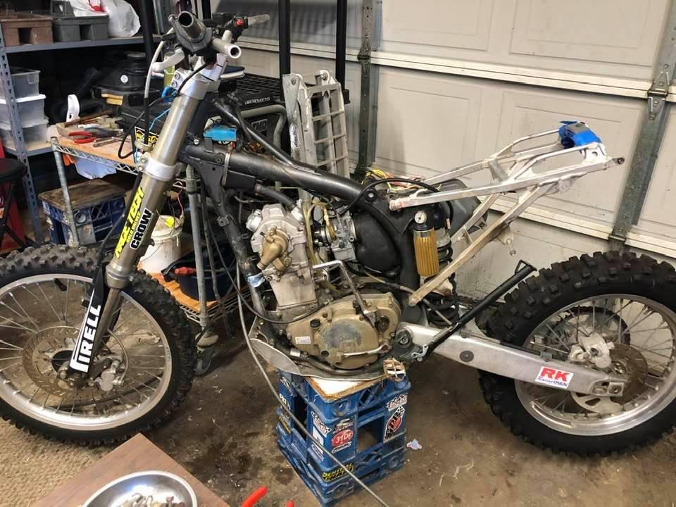

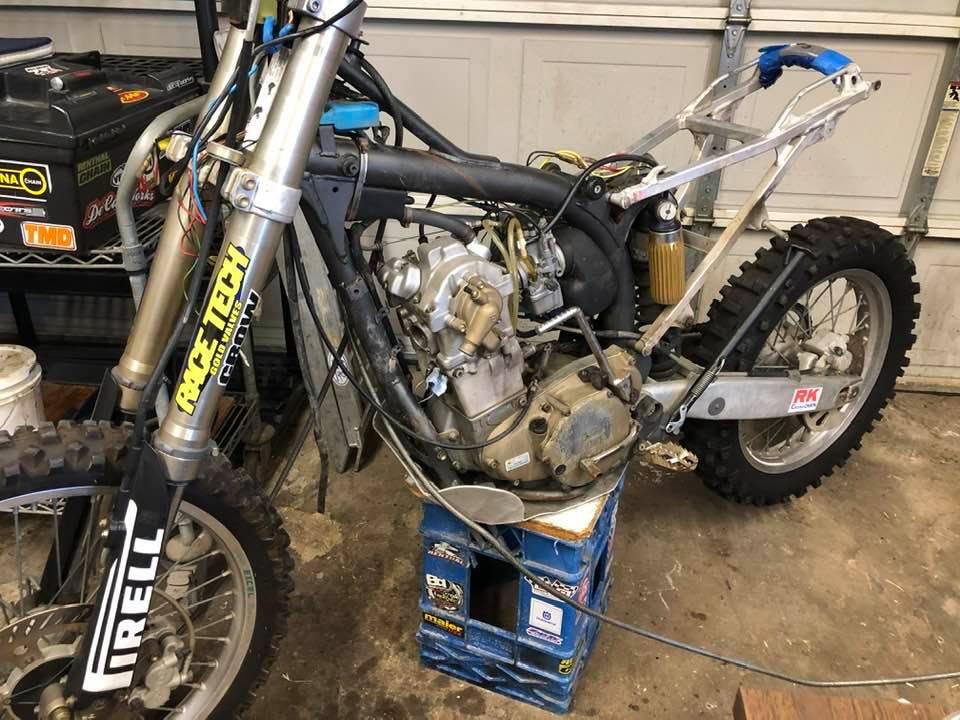

robertaccio 436 Posted July 28, 2020 4 hours ago, Dress4Less said: Looks like she could use a little TLC... the best thing is that the tires are still the same.....they are like hardened steel.Lots to do. Next pic will be as is now rolling chassis with engine in. Will do a nice pressure wash then drain oil clean filters and adjust valves. Then begin to sort out the wiring harness to create a full FIM enduro spec layout (plated of course). And I found these simple cool sorry but made in china battery powered clamp on bars horns (120dB!!). Tested on my 300 for durability. Share this post Link to post Share on other sites

robertaccio 436 Posted July 30, 2020 16 hours ago, Dress4Less said: On 7/28/2020 at 4:36 PM, robertaccio said: the best thing is that the tires are still the same.....they are like hardened steel.Lots to do. Next pic will be as is now rolling chassis with engine in. Will do a nice pressure wash then drain oil clean filters and adjust valves. Then begin to sort out the wiring harness to create a full FIM enduro spec layout (plated of course). And I found these simple cool sorry but made in china battery powered clamp on bars horns (120dB!!). Tested on my 300 for durability. Heres that horn, super light low mass. I put it on my TX300 and rode around and it was still on the bars when I came back!! So it passed the dirt test, I will get another one for the 610 now. I like horns on my dirtbike they are very effective when catching up to racers/riders to let them know you are there, and for some ingrained reason folks tend to move over when they hear a horn on the trail. Share this post Link to post Share on other sites

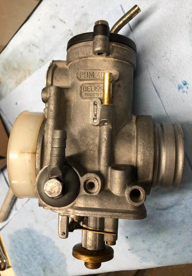

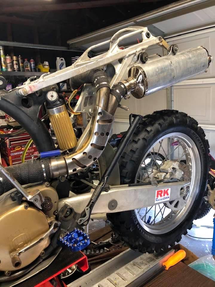

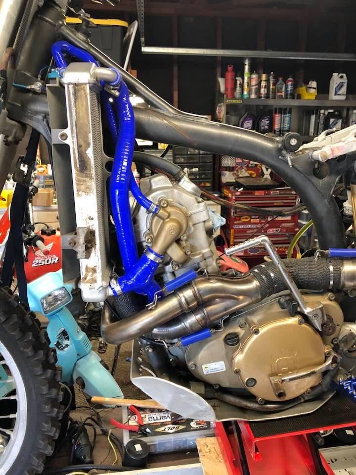

robertaccio 436 Posted August 18, 2020 progress, is moving forward. Those odd graphics are already peeled waiting for a set of my OEM 1998 TC610 graphics, I also have a set of YEL Y2K shrouds for another set of clothes for the old gal. If anyone know the color code or a good rattle can (duplicolor etc.)for the gold engine paint let me know. Carbby is done and ready for reinstall. going a little less period and into bling status with my new set of coolant hoses Silicone BLU. Share this post Link to post Share on other sites

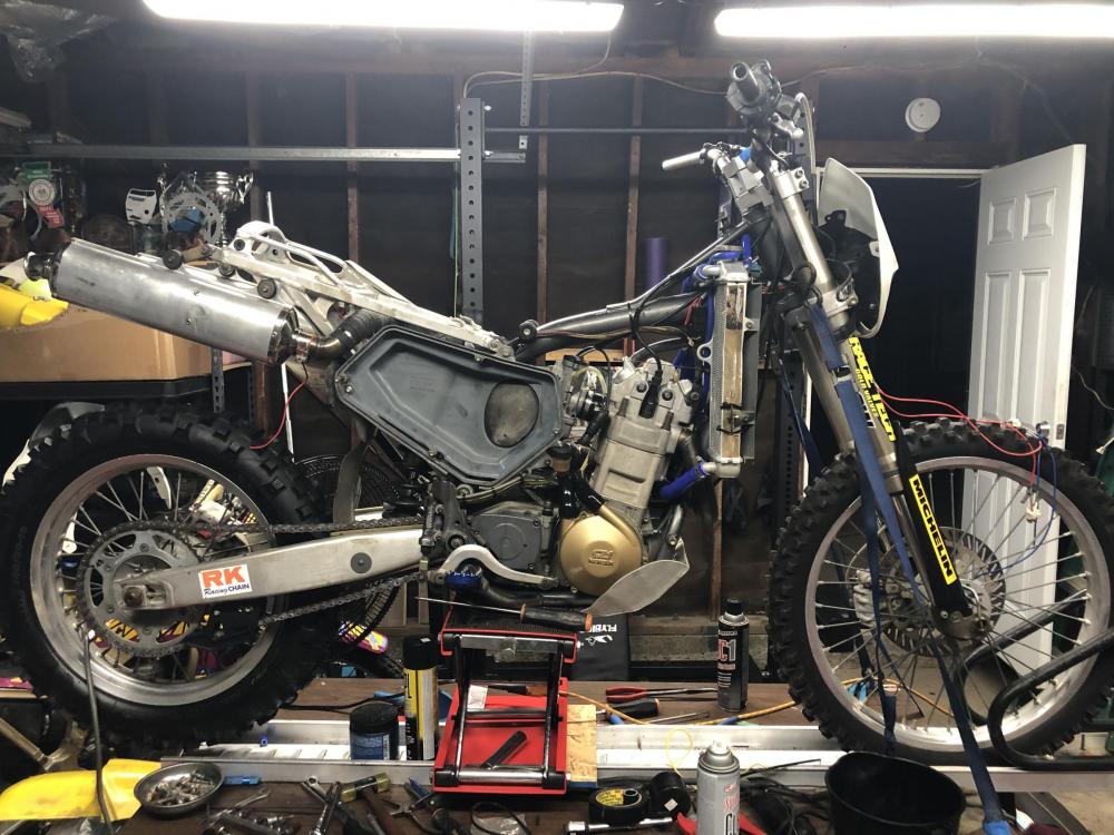

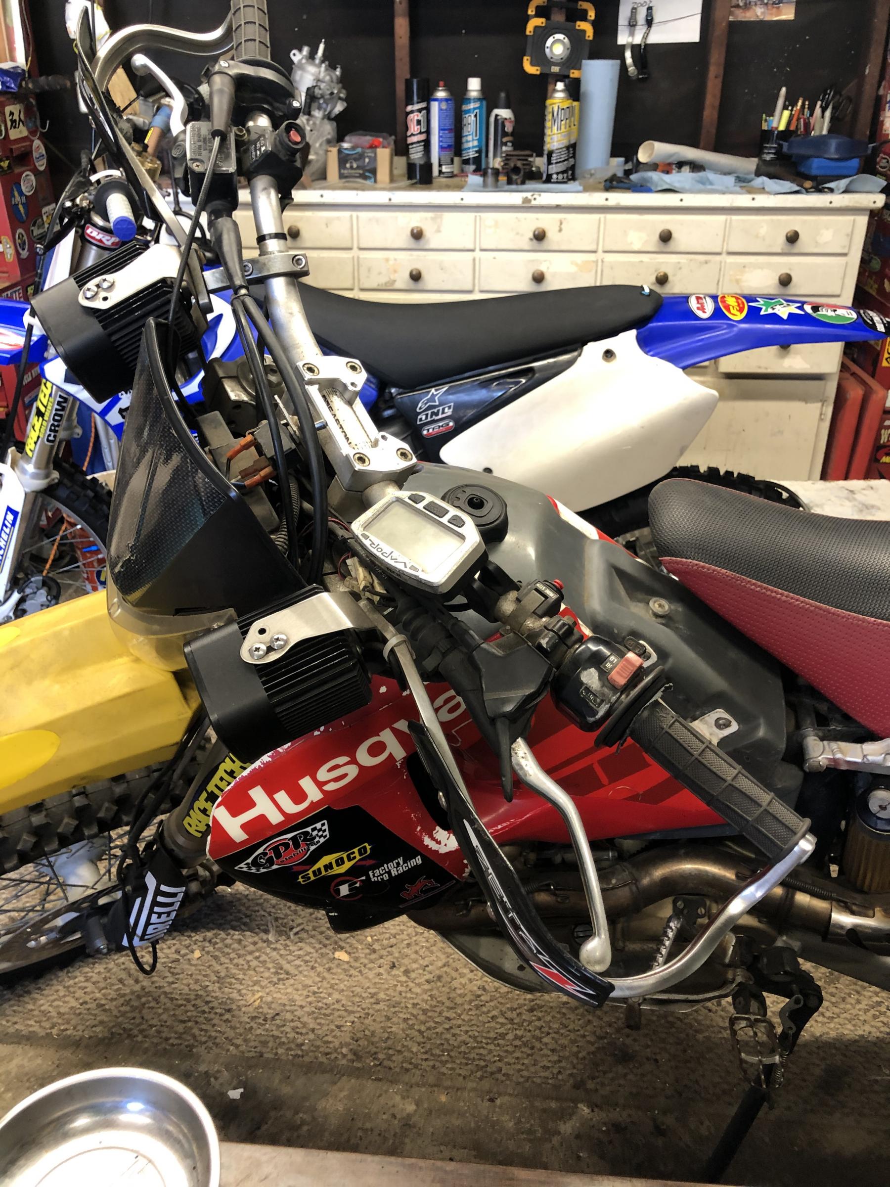

robertaccio 436 Posted August 18, 2020 A little out of order these are in process before fully stripping the chassis 1 Share this post Link to post Share on other sites

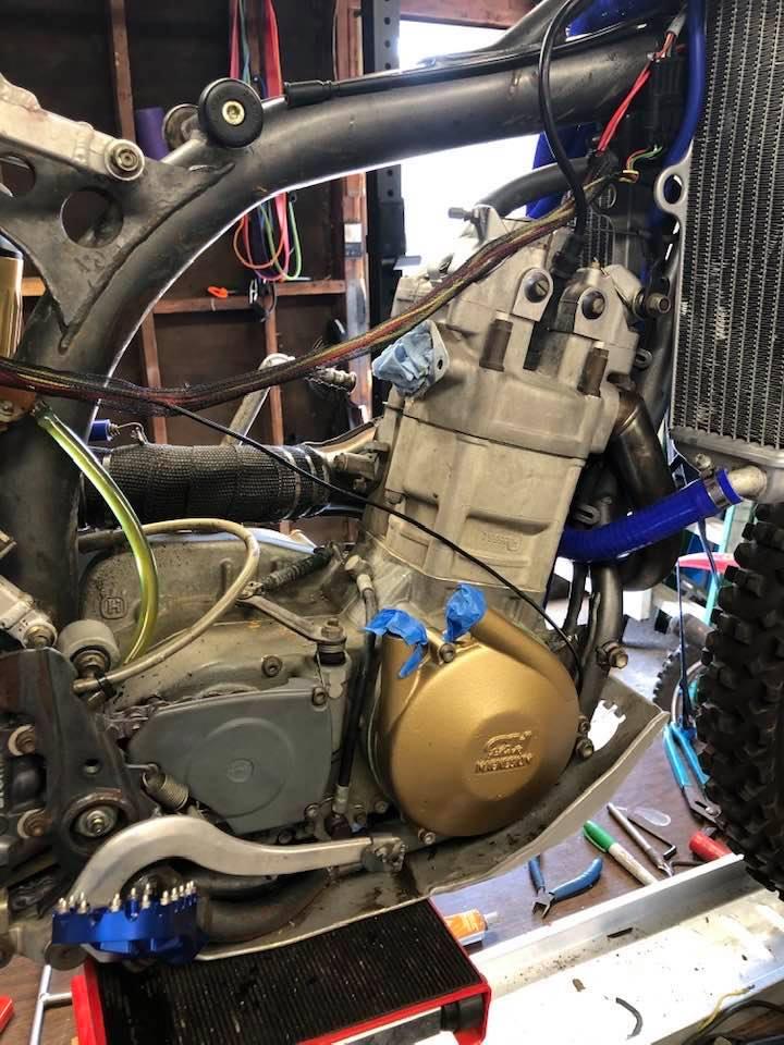

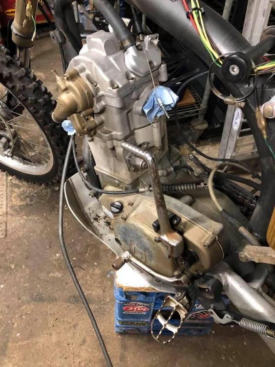

robertaccio 436 Posted August 28, 2020 progress is going well, valve clearance is now at OEM spec. happily they were not tight, both sides were on the loose side (noisy side). basically is is now in fix up the wiring mode and final assembly. Share this post Link to post Share on other sites

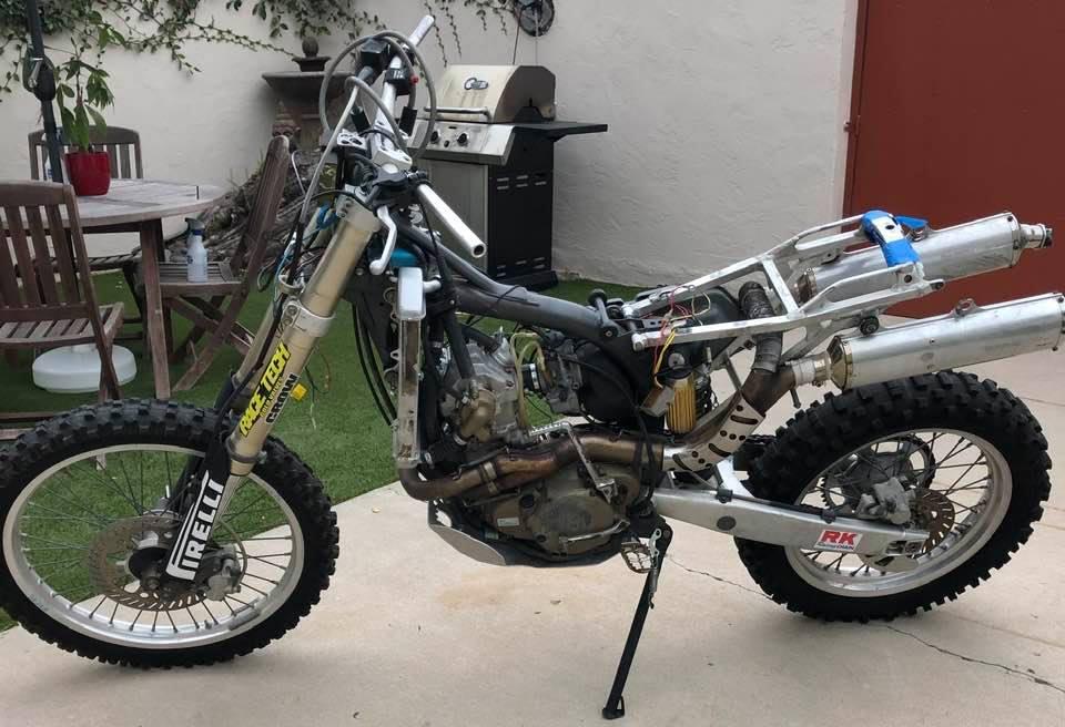

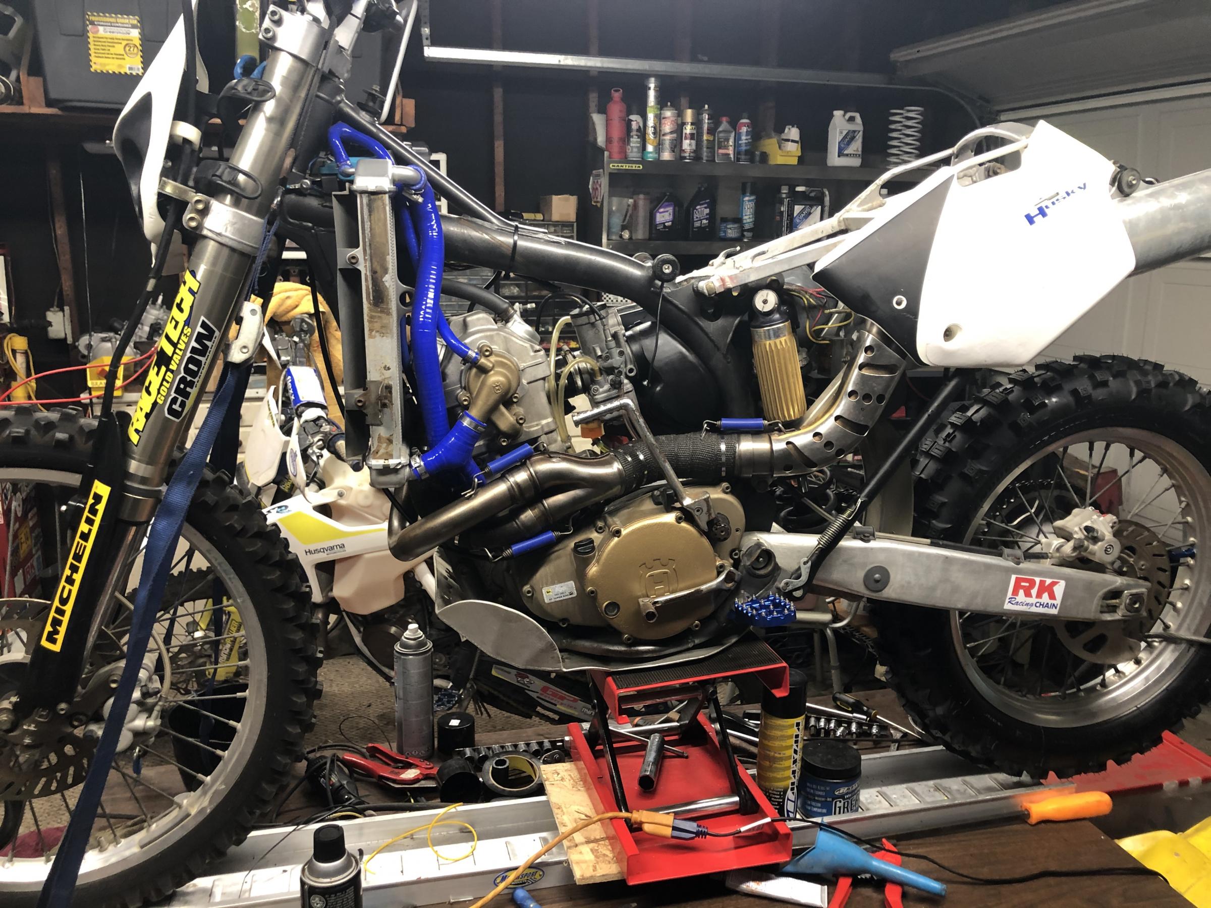

robertaccio 436 Posted October 1, 2020 Lots of progress. Rear wheel set done, packed in some grease in the bearings added Michelin Enduro Medium 140/80-18 with M02 Rally Mousse with 1.5 tubes of lube. New carbby manifold, carb intalled fit check airbox, ignition vend hoses cut and installed, carb vent hoses installed, wide alloy foot pegs installed, full OEM dual exhaust installed, with option for single side TC muffler or preferred S/A type single enduro muffler for significant weight savings. wire harness close to complete with expando sleeve installed, cooling system is done will have bullet proof Evans Powersports fluid. Air filter is Twinair, all products are Maxima Oils etc. Front tire is on the shelf Michelin Enduro Medium with M15 Mousse, Suspension by Crow Performance (Race Tech). Skid Plate alloy type (Brand?) RBF660 brake fluid with EBC Red Carbon X rear pads, front will be OEM type sintered. Lights will be Head and Tail FIM style on off switched set up. Horn is battery type multi sound type (see above) 1 Share this post Link to post Share on other sites

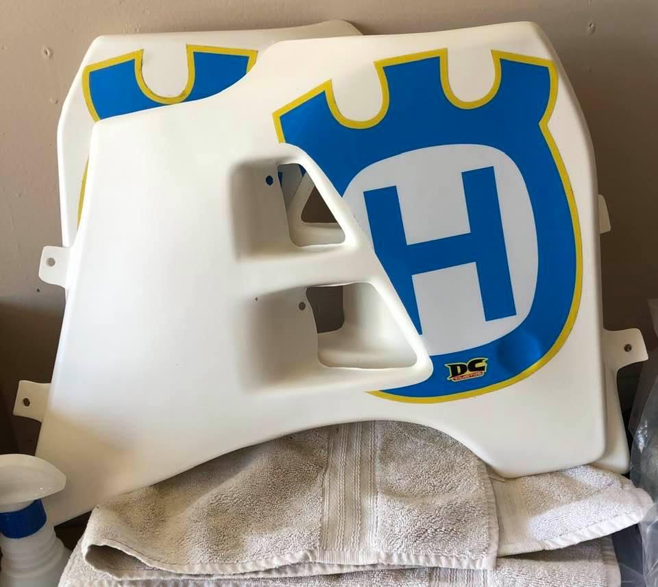

robertaccio 436 Posted October 5, 2020 Also due to a few hurdles I am going for the all WHT Cemoto Plastica Italia plastic set up, so Front and Rear fenders will be WHT along with the OEM WHT shrouds and side panels. So she will have a more modern/retro (80s) color scheme. Man I sure will have alot extra stuff boxed for this bike!!! Share this post Link to post Share on other sites

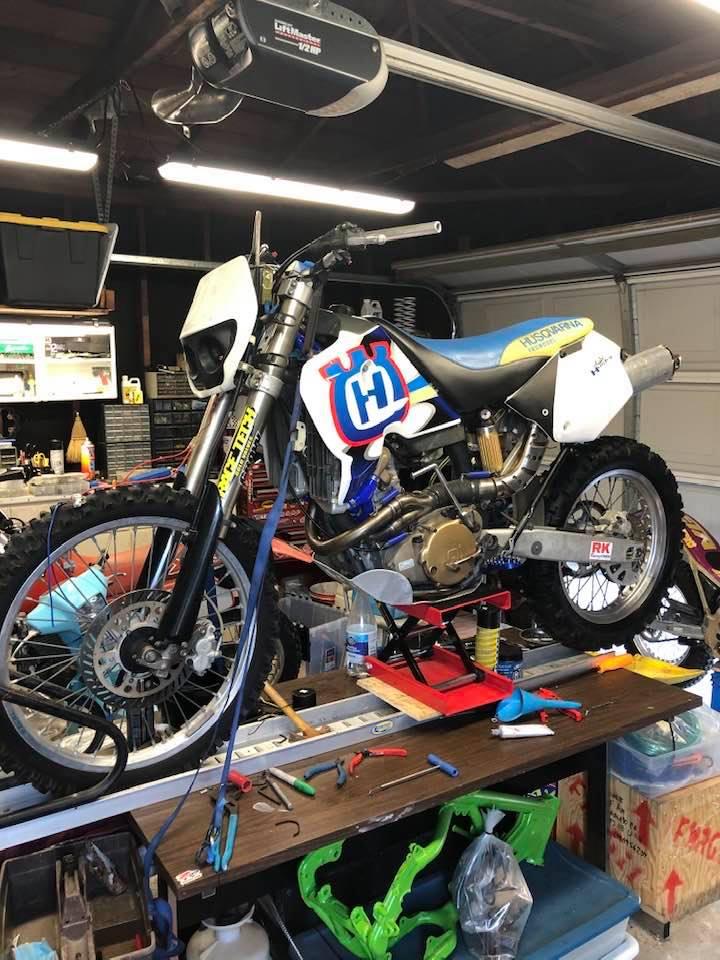

robertaccio 436 Posted October 7, 2020 I am actually further along , but I did have a couple of mock up pictures that give an idea of the look! Share this post Link to post Share on other sites
