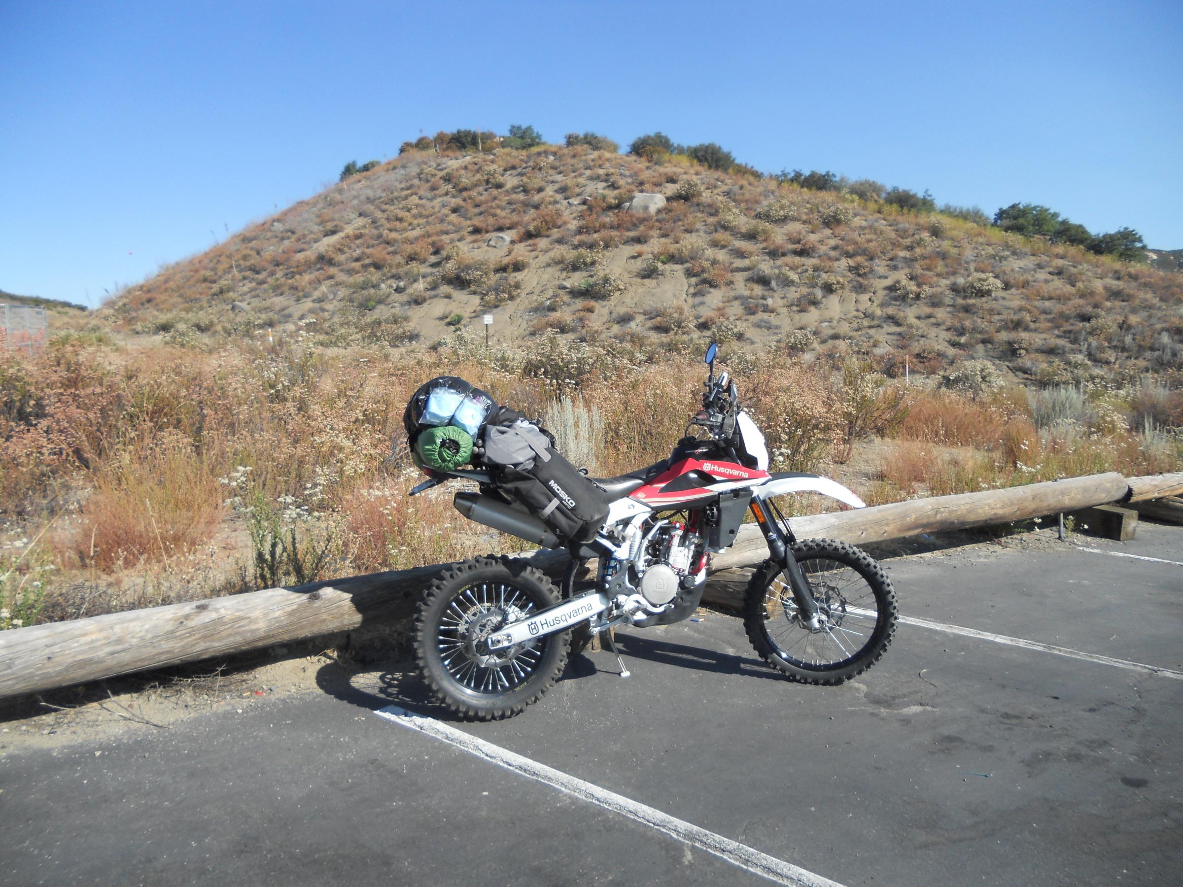

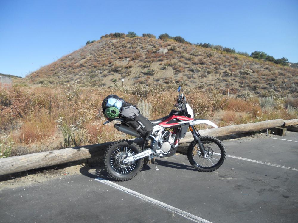

wildwood 11 Posted April 29, 2020 I haven't weighed my load from the Husky pick, but with gear, extra water (7.48 lb per gal), whisky, it's around 40#'s or more. If you pack like Kiwi Wayne (maybe half that [his evening steak probably weighs 5lbs.]) he can get more in a bag with less weight than anyone I've ever seen, you might skip an adjustment if you plan to ride after unloaded. 1 Share this post Link to post Share on other sites
