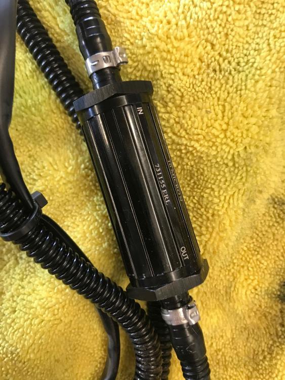

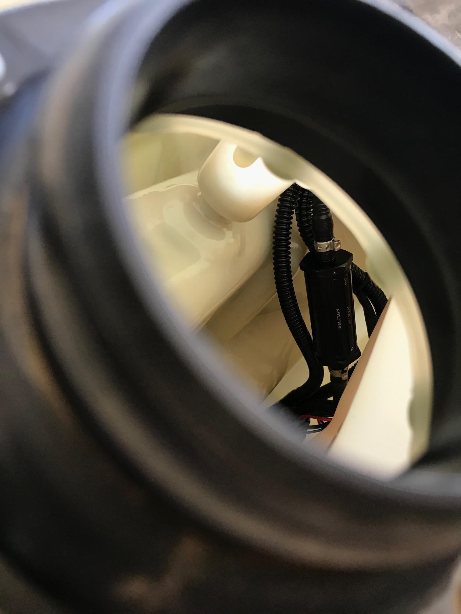

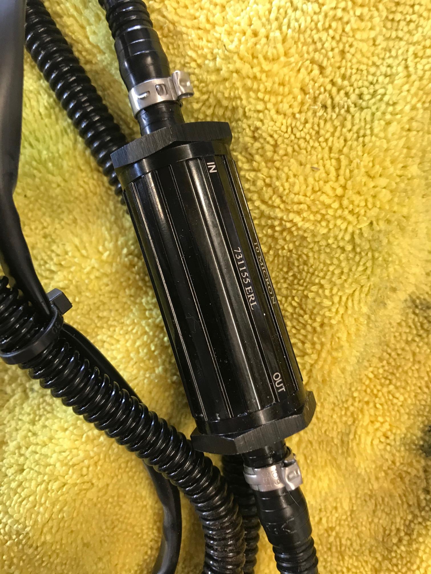

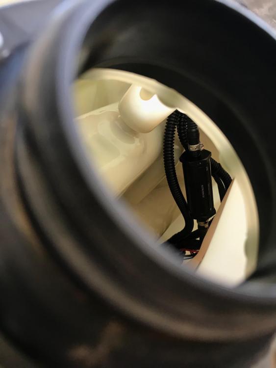

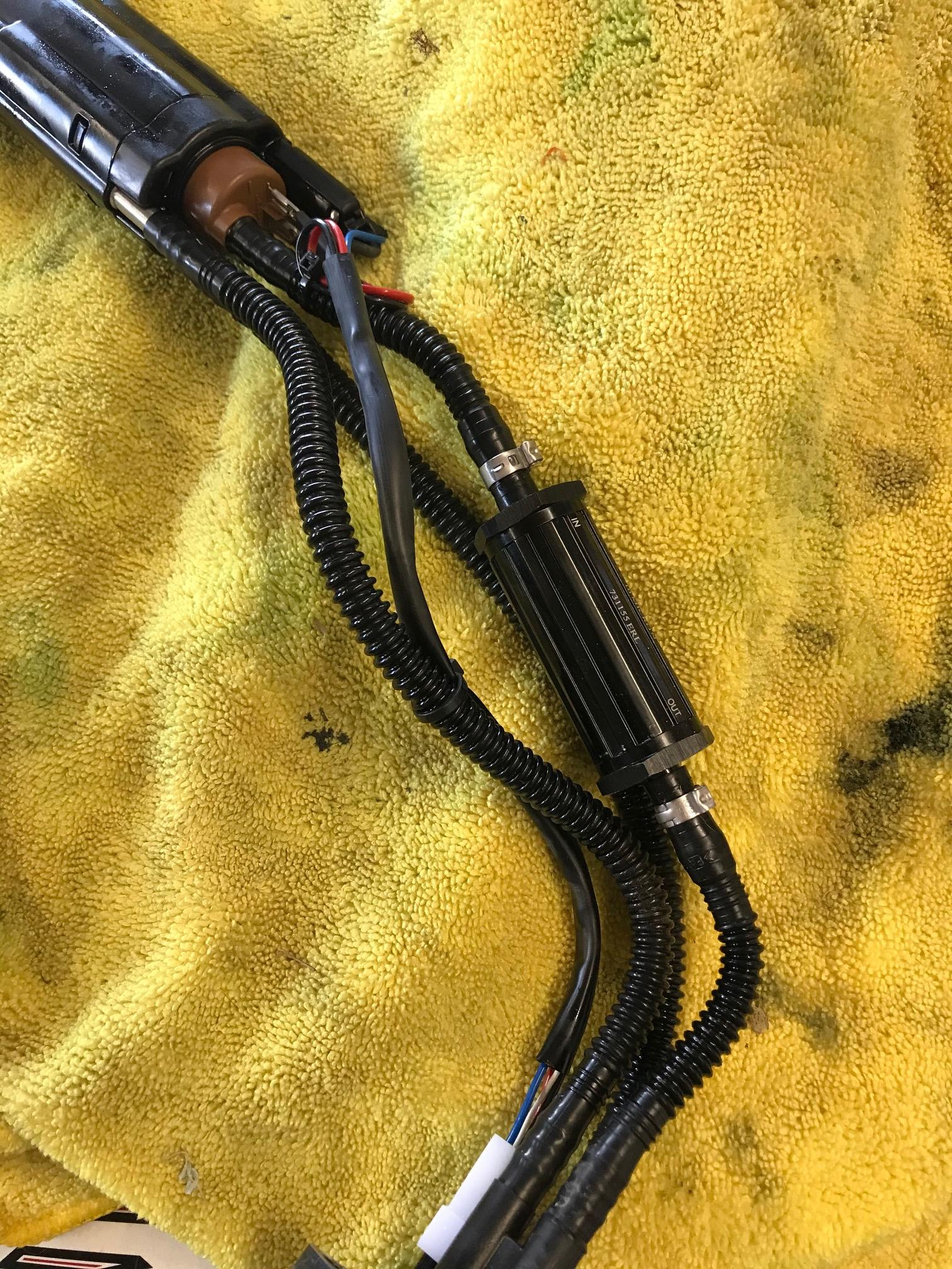

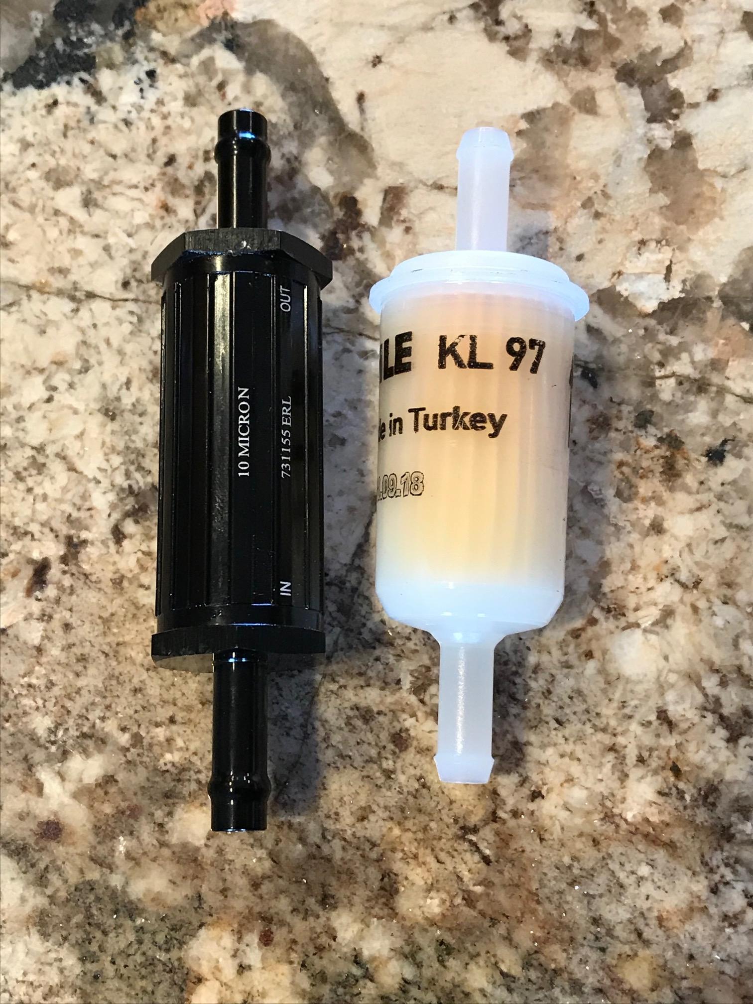

PbdBlue 46 Posted February 3, 2020 Received the Earls filter today. It's 1/2" longer and slightly slimmer than the stock Mahle. Installed it in my 3 gal Acerbis tank and it went right into the tank with no difficulty. Hoses and standard 10.9 Oetiker clamps went on snug and sealed well. Subsequent pressure check showed pump holding pressure >40 psi for 5+ minutes after shutting off which is comparable to the results I routinely get with the stock Mahle filter so it would seem there are no significant leaks at the clamps. Time for a test ride:) Share this post Link to post Share on other sites
PbdBlue 46 Posted February 13, 2020 I’m going to give the Earl’s filter a tentative thumbs up. Rode 75 miles today and noticed no difference in the performance of the bike compared to the Mahle. I’m only giving a tentative because I think I need more time on it to determine the longevity. Also if I had to do it over again I think I’d go with the 30 micron version. 10 micron is kind of overkill and the 30 micron might have a longer service interval. https://www.holley.com/products/plumbing_an_fittings_and_hose/vapor_guard/vapor_guard_fuel_filters/parts/730155ERL Share this post Link to post Share on other sites

amgems 79 Posted March 23, 2020 More on the Mahle fuel filter: The newer filters (the ones that split) are made in Turkey. Originally they were made in Austria (maybe less likely to split? I hope.). I had a Turkey filter split on my brand new 2018. KTM fixed that for me. I realized the country of origin change just recently when i changed out the filter. I have a bag of Austrian made filters. Bought it a few years ago before the switch to Turkey. Share this post Link to post Share on other sites
PbdBlue 46 Posted March 23, 2020 3 hours ago, amgems said: More on the Mahle fuel filter: The newer filters (the ones that split) are made in Turkey. Originally they were made in Austria (maybe less likely to split? I hope.). I had a Turkey filter split on my brand new 2018. KTM fixed that for me. I realized the country of origin change just recently when i changed out the filter. I have a bag of Austrian made filters. Bought it a few years ago before the switch to Turkey. Yep. Been that way for awhile. Does seem like the failures correlate with the change. Before 2017 failures didn't seem to be a big issue. I now have about 300 miles on the Earl's 10 micron filter. So far so good. Share this post Link to post Share on other sites
