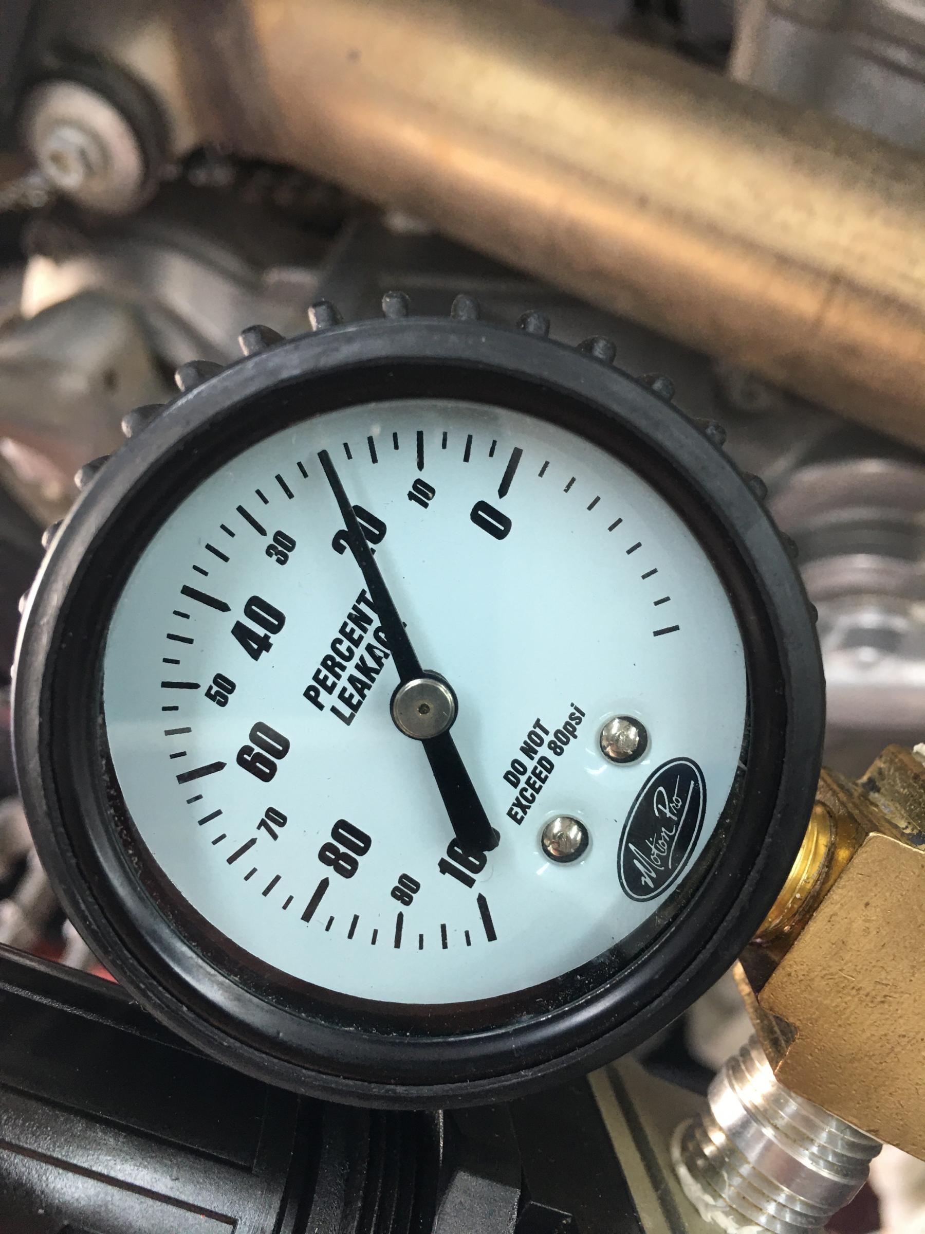

Bagstr 295 Posted December 21, 2019 https://www.rockymountainatvmc.com/Sales/2414/How-To-Perform-A-Leak-Down-Test-On-A-4-Stroke?utm_source=howtoperformaleakdowntestona4strokemotorcycle&utm_medium=Main-banner&utm_campaign=Email-SG Rocky Mountain MC Leak Down Test Video. Quick and easy - Share this post Link to post Share on other sites
paulmbowers 236 Posted December 21, 2019 1 hour ago, Bagstr said: https://www.rockymountainatvmc.com/Sales/2414/How-To-Perform-A-Leak-Down-Test-On-A-4-Stroke?utm_source=howtoperformaleakdowntestona4strokemotorcycle&utm_medium=Main-banner&utm_campaign=Email-SG Rocky Mountain MC Leak Down Test Video. Quick and easy - 1 Share this post Link to post Share on other sites

paulmbowers 236 Posted December 22, 2019 6 minutes ago, Bagstr said: HHmmmm, moderately a concern to know. Personally, I would ( and did Not ) prefer to live in ignorant bliss until The End on a desert wash, miles from rescue. I ordered the parts today and some tools- cha-ching! But as long as I use fresh fuel and stay out of 6th gear in a sand wash, the worst case is just riding very slowly back to the truck. It will wear out rather than catastrophically fail. A couple weeks it will be as good as new. Share this post Link to post Share on other sites
DSM8 427 Posted December 26, 2019 So was it rings or valves other than the picture not details so what are we talking about here? Share this post Link to post Share on other sites
paulmbowers 236 Posted December 27, 2019 On 12/26/2019 at 9:13 AM, DSM8 said: So was it rings or valves other than the picture not details so what are we talking about here? Mine's rings. I’ll replace piston, cylinder- r&I valves, replace only if necessary, clean head and valves, new valve seals and misc gaskets etc. I’m also replacing coolant hoses, including the frame T partsbill so far (with discounts) is about $1k Share this post Link to post Share on other sites
