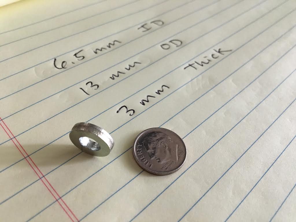

tvscum 43 Posted July 8, 2017 I rebuilt my lower end and just finished putting it all together and bolted the cylinder head on -- and then I found this unidentified washer on my parts table. It must have fallen off some bigger part that I did not bag. It looks like a 6.5 mm ID, THICK washer (not a copper sealing washer). Could it be this part (below) that holds the plastic cam chain tensioner arm in place, called a Drum Stopper Washer? I see photos of this washer online but it does not appear to be THICK like my random one. WASHER, DRUM STOPPER Part# 90417-360-000 Nightmare scenario here! It measure to be a 6.5mm ID washer, but I suppose it would also fit on a 6mm bolt. It definitely will not fit on a 8mm bolt. Measurements are on the attached photo. Any help from the xr400 experts appreciated! Share this post Link to post Share on other sites

kkug 160 Posted July 9, 2017 Order that part from Honda and see if it is the same . I guess is that is the part . Share this post Link to post Share on other sites
tvscum 43 Posted July 9, 2017 Thanks guys. I am going to order the part. Share this post Link to post Share on other sites

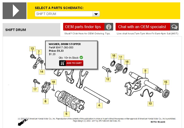

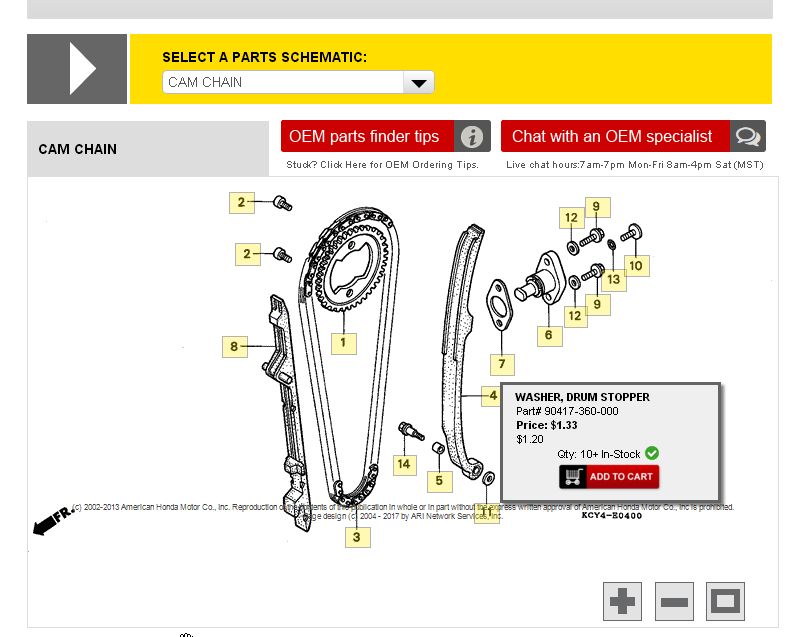

TrophyHunter 15 Posted July 9, 2017 You thinking #11 in this schematic? #11 Share this post Link to post Share on other sites
tvscum 43 Posted July 9, 2017 Yes #11, if any body has their XR400 apart please take a photo and post. I also put this message on Thumpertalk. I have ordered the washer anyway. Share this post Link to post Share on other sites

tvscum 43 Posted July 9, 2017 Update: THIS IS NOT THE RIGHT WASHER. I dove back in the right side. (I could not wait for that washer to arrive in the mail). This is a thin washer, not a thick one. On the two diagrams above, #11 and #14 are the same part number. So, I went back in and looked at #14, which I could do from the side cover without removing the clutch. It is a flat washer, therefore both #11 and #14 are not the right ones. They are common thin washers. Back to square one. I am starting to think this is just some random spacer that fell off a part. I will continue to search the parts diagrams. Thanks all. Share this post Link to post Share on other sites
Oracle 207 Posted July 9, 2017 I recently had a similar issue. I took the part into All American and showed it to the mechanic. He knew what it was immediately. So maybe a trip over to the dealership will help you. Share this post Link to post Share on other sites
kkug 160 Posted July 10, 2017 It looks like a spacer they press into some type of plastic part -- side covers --Fender-- ???? Share this post Link to post Share on other sites
