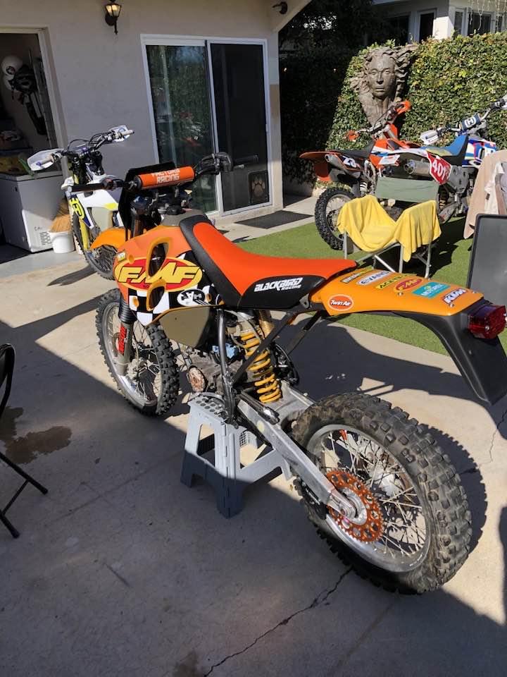

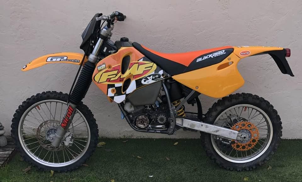

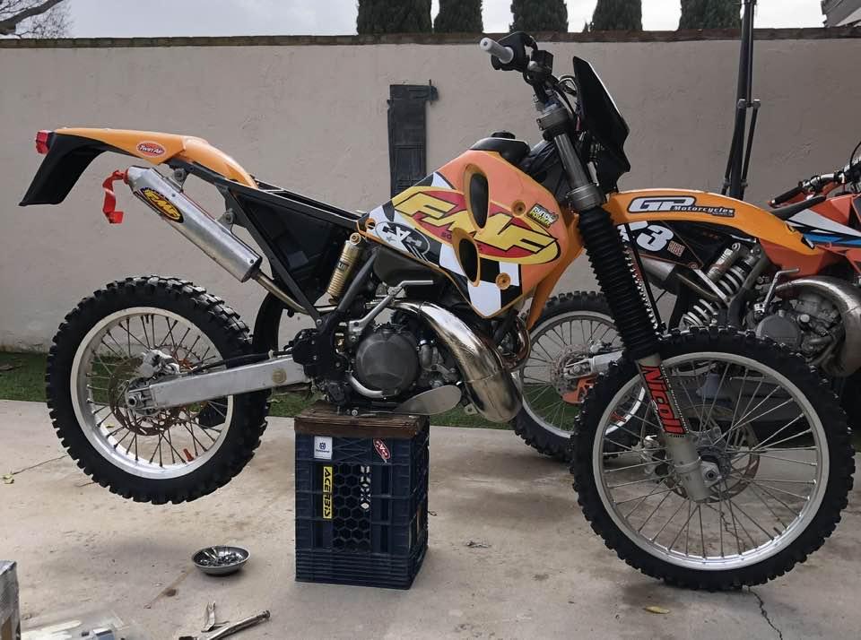

robertaccio 436 Posted December 8, 2022 (edited) Thinking this will be my spare machine, for friends etc.. Bike is 99% all there and by word of PO it was running fine when stored in garage. 2 strokes with their oil in fuel tend to remain in good order. I am hoping to do a major clean up job with minimal parts requirements and get er dialed rather quickly. Will need disassembly of the major structures to replace the frame. Will look similar to this one when done, for reference. Edited December 8, 2022 by robertaccio 2 1 Share this post Link to post Share on other sites

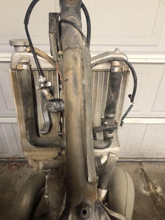

Pokey151 303 Posted December 9, 2022 (edited) My friend had that bike, The ECU can crack if the steering stops were not updated if I can remember correctly. Great power too. Edited December 9, 2022 by Pokey151 1 Share this post Link to post Share on other sites

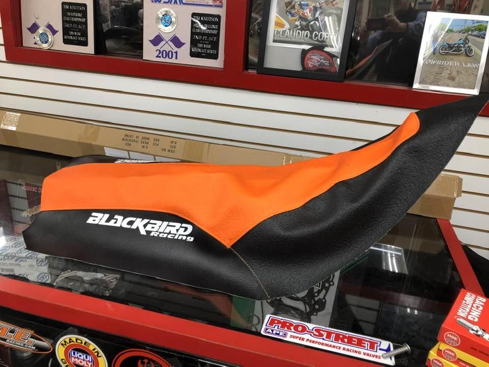

robertaccio 436 Posted December 9, 2022 already have Blackbird (graphics and seat cover) Italia on the way to dress the Austrian well. Share this post Link to post Share on other sites

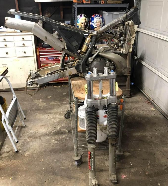

robertaccio 436 Posted December 9, 2022 I will take the before shots soon. she is frame/chassis with wheels and front end removed I will put all back on to get me a "roller" so I can more easily power wash for the pre work Share this post Link to post Share on other sites

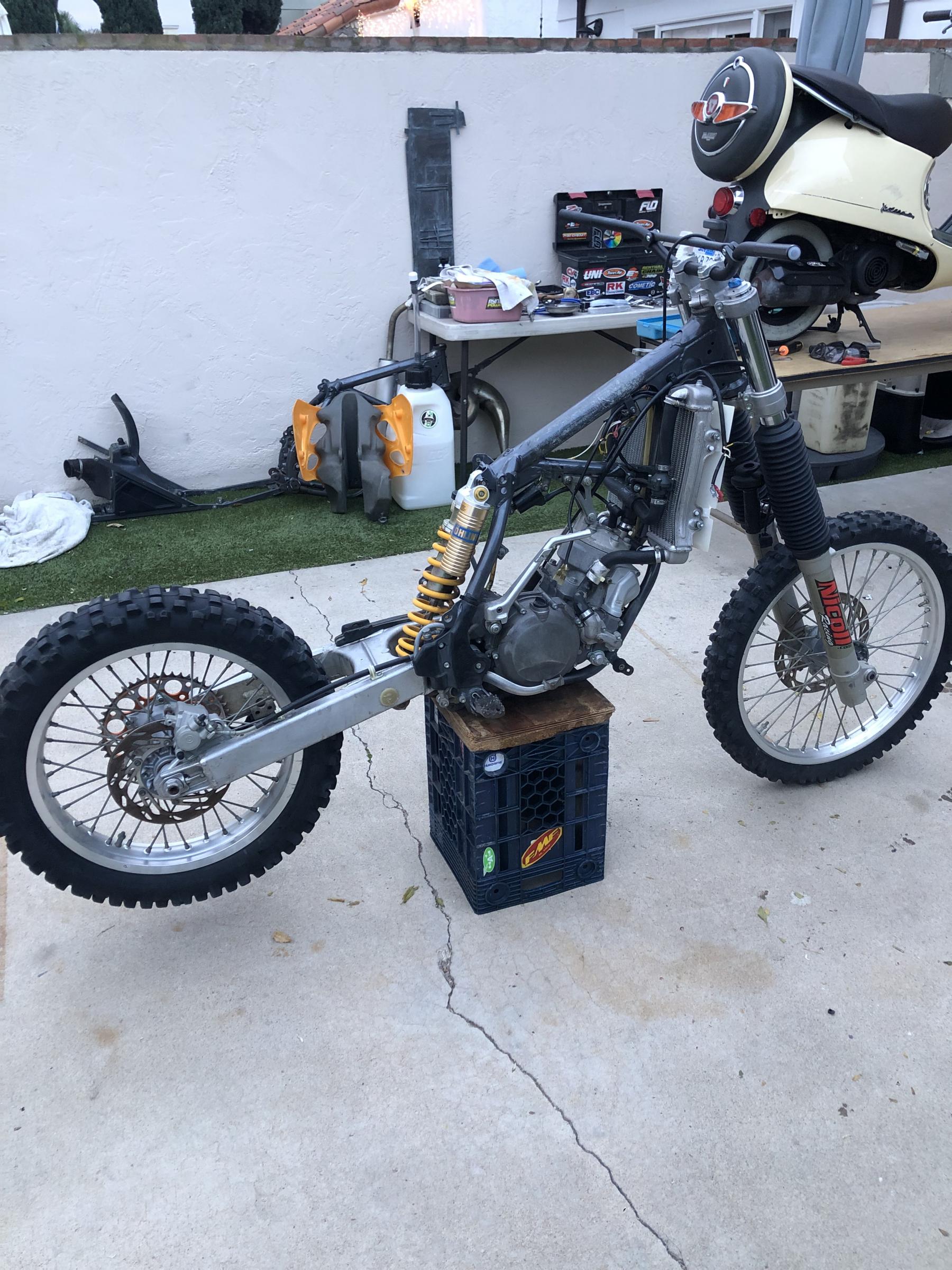

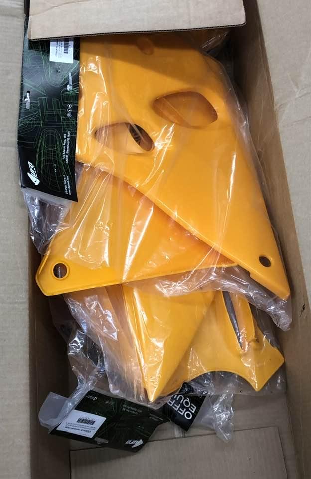

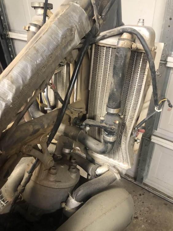

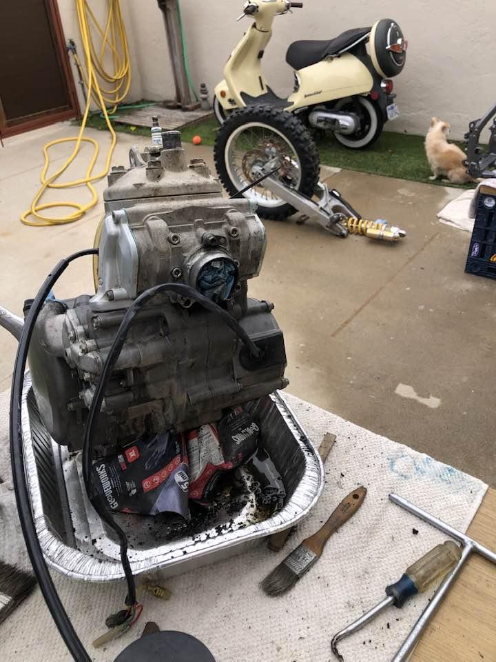

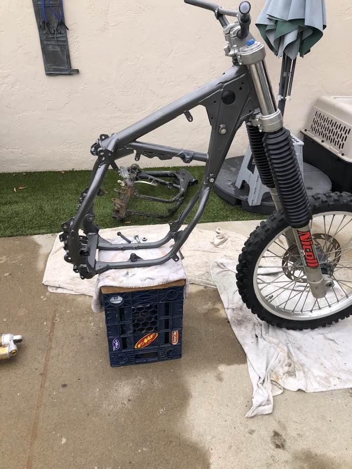

robertaccio 436 Posted December 18, 2022 (edited) silly me I never shot the before shots....... anyway I pressure washed , after making her a temp roller, and the teardown is flowing. My hold up is no frame paint for the new frame!!! I had to order what appears to be a good match-Krylon Metallic gray metal (something like that). BTW brake clean washes off Ohlins lable graphics... Ebay has Ohlins replica stickers.. So not going too deep, but, new plastics full enduro look with head and taillight set up, graphics, new seat, new bars, tires with mousses (full FIM set up), new used RH radiator, B8EIX iridium plug, new Twinair filter, and more OEM stuff gaskets for remove and inspect of covered insides. Maybe a new pipe (OEM one is badly dinged and twisted) . Worst discovery Ignition box is cracked do to lack of steer stop clearance.......simple but a known issue from the time period....owners not paying enough attention to detail. Hopefully the electronics are not compromised. Edited December 18, 2022 by robertaccio 1 Share this post Link to post Share on other sites

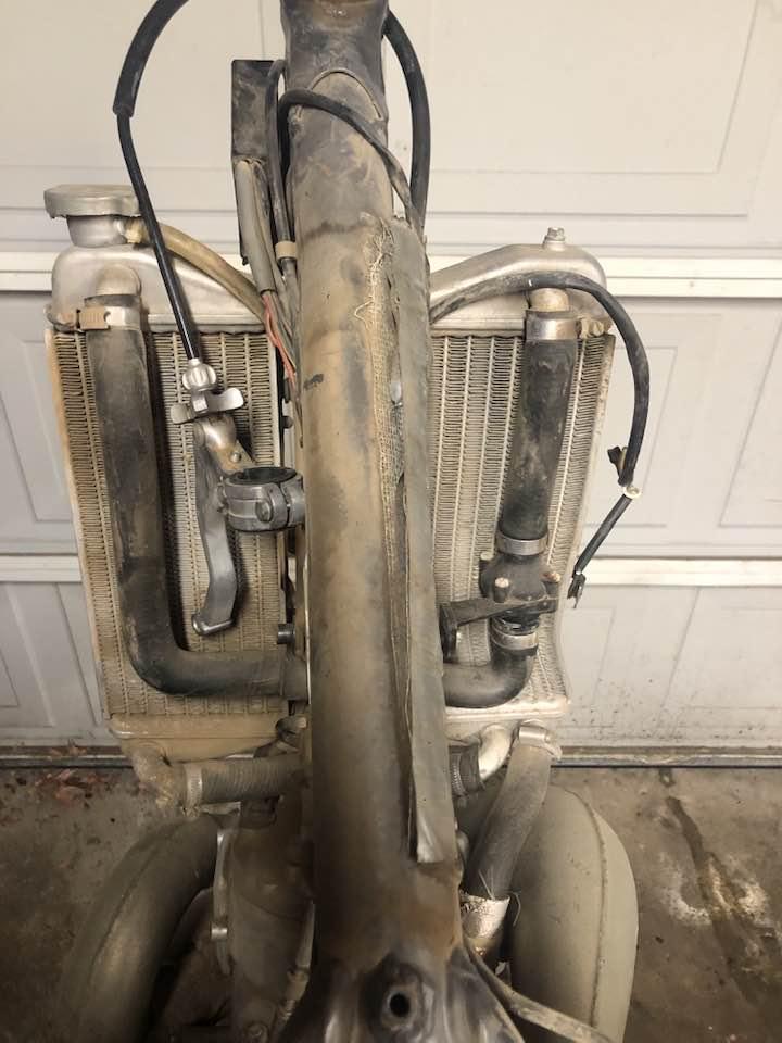

robertaccio 436 Posted December 21, 2022 On 12/8/2022 at 5:56 PM, Pokey151 said: My friend had that bike, The ECU can crack if the steering stops were not updated if I can remember correctly. Great power too. It's cracked....... the screw was way in, zero clearance...... 1 Share this post Link to post Share on other sites
Pokey151 303 Posted December 21, 2022 57 minutes ago, robertaccio said: It's cracked....... the screw was way in, zero clearance...... Hopefully it’s still good. Maybe seal it with epoxy. Can’t believe I remembered that 1 Share this post Link to post Share on other sites

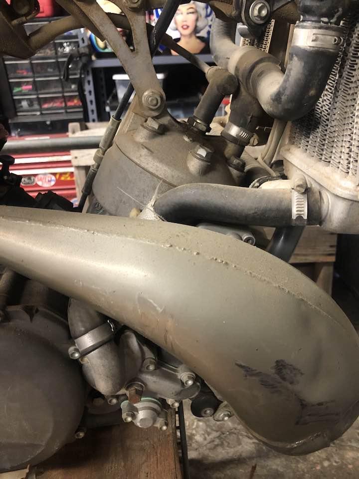

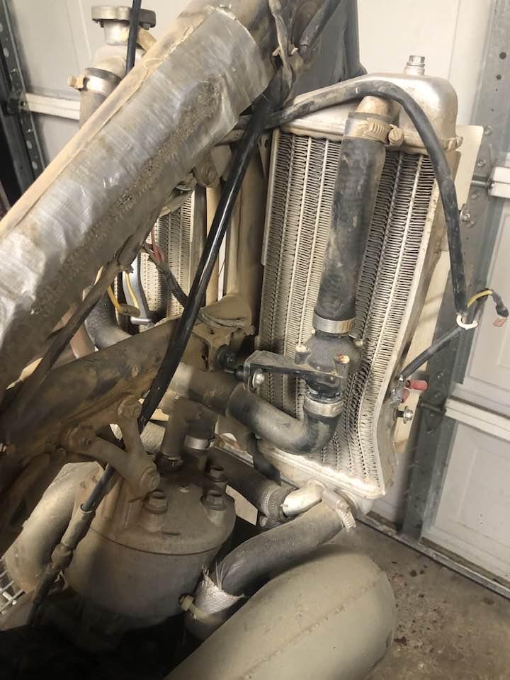

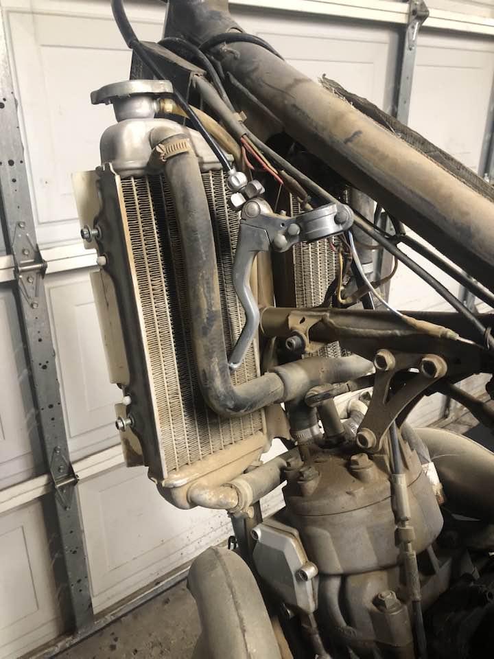

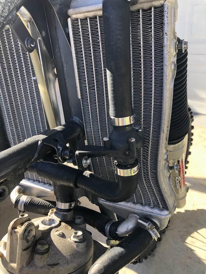

robertaccio 436 Posted December 21, 2022 New used set for RH Radiator on the way as well as a set of SX coolant hoses (no thermostat). I have always removed T-stats from my racing enduro/dirt bikes, for me it's just another potential failure item. Less is more for offroad. New bars are Moose brand Nekken very nice! All controls will remain as they are, there is MS "easy" clutch. never a fan of anything other than OEM all else is OEM. Coolant will be my standard Evans Non-aqueous, bullet proof stuff. Gearbox oil will be RedLine 80w , this stuff is magic. Mix will be EU standard 2% (50:1) with what I have on hand, Motorex or Maxima. Plug will be B8EIX iridium. Jetset will be OEM or FMF spec . I am not changing the OEM pipe and silencer which would drop a huge weight off the back, yet anyway. Don't want to get too spendy here. So for potential buyers I will recommend at least a silencer the OEM one is a bazooka and super heavy.(it may happen as I go into final assembly there are good FMF Turbinecore choices on ebay) 1 Share this post Link to post Share on other sites
robertaccio 436 Posted December 21, 2022 (edited) 16 hours ago, Pokey151 said: Hopefully it’s still good. Maybe seal it with epoxy. Can’t believe I remembered that Quick (re)search reveals a few companies here and in EU build them (or have them) to order in the form fit and close to finish as the OEM Kokusan units for @ 230 bucks Edited December 21, 2022 by robertaccio 1 Share this post Link to post Share on other sites

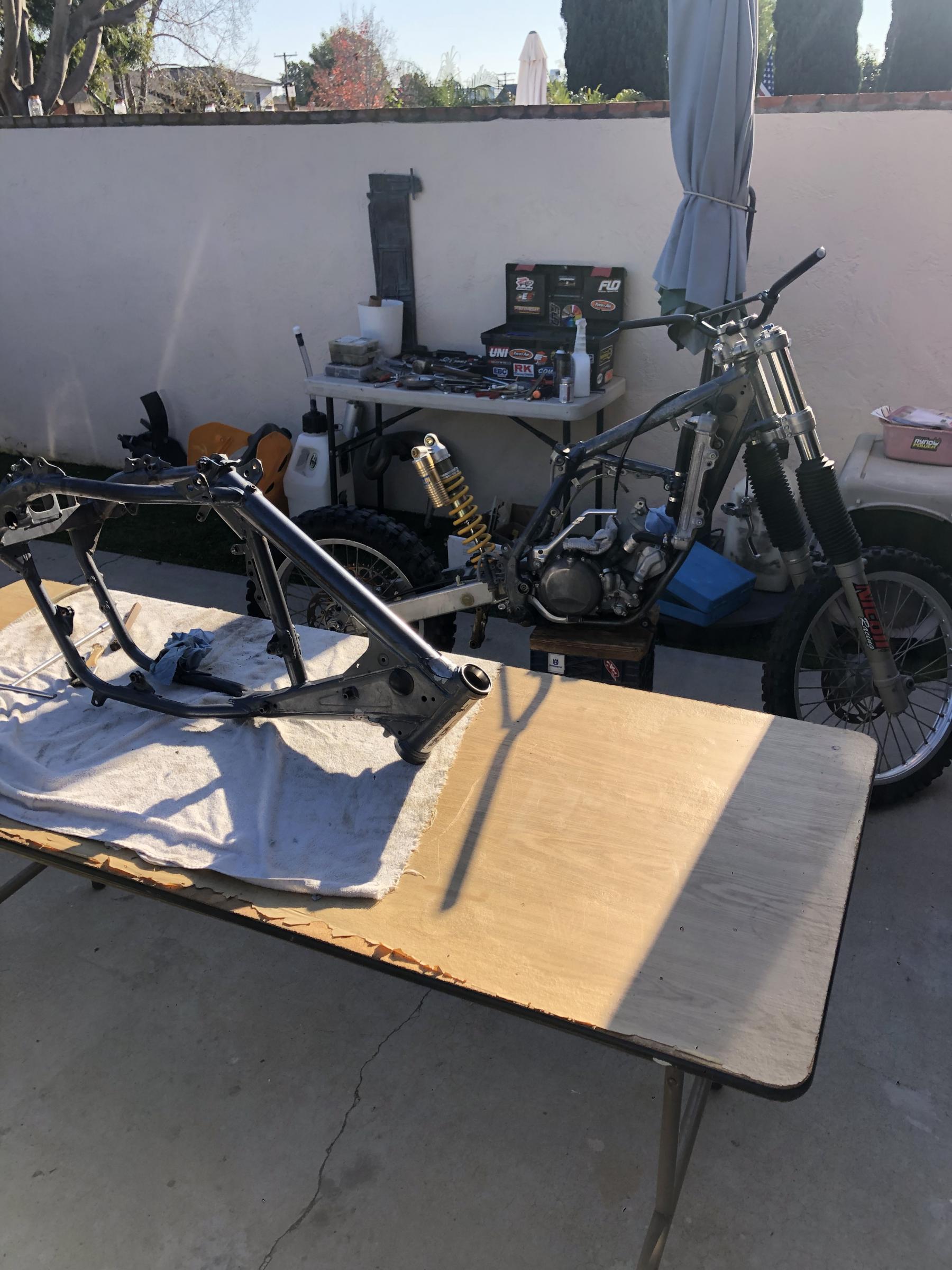

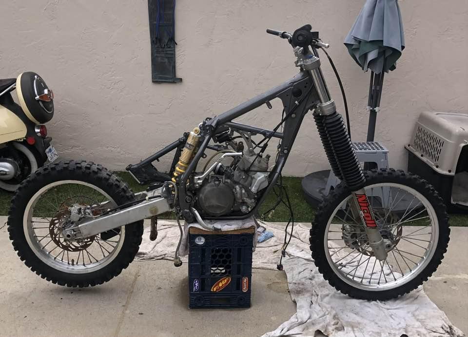

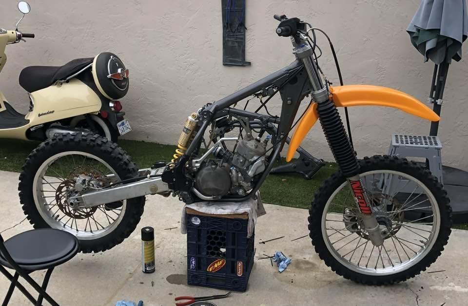

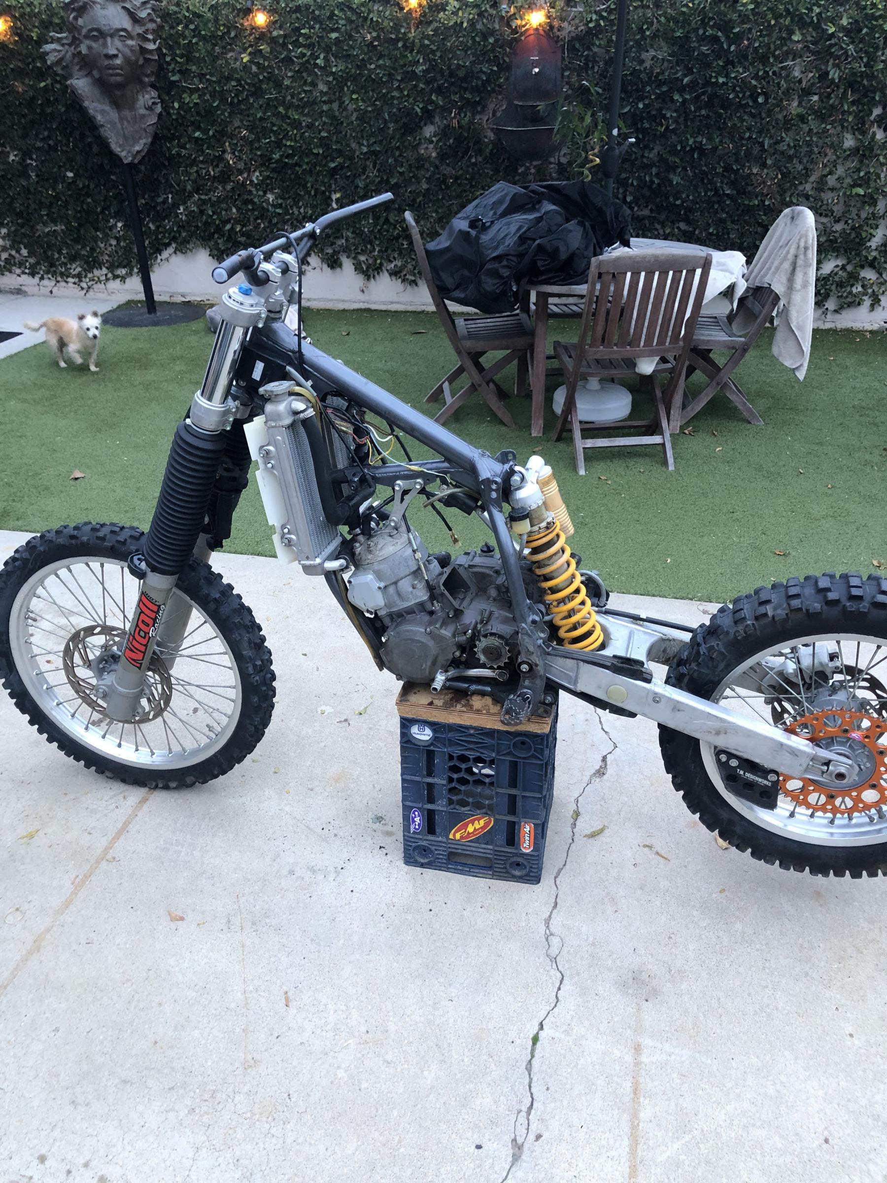

robertaccio 436 Posted December 24, 2022 (edited) Update photos, moving along well now. replacement chassis painted and installed engine (after bigtime clean up). Front end is installed , seat in work. had to install the fender just to make me feel good (still need fender bushings-on the way). Decided to leave the boots on , but have the OEM type open plastic fork guards as well. PS the boots are OEM catalog Marzocchi fork boots. Lubed most of linkage , will finish when I pull the wheels for tire installation. Offers anyone????(hahahaha). National City Motorcycles is my go to place for parts and logistics . Edited December 28, 2022 by robertaccio 2 Share this post Link to post Share on other sites

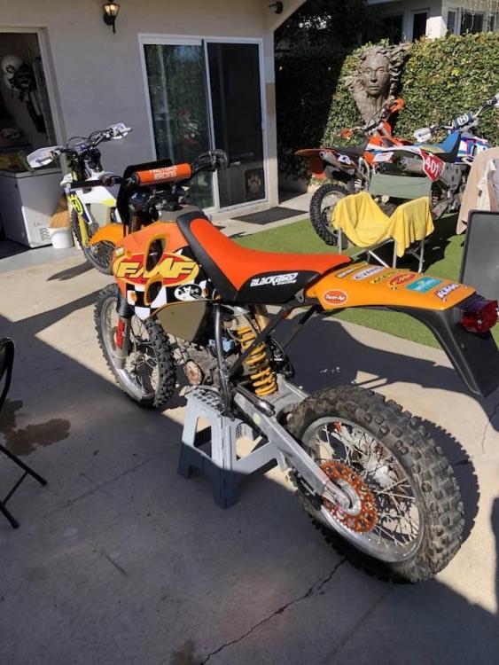

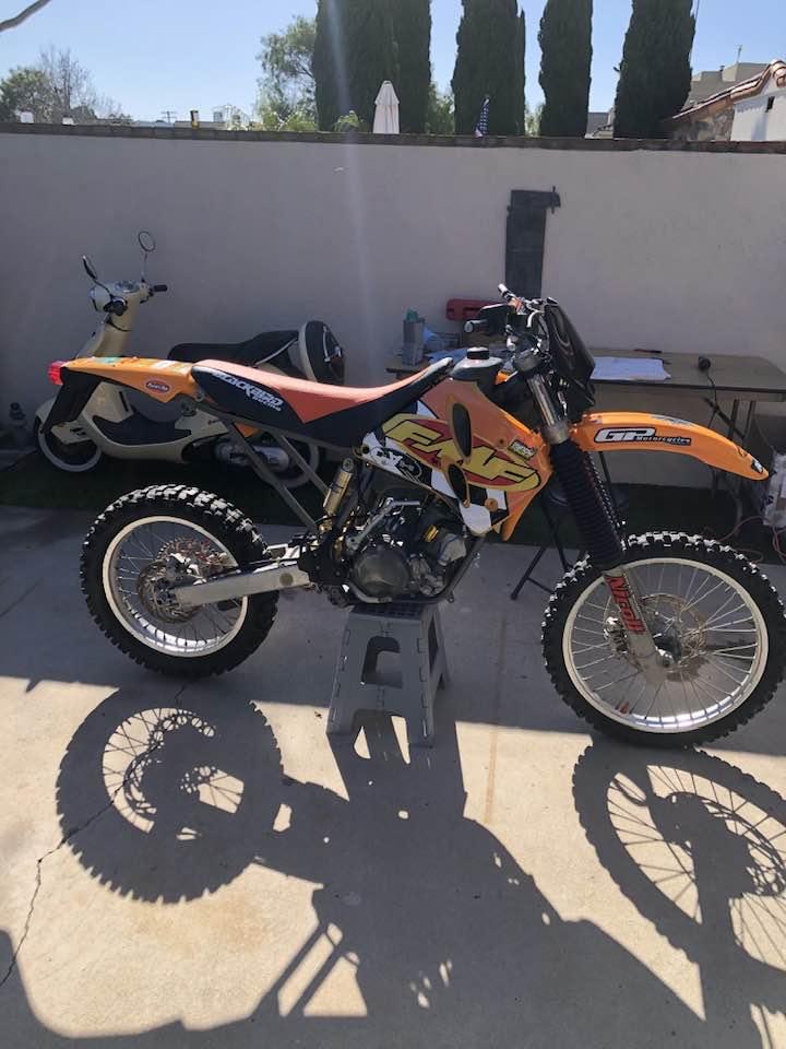

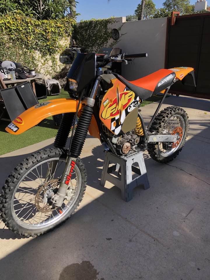

robertaccio 436 Posted January 9, 2023 (edited) worked the rear fender assy. ,got it good now. did another mock up to stay the motivation course. She's looking good and proper. Blackbird Graphic Italia gripper seat is in modern KTM ORN, but that's that!! Carbs is done just need vent hoses installed , airbox is being cleaned up so soon the all the mechanical stuff will be dialed. She still needs some electric work for lights and of course ignition. Will go ahead and install a new FMF Gnarley Pipe......$$$ (budget is running away a little..) . Have mousses and tires ready to install*. Hand grips ready to install. waiting for throttle tube. * on the garage shelf stuff, new Rear Shinko 216MX that I wasn't going to use on the other bikes , slightly used front Michelin Enduro Medium and all sorts of scrap mousses whole and pieces to stuff Edited January 9, 2023 by robertaccio 1 1 Share this post Link to post Share on other sites

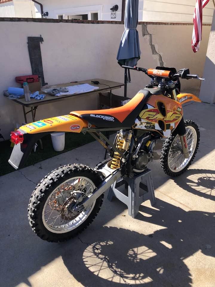

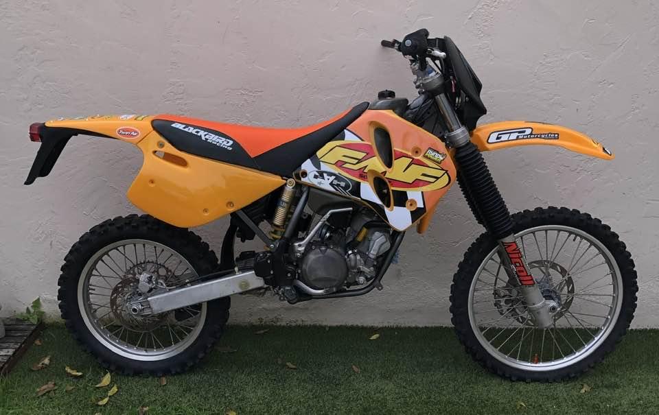

robertaccio 436 Posted January 16, 2023 More plastic mock up and perm stuff too, Skid Plate (probably Enduro Engineering), FMF system (new Gnarly with used TC 2 silencer). Thank you National City Motorcycles for the airbox clean up 1 Share this post Link to post Share on other sites
