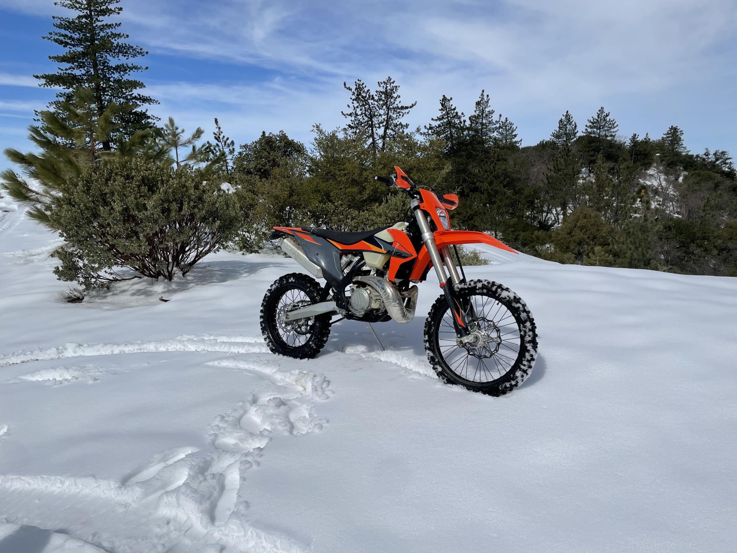

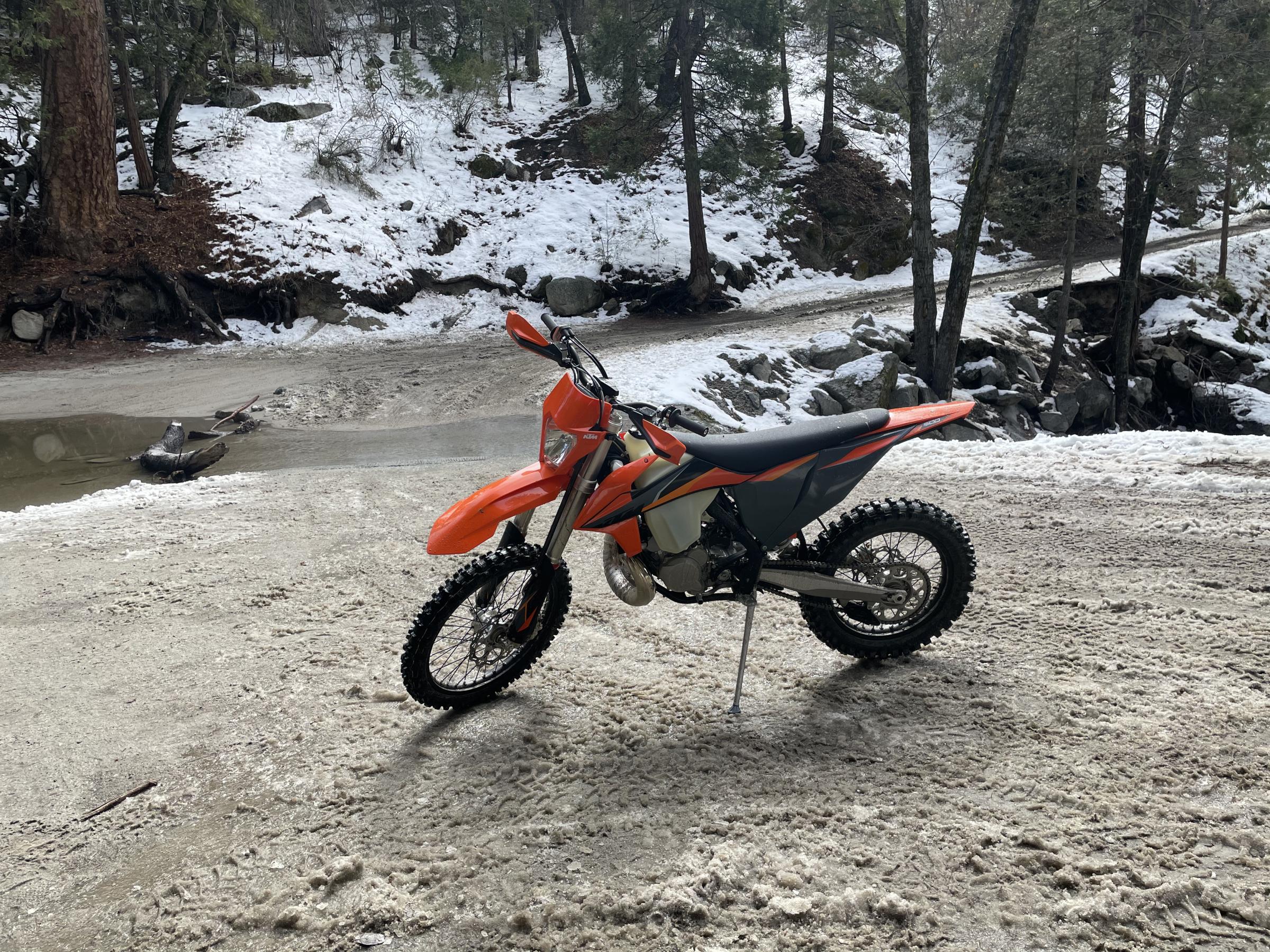

Pokey151 301 Posted March 15, 2021 Well I broke the bike in yesterday. What a fun bike. I can believe how light it is. I definitely need to do suspension work but other than that, what an amazing machine. I rode Bee Canyon to seek snow. I would say 30% of the ride was soupy mud and lots of deep puddles. This now was fun, Below the snow line was just fun. Tons of traction. however there was far too many SxS out there and a majority do not know what they are doing it seemed. anyways, watching big for my skid plate and a few other items to show up thanks again to all who gave advice and input. 1 Share this post Link to post Share on other sites
