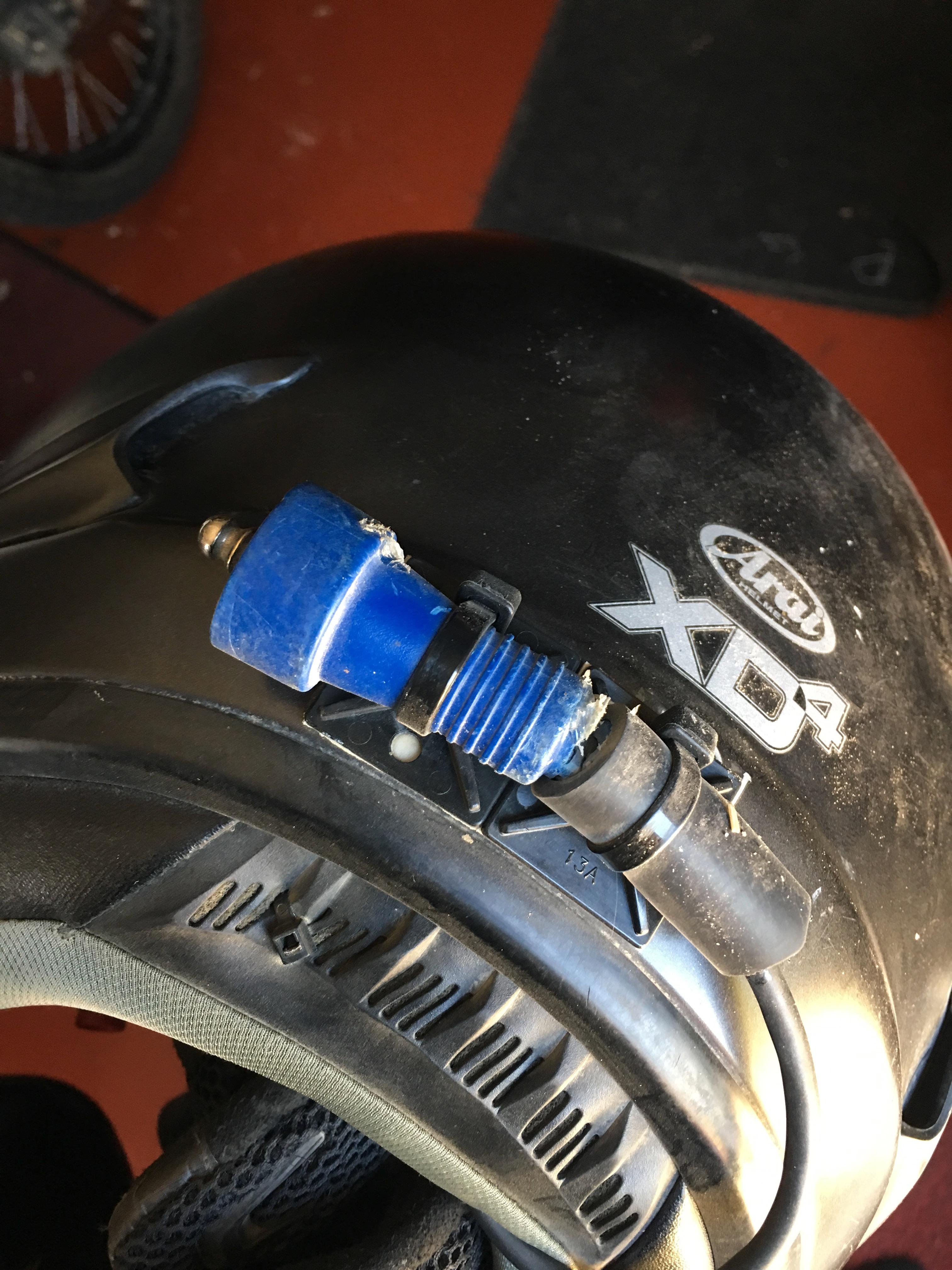

paulmbowers 236 Posted March 25, 2019 Different people use different methods for strain relief on the helmet. This is the correct way and only the cool guys do this- that's a piece of large vacuum tubing slit down one edge. Share this post Link to post Share on other sites
Uncle Champ 116 Posted March 25, 2019 No I was advised to not buy the rugged radios, due to programming hassles. I like that mount though , good idea. Share this post Link to post Share on other sites

kkug 160 Posted March 26, 2019 10 hours ago, paulmbowers said: Different people use different methods for strain relief on the helmet. This is the correct way and only the cool guys do this- that's a piece of large vacuum tubing slit down one edge. I am a nerd and used to do it the cool way . Now I have the cord droping down the side of my Helmet and never going back. I don,t have any problems at all. Share this post Link to post Share on other sites
paulmbowers 236 Posted March 26, 2019 7 hours ago, kkug said: I am a nerd and used to do it the cool way . Now I have the cord droping down the side of my Helmet and never going back. I don,t have any problems at all. Never been able to make that work- when I fall, it yanks the neatly-tucked wires out of the helmet. And this setup allows for single-handed connection/disconnections. Share this post Link to post Share on other sites

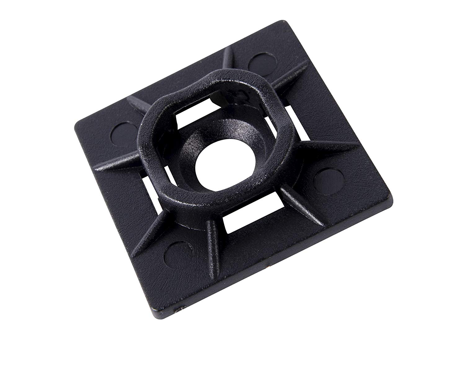

Mikey777 44 Posted June 10, 2019 Paul: Where did you get the helmet attachment thingys? Share this post Link to post Share on other sites
Oracle 206 Posted June 11, 2019 1 hour ago, Mikey777 said: Paul: Where did you get the helmet attachment thingys? I've seen them at Home Depot...maybe the electrical connections isle??? Share this post Link to post Share on other sites
paulmbowers 236 Posted June 11, 2019 1 hour ago, Mikey777 said: Paul: Where did you get the helmet attachment thingys? Yup- electrical aisle- made by Gardner Bender. Here's the Amazon listing: https://www.amazon.com/Gardner-Bender-MB-20UVB-Management-Industrial/dp/B00ATODLJE/ref=asc_df_B00ATODLJE/?tag=hyprod-20&linkCode=df0&hvadid=167122786755&hvpos=1o1&hvnetw=g&hvrand=15639401494222137338&hvpone=&hvptwo=&hvqmt=&hvdev=c&hvdvcmdl=&hvlocint=&hvlocphy=9061181&hvtargid=pla-307978992609&psc=1 Share this post Link to post Share on other sites

Huntndogs 114 Posted June 11, 2019 I used one of those electrical thingys to connect the mike boom inside the helmet too. Share this post Link to post Share on other sites
