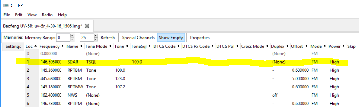

amgems 79 Posted March 16, 2019 So the PL tone is an acronym for Paul Limiting? Just kidding. It's a pleasure to hear Paul crooning on the radio. Just looked into using a PL tone a little bit. It seems pretty simple (on the surface). Basically you set up a channel on the radios where they operate like they are talking to a repeater but without the frequency offset. Is that correct? Is there any specific frequency for the ctcss tone when doing this ? It seems to me the columns in Chirp: Tone, ToneSql, DTCS Code, DTCS Rx Code would also need to be the same on the radios being used with a PL tone?? Share this post Link to post Share on other sites
PbdBlue 46 Posted March 17, 2019 Tone & tone squelch is all you need. DTCS is a different type of squelch and in my experience it can be a bit finicky. Yes all users will need to program their radios to utilize tone and tone squelch. Share this post Link to post Share on other sites
amgems 79 Posted March 18, 2019 Thanks Randy, So would line #1 shown below be correct if we were to program two handhelds for pl conversations? Does the frequency of the tone matter much? I just threw in 100 Mhz. Share this post Link to post Share on other sites
paulmbowers 236 Posted March 18, 2019 52 minutes ago, amgems said: Thanks Randy, So would line #1 shown below be correct if we were to program two handhelds for pl conversations? Does the frequency of the tone matter much? I just threw in 100 Mhz. I like where your CHIRP is going. Share this post Link to post Share on other sites
amgems 79 Posted March 18, 2019 Will wait for Randy to confirm, but I think the set up shown is correct. On the CHIRP web site, Understanding CHIRP's columns, I found this: Tone Mode¶ This sets the mode used to transmit or receive squelch tones (or related selective calling technologies). The following explains what the options means: (None): No tone or code is transmitted, receive squelch is open or carrier-triggered. Tone: A single CTCSS tone is transmitted, receive squelch is open or carrier-triggered. The tone used is that which is set in the Tone column. TSQL: A single CTCSS tone is transmitted, receive squelch is tone-coded to the same tone. The tone used is that which is set in the ToneSql column. DTCS: A single DTCS/DCS code is transmitted, receive squelch is digitally tone-coded to the same code. The code used is that which is set in the DTCS Code column. Cross: A complex arrangement of squelch technologies is in use. See the definition of the Cross Mode column for details. Tone This sets the CTCSS tone to be transmitted if the Tone Mode is set to Tone. In Cross mode, it has additional meanings (see description of Cross Mode for more details). ToneSql This sets the CTCSS tone to be transmitted and used for receiver squelch if the Tone Mode is set to TSQL. In Cross mode it has additional meanings (see description of Cross Mode for more details). https://chirp.danplanet.com/projects/chirp/wiki/MemoryEditorColumns Correction on the tone, not 100Mhz, it is 100Hz. Share this post Link to post Share on other sites
PbdBlue 46 Posted March 18, 2019 14 hours ago, amgems said: Thanks Randy, So would line #1 shown below be correct if we were to program two handhelds for pl conversations? Does the frequency of the tone matter much? I just threw in 100 Mhz. Yep👍. That's exactly the config we use in our desert group except on a different transmit\receive frequency. You can pick any tone you want. It really doesn't matter which tone frequency you use but obviously everyone has to configured the same for it to work. Share this post Link to post Share on other sites
Bagstr 295 Posted March 18, 2019 I am In on this; let's set a standard and get everyone together. Do the Yaesu units need a cable for setup, or can it be done from the key pad? Tone Deaf Bagstr Share this post Link to post Share on other sites
PbdBlue 46 Posted March 18, 2019 19 minutes ago, Bagstr said: I am In on this; let's set a standard and get everyone together. Do the Yaesu units need a cable for setup, or can it be done from the key pad? Tone Deaf Bagstr Yaesu's are easily done from the keypad. With the Baufengs it can be done from the keypad as well but it's not a particularly user friendly experience. So let's decide on the tone and get on with this. 100 hz is fine by me. Share this post Link to post Share on other sites
