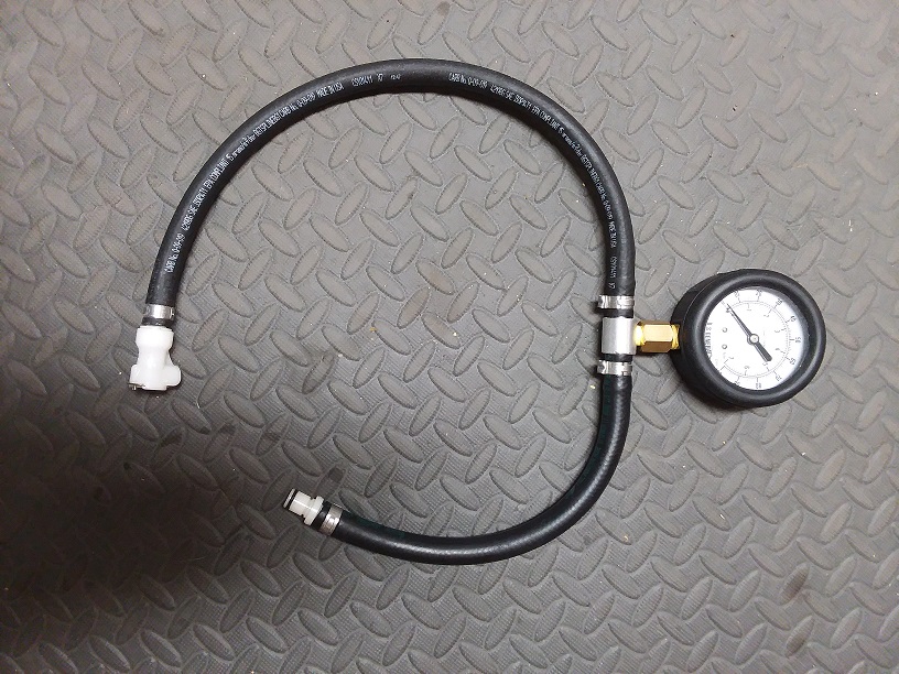

amgems 79 Posted July 15, 2018 I made a fuel pressure tester using a Harbor Freight gauge, some fuel injection hose, and some cheap ebay quick disconnects. Whole thing was maybe $50. Just plug it inline and start the bike. There is a trick to get the fittings into the holes in the tank. Tie a piece of thin safety wire onto the fitting and fish it thru the hole and then pull the fitting right into the hole. Share this post Link to post Share on other sites
paulmbowers 236 Posted July 15, 2018 55 minutes ago, amgems said: I made a fuel pressure tester using a Harbor Freight gauge, some fuel injection hose, and some cheap ebay quick disconnects. Whole thing was maybe $50. Just plug it inline and start the bike. There is a trick to get the fittings into the holes in the tank. Tie a piece of thin safety wire onto the fitting and fish it thru the hole and then pull the fitting right into the hole. First, great to know this is a club asset ; ) Yes, the first time I installed a pump/filter system in a tank, I used the safety wire method- worked great. The subsequent 10 times I've done it (I have three complete tanks now) I've not- and it was faster and easier. Share this post Link to post Share on other sites
amgems 79 Posted July 15, 2018 37 minutes ago, paulmbowers said: First, great to know this is a club asset ; ) Absolutely. Let me know if you want to test your pressure. Takes about 5 minutes. Share this post Link to post Share on other sites
