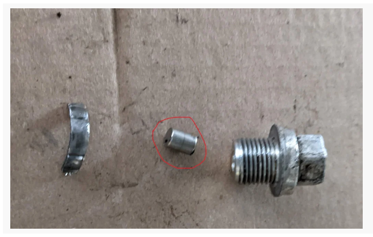

DSM8 422 Posted February 14 I read his thread in the DR forum. This was in his oil. As Udo would say (German accent on) Diz not Goot Share this post Link to post Share on other sites
tntmo 971 Posted February 14 I looked on the Suzuki parts diagram and didn’t see those parts. Share this post Link to post Share on other sites
DSM8 422 Posted February 14 4 minutes ago, tntmo said: I looked on the Suzuki parts diagram and didn’t see those parts. round thing is the magnet from his drain plug, metal strap looks to have come from the main bearing cage which is a exposed ball bearing type of main. That is my guess Share this post Link to post Share on other sites
tntmo 971 Posted February 14 Yeah, I was being sarcastic which doesn't come off too well in a forum. With a bearing cage busted off like that you have possibly wiped out your top end as well. The cam rides directly on machined surfaces of the cylinder head, having debris running through the engine could destroy those surfaces along with the cam and the rockers. Every bearing in the engine should be replaced to prevent further damage. The parts bill is going up. Sad to see an engine get destroyed like that, no way to tell without complete disassmebly. I didn't read all the pages of the DR Rider link until now, I hope you didn't try to ride it the 20 miles you were discussing? Have you removed the oil filter and looked at that? If it's full of glitter that's no bueno, and I imagine it will be. Share this post Link to post Share on other sites
ironmonkey007 2 Posted February 15 Hi All, Thanks for the responses. To answer some of the questions... Yeah I dumped the oil and saw part of the bearing cage attached to my magnetic drain plug. I can't recall if I saw anything in the filter but I don't think so. It was the bearing casing that stood out. When the issue originally happened I was riding up in Idyllwild and noticed a loud knocking sound. When I dismounted I saw oil leaking near the base of the engine, near the starter motor. I threw it in a U-Haul and drove back to SD, then had a mechanic take a look at it. He said it was shot and needed a full top/bottom rebuild. Afterwards I did end up riding it about 10 miles to storage. The original issue actually happened July 2023, but I was heading out of the country so I ended up storing the bike until I got back. The video is from last week when I got it running again (new battery, plugs, carb clean). The mechanic who originally took a look at it gave me a parts list. All the parts, bearings, gaskets, etc. (cost ~2100, not including labor)...I believe it was the crankshaft replacement that was the most expensive part. I did check with ProCycle and they do not have a DR 650 kit but told me I could send them the parts list for a quote. It does sound like finding a replacement engine is the most cost effective option. I was a little concerned about how that might work with updating the Title? I sometimes ride outside of the US and need my paperwork to be in order. I like the idea of bringing it to the meetup and getting to meet some of the community. If I can get it in a trailer next week I'll do my best to get up there! Thanks again! 1 Share this post Link to post Share on other sites
