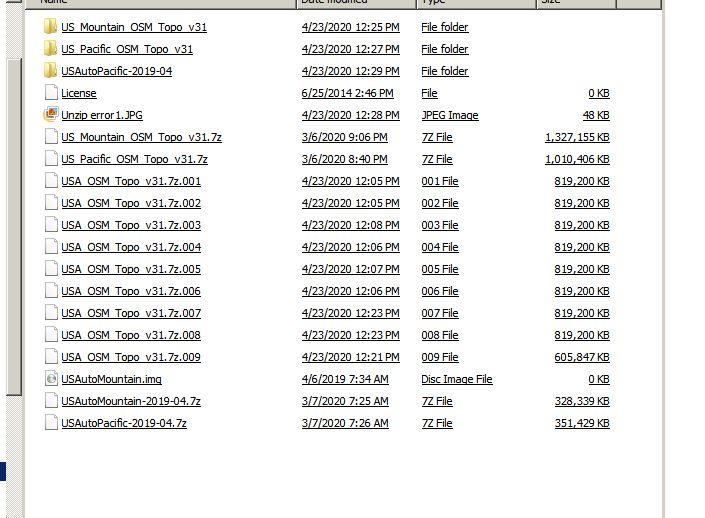

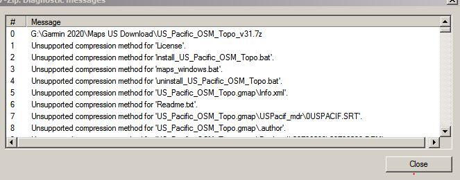

Mr.JAJA 454 Posted April 23, 2020 http://www.gmaptool.eu/en/content/usa-pacific-osm-topo-routable Thanks Randy. I have Pacific and Mountain, and 1-9 file. all a 7-zip files. than I try to extract and got a error message. Share this post Link to post Share on other sites
