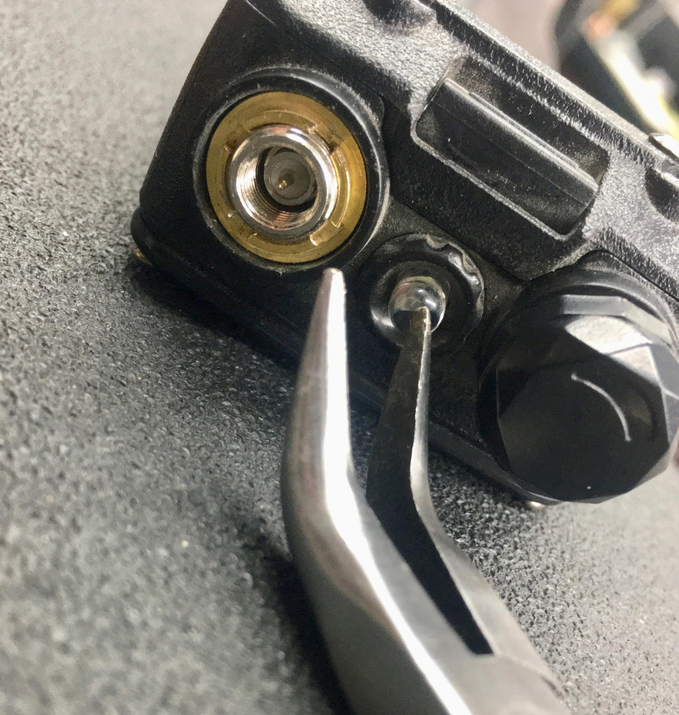

paulmbowers 236 Posted January 5, 2020 A few riders were gratified that I was recently silenced on the radio- I had some close-proximity communications abilities, but there was clearly something wrong. Or something right, depending on your unique point of view. Here's what I discovered: Under the antennas on the Baofengs there's a threaded brass collet around the antenna connector. The collet holds the connector tight to the radio's chassis to minimize transferred antenna movement to the circuit board. That collet can become loose with repeated antenna movement. My collet loosened over time, and it appears the connection of the antenna to the main board of the radio became compromised. You may wish to check your own collets to avoid this issue. Sadly for some, I've replaced the radio and I'm back up and singing better than ever. Share this post Link to post Share on other sites

paulmbowers 236 Posted January 6, 2020 Easy with a pair of needle nose pliers to engage the slots. Share this post Link to post Share on other sites
paulmbowers 236 Posted January 11, 2020 Here's a cool design- to tighten the collet on your Baofeng, just pull the volume control knob straight off. Underneath? The "socket wrench" that perfectly fits the tabs of the collet. Share this post Link to post Share on other sites
