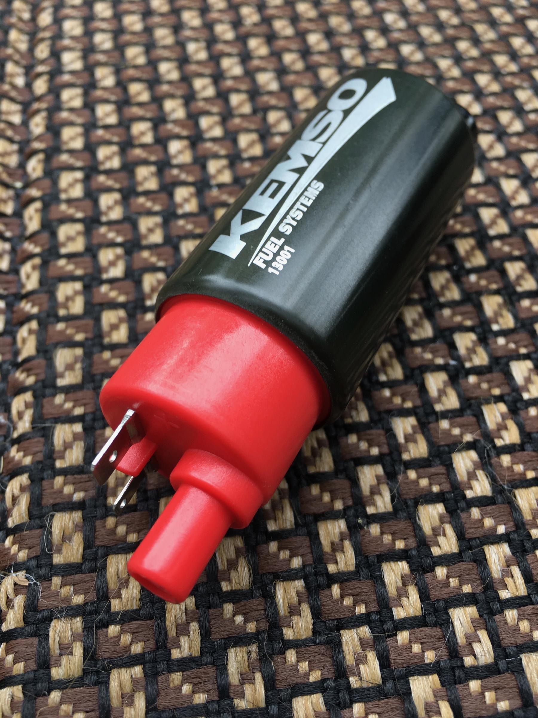

paulmbowers 236 Posted May 31, 2019 1 hour ago, PbdBlue said: PMB Though I know it wasn't necessarily by choice thanks for being the guinea pig here. Lot's of good info gleaned from this exercize. Sure, happy to help. I got the Kemso pump yesterday, and a quick glance shows similar issues- the white flange-thing (Kemso's is orange) is not going to work- structurally identical to the HPF. The have a screen that I'll test later on the stock white flange-thing to see if it is a possible replacement. Kemso's kit is very similar to the HPF- lots of alternative applications, filters for other uses, wires to adapt, etc. It's likely I'll use the Kemso and some of my cannibalized stock parts to create spare pump that's easy(er) to field swap. Share this post Link to post Share on other sites
PbdBlue 46 Posted May 31, 2019 1 minute ago, paulmbowers said: Sure, happy to help. I got the Kemso pump yesterday, and a quick glance shows similar issues- the white flange-thing (Kemso's is orange) is not going to work- structurally identical to the HPF. The have a screen that I'll test later on the stock white flange-thing to see if it is a possible replacement. Kemso's kit is very similar to the HPF- lots of alternative applications, filters for other uses, wires to adapt, etc. It's likely I'll use the Kemso and some of my cannibalized stock parts to create spare pump that's easy(er) to field swap. Does your Kemso have the long barbed port or the short smooth one? Share this post Link to post Share on other sites

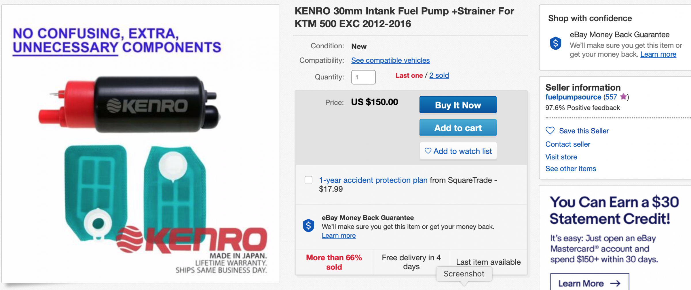

paulmbowers 236 Posted May 31, 2019 Here's another option- it's a KenRO and eliminates the confusing, extra, unnecessary components. And costs $150. Amazing. Share this post Link to post Share on other sites
paulmbowers 236 Posted May 31, 2019 2 hours ago, PbdBlue said: Does your Kemso have the long barbed port or the short smooth one? I think this is short and smooth- but I'm not an expert on such things ; ) Clearly the Kemso and the Kenro (above) are the same thing. Share this post Link to post Share on other sites
PbdBlue 46 Posted May 31, 2019 9 minutes ago, paulmbowers said: I think this is short and smooth- but I'm not an expert on such things ; ) Clearly the Kemso and the Kenro (above) are the same thing. Yep just like mine. I think HPF used to be like this but changed probably because the hose may come off? That said if it saves me from dropping out of a 5 day trip it's worth $28. Share this post Link to post Share on other sites

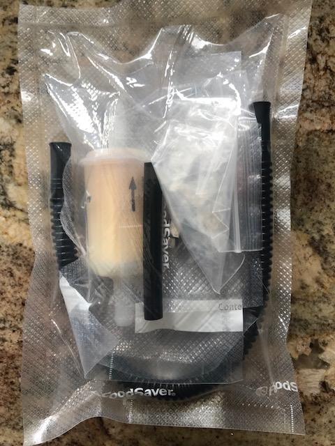

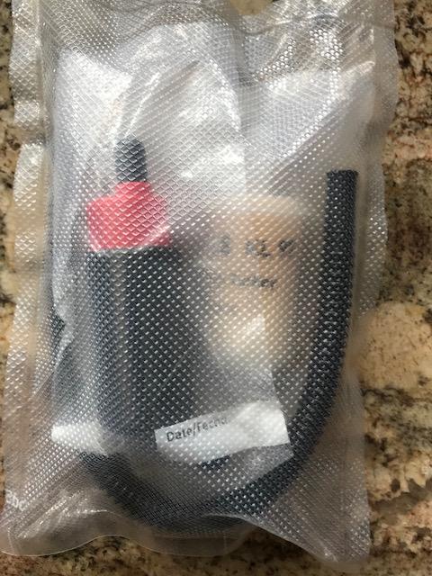

PbdBlue 46 Posted May 31, 2019 My new emergency fuel system repair kit. Fuel pump, Mahle filter, hose, assorted clamps, etc. Share this post Link to post Share on other sites
paulmbowers 236 Posted May 31, 2019 1 hour ago, PbdBlue said: My new emergency fuel system repair kit. Fuel pump, Mahle filter, hose, assorted clamps, etc. Vacuum packed for freshness. Share this post Link to post Share on other sites

PbdBlue 46 Posted May 31, 2019 47 minutes ago, paulmbowers said: They'd have to close. When I was working my boss hated the place. Lot’s of expense reports from there:) Share this post Link to post Share on other sites
PbdBlue 46 Posted May 31, 2019 51 minutes ago, paulmbowers said: Vacuum packed for freshness. Don’t want it to get stale. Actually just sealed but not vacuum. Keeps the dirt out. Share this post Link to post Share on other sites

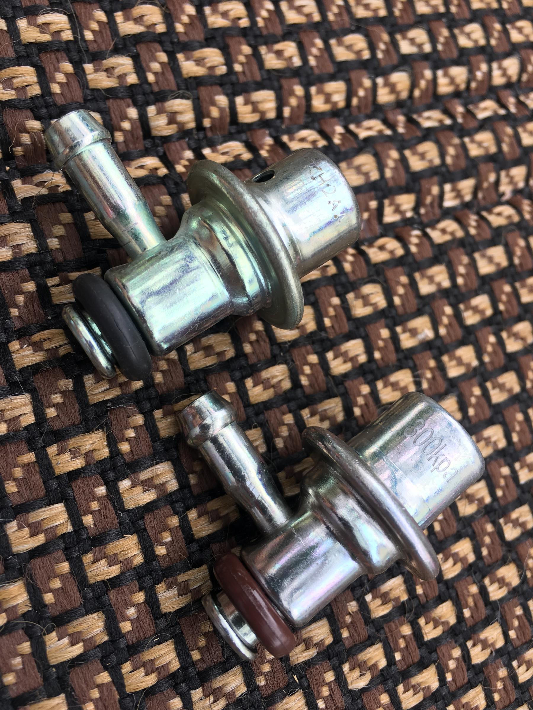

paulmbowers 236 Posted June 1, 2019 Here's some more lessons- the Kemso using the HPF regulator, also checked in at 41 lbs. I didn't check that pump with the stock regulator because I'm lazy, no good, and will never amount to anything. My parents were ultimately correct. 🤷♂️ I've ordered a complete OEM, made in China KTM replacement system from the eBay link above. If I were a motocrosser type, riding tracks very close to the truck, I might consider using an aftermarket cobbled-together fuel system. I'm sending back the HPF system, and will carry the Kemso pump with scavenged OEM flange and strainer as a backup. Share this post Link to post Share on other sites

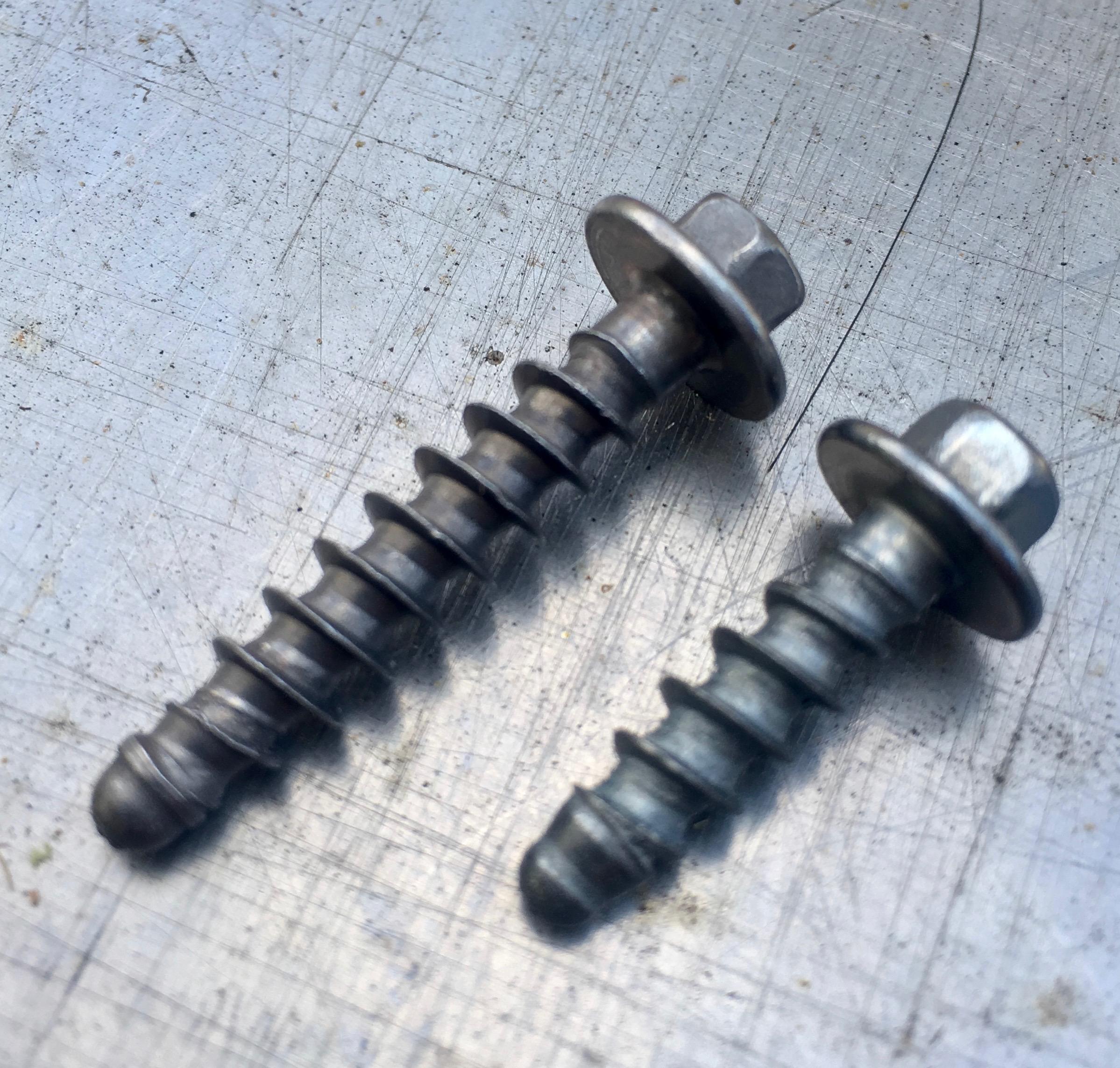

paulmbowers 236 Posted June 1, 2019 And. The screws that hold the rear flange of the system in the tank are called EJOT and are designed for thread-cutting in thermoplastics. Repeated screwing and unscrewing as if one were testing aftermarket fuel components is not recommended- the holes will eventually enlarge and be less able to hold the screws. Good news is the rear flange seal takes very little pressure to be effective- but it's a bit unsettling to barely tighten those screws. There's a fix- a couple of them in fact. One fix is #12x1" stainless wood screws from Home Despot, which probably works, but offends my delicate sensibilities. Then people stick ZipTies in the holes before inserting the screws. Other folks burn/melt the ZipTies into the holes first, or burn similar plastic material and drip it in. Others use epoxy glue and spray WD40 on the screws before assembly. There's a a more graceful solution. KTM HH COLLAR SCREW M5X16 0014050163 is the stock screw. KTM has a longer screw SPECIAL SCREW K60X30 0017060305 that will work perfectly and I'll use after I receive the new system. Yes, I've measured the boss(es) on the tank to be sure it's not too long. Not exactly sure of their intended application. Full KTM retail price is $1.07, and of course GP Cycles sells them for $1.99. More threads, more hold. Share this post Link to post Share on other sites

PbdBlue 46 Posted June 1, 2019 55 minutes ago, paulmbowers said: Here's some more lessons- the Kemso using the HPF regulator, also checked in at 41 lbs. I didn't check that pump with the stock regulator because I'm lazy, no good, and will never amount to anything. My parents were ultimately correct. 🤷♂️ I've ordered a complete OEM, made in China KTM replacement system from the eBay link above. If I were a motocrosser type, riding tracks very close to the truck, I might consider using an aftermarket cobbled-together fuel system. I'm sending back the HPF system, and will carry the Kemso pump with scavenged OEM flange and strainer as a backup. The regulator is available in 3 and 3.5 bar calibrations. I wonder if they sent you a 3 bar? 3 bar = 43.5 psi 3.5 bar = 50.8 psi 43.5 is pretty close to 41 taking into account your inaccurate 3” gauge. Share this post Link to post Share on other sites
paulmbowers 236 Posted June 1, 2019 12 minutes ago, PbdBlue said: The regulator is available in 3 and 3.5 bar calibrations. I wonder if they sent you a 3 bar? 3 bar = 43.5 psi 3.5 bar = 50.8 psi 43.5 is pretty close to 41 taking into account your inaccurate 3” gauge. Yes. The regulator was marked 300kpa, which is 43.5. That’s another odd choice by HPF- why 43 when factory is 51? Share this post Link to post Share on other sites
