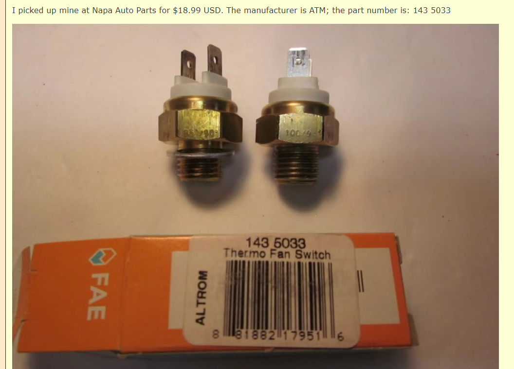

amgems 79 Posted October 30, 2018 This is from the "Wee-Beasty" thread on KTM Talk It's a 95/90. Pretty close to what you are looking for? Share this post Link to post Share on other sites
Oracle 206 Posted November 1, 2018 Thanks guys, good feedback. In my search, I did find that Napa part. My concern is that with the lower temp range, the fan will come on more often. And since the fan draws 3 amps, I'd be concerned about it drawing down the battery (my concerns are probably unfounded?). It would be nice to know what others are running but it's one of those parts that most people don't pay attention to until they need a new one. Share this post Link to post Share on other sites
