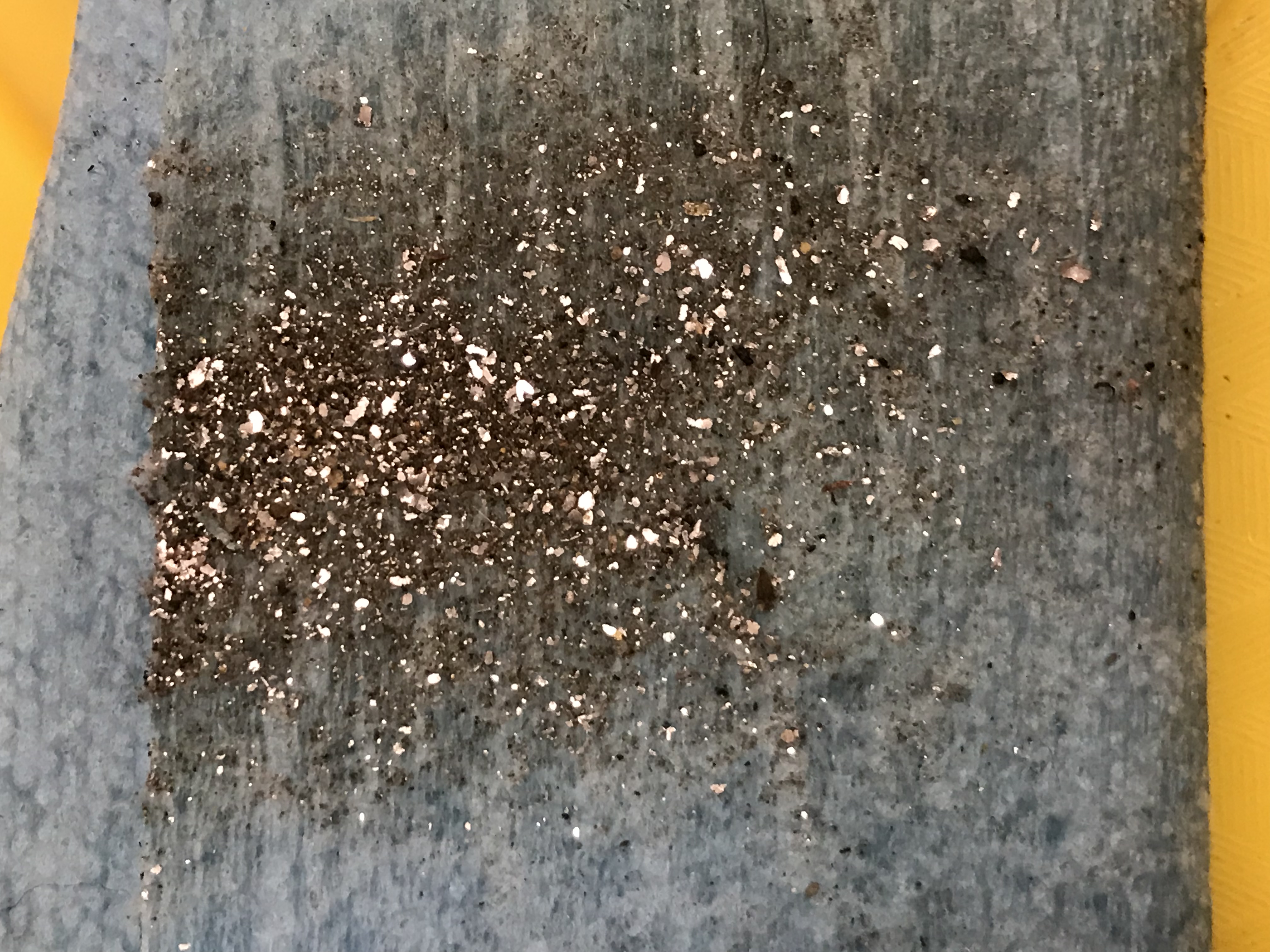

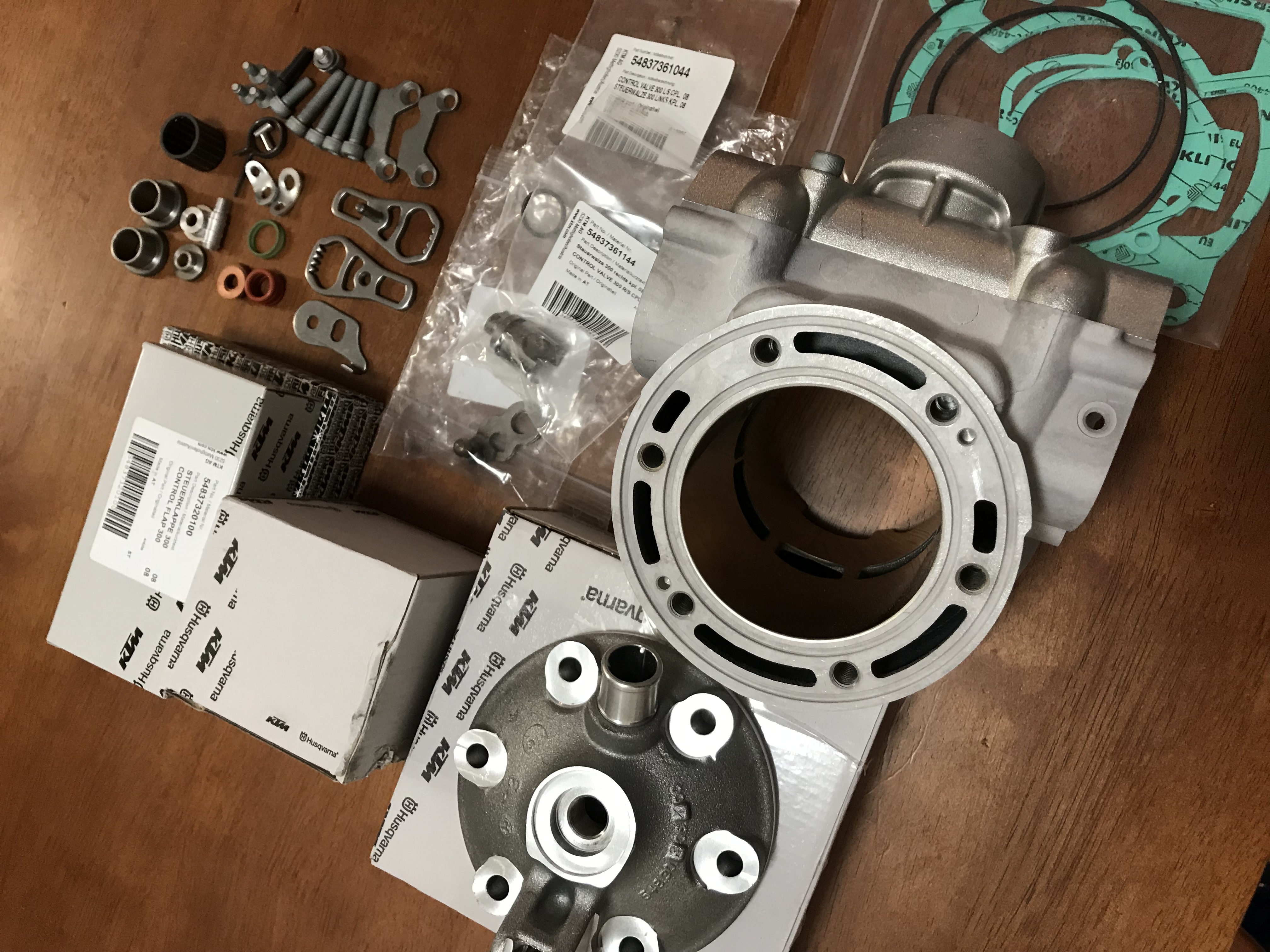

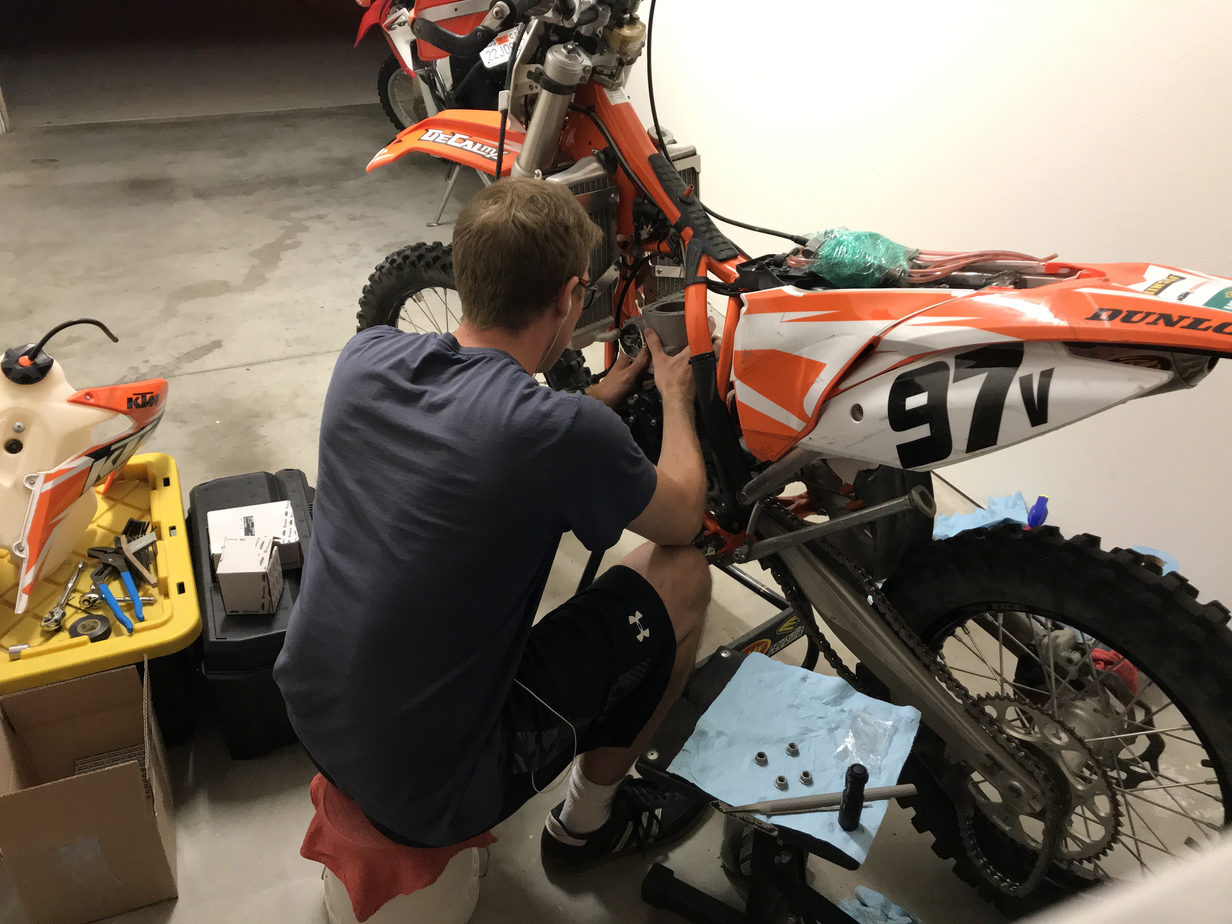

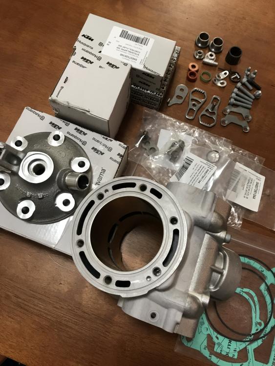

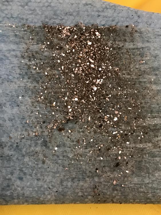

TexasDualler 32 Posted May 13, 2018 Bike is back up and ripping again. Slavens kit was the way to go. Couple things to note though, the kit did not come with the EZ clips as advertised, it did however come with the SX CDI box and wrist pin bearing that I was told was not included. EZ clips would’ve been nice but I’m not one to complain and after copious amounts of four letter words and YouTube videos I was able to get the provided piston clips in place. In the end it was TOTALLY worth it. Bike fired up with just a tap of the magic button and I’m loving the low end grunt it has now. The power band is smooth everywhere. And it’s so nice that it’ll actually hold an idle again. No more having to constantly pump the gas to keep her running. I really should’ve done this sooner. The kit Labor of love This is what I was able to flush out of the bottom end. So so in conclusion, new ‘16 cylinder, SX head, SX CDI box, .5mm base gasket installed (vs .6mm stock). Also glad I decided to pull the motor out of the frame because I found the swing arm bolt had come completely loose. Yikes. Also gave me the opportunity to put some fresh grease in the swing arm bearings. Share this post Link to post Share on other sites
