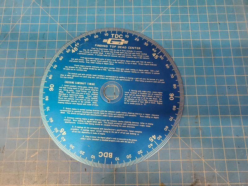

tubebender 56 Posted September 28, 2024 I've got a degree wheel ......somewhere. Found it. Even has instructions; as if you ever follow them 😄 1 Share this post Link to post Share on other sites
Mr.JAJA 454 Posted September 29, 2024 That must be a US made. I have a German made, no Instructions. Share this post Link to post Share on other sites
DSM8 427 Posted September 29, 2024 20 hours ago, tubebender said: I've got a degree wheel ......somewhere. Found it. Even has instructions; as if you ever follow them 😄 Hold on a minute you expect me to READ?!! Do you even know me?!!!!! 2 Share this post Link to post Share on other sites
