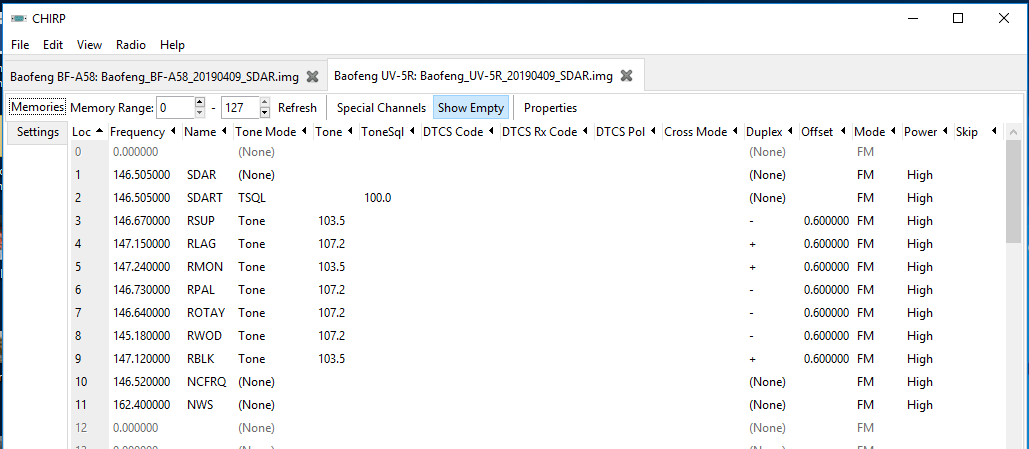

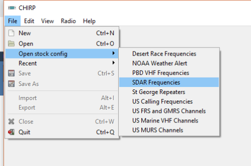

PbdBlue 46 Posted April 3, 2019 Okay guys I got this figured out. I created an CSV file with the frequencies. Here's how to use it. 1) Download the csv file 2) copy it to C:\Program Files (x86)\Chirp\stock_configs 3) Start Chirp 4) Download from your radio the existing programming. 5) Form the Radio Tab at the top of the screen select "Import from stock config" 6) A menu will appear and select SDAR Frequencies from the list. 7) A dialogue window will pop up guiding you through the process of importing the frequencies. This will work with any radio Chirp supports (Baufeng, Yaesu, etc.) and not just the Baufeng. This procedure is for Windows. The SDAR Frequencies will be listed in the stock config list for future sessions once you have copied it to the stock config folder. I assume a Mac will be similar but I don't speak Mac so can't help you there. Not sure if the site will let you download a csv so somebody give it a try and feedback. SDAR Frequencies.csv Share this post Link to post Share on other sites
PbdBlue 46 Posted April 3, 2019 One more refinement. The squelch type for the repeaters should be Tone and not TSQL. I fixed the CSV file. New one is attached. SDAR Frequencies.csv Share this post Link to post Share on other sites

paulmbowers 236 Posted April 3, 2019 15 hours ago, PbdBlue said: One more refinement. The squelch type for the repeaters should be Tone and not TSQL. I fixed the CSV file. New one is attached. SDAR Frequencies.csv I did this, and it resolved the issue I was having on the repeaters- BUT! I think I also changed the SDART frrq to tone as well- was that a mistake? And- the Laguna repeater seems really noisy- breaks the squelch with just static- is it just me? Share this post Link to post Share on other sites
PbdBlue 46 Posted April 3, 2019 Yeah you need SDART to be TSQL. As for the repeater noise you need to increase the squelch level. You may have to change the squelch level table if you can't get it to squelch properly. http://www.miklor.com/COM/UV_Squelch.php Share this post Link to post Share on other sites

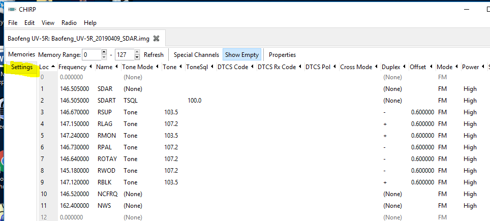

amgems 79 Posted April 9, 2019 We will test again just to be sure, but I think we are good. Ch 1: SDAR freq without PL tone Ch 2: SDAR freq with PL tone Ch 3: Superstition Repeater Ch 4: Laguna Repeater Ch 5: Monument Peak Repeater (also on Mt Laguna w links east) Ch 6: Palomar Mt Repeater Ch 7: Otay Mt Repeater Ch 8: Mt Woodson Repeater Ch 9: Black Mt Repeater (the one near Glamis. Not the one near Penasquitos) Ch 10: 2 Meter Natl Calling Freq Ch 11: Natl Weather Service San Diego Share this post Link to post Share on other sites

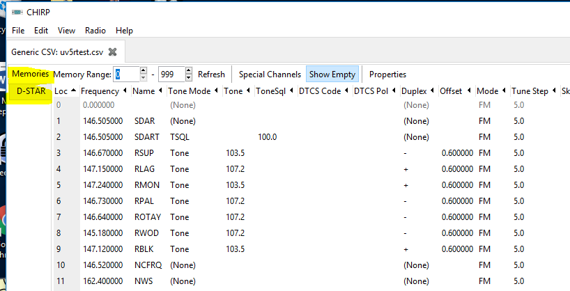

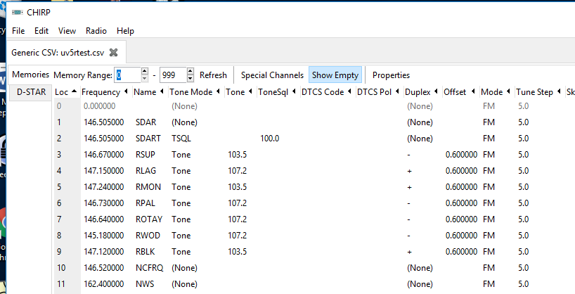

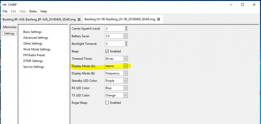

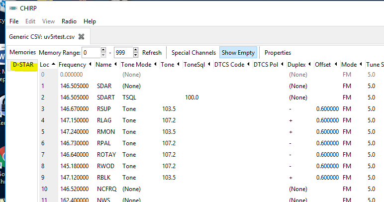

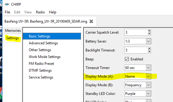

amgems 79 Posted April 10, 2019 2 hours ago, PbdBlue said: A csv file added to the stock configurations folder will work with the VX170. I did my FT-270 & VX-170 as well as the Baufengs using it. If you guys need any help give me a shout. I tried the .csv file approach in the stock configs but when I opened it in Chirp, it changed the "format?" of the Chirp program and wouldn't allow the change to the display to show the channel "name". I can do it manually from the keypad on the Baofeng but not sure about other brands of radios. Also with the .csv file loaded into Chirp, when I went to "upload to radio" is was greyed out. I'm probably missing something obvious. If not using a .csv file we can still load to different radios by picking that radio in "the upload to radio" dialog box. That worked for me with a Baofeng BF-A58 and a Baofeng UV-5R. Could not test with another brand, yet. .csv: Cut and paste .img: Settings using cut and paste .img: Share this post Link to post Share on other sites
