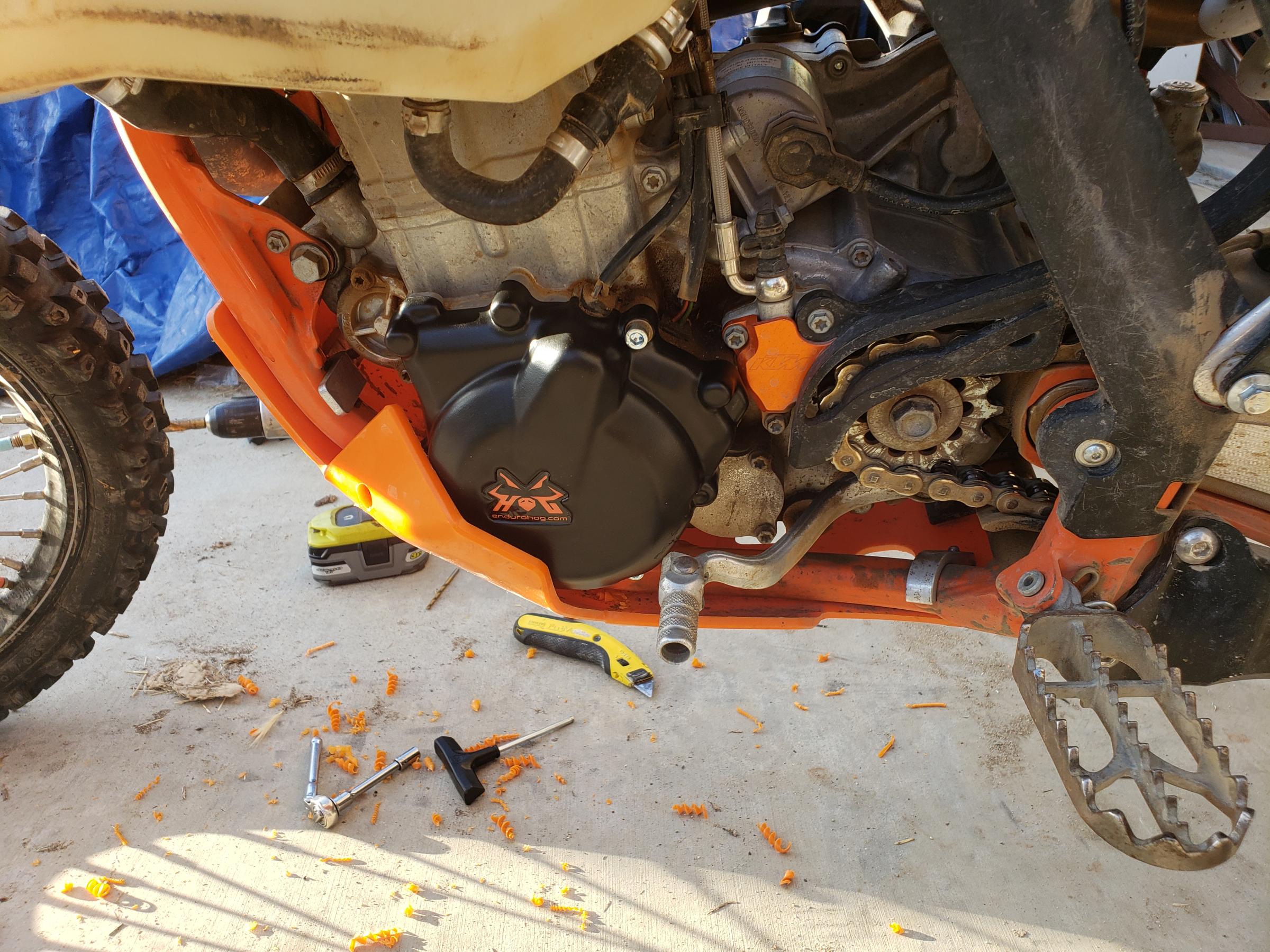

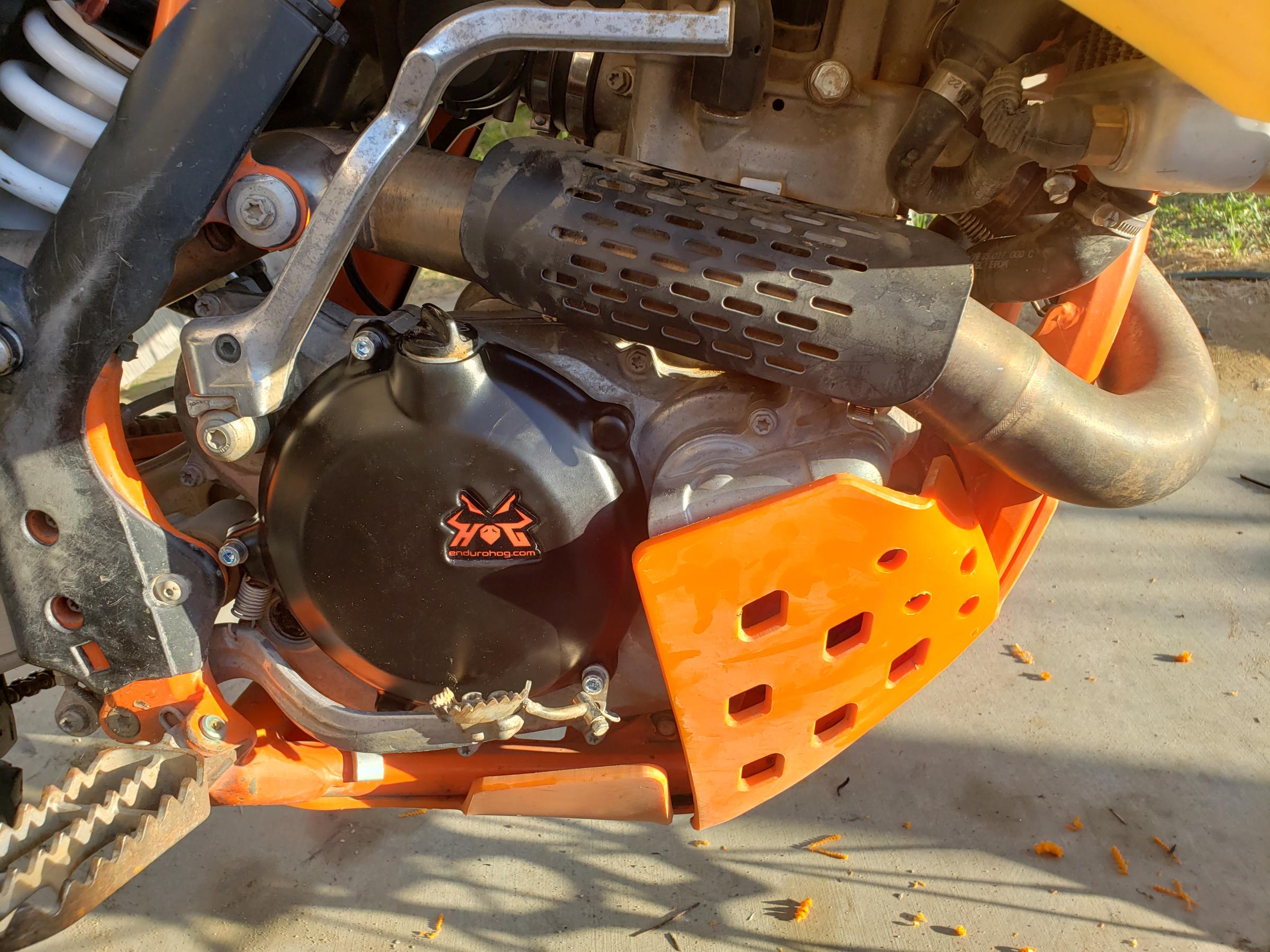

ADV Bum 205 Posted July 10, 2020 Thanks. I did purchase a set of Guards for the Clutch and Ignition covers. They are full plastic covers, not partial like most I had found. I was more worried about heat retention. If people will jb weld/ glue a aluminum full guard on, I cant see these retaining any more heat. I will modify and expose the cover bolts on the lower part of the guard and drill a few holes to let out water. I am also going to vent my skid plate to let more air flow get to the engine. Share this post Link to post Share on other sites
ADV Bum 205 Posted July 11, 2020 I did install the covers today. I made the modifications to the bottoms to let the moisture escape. They fit nice. I also vented my skid plate some more to help with air flow. 1 Share this post Link to post Share on other sites
amgems 79 Posted July 11, 2020 Seeing the pics reminded me of sumthin'. The cover pushes my boot out a bit more and it would slip off the stock brake pedal. Got an extended one and all is good. Share this post Link to post Share on other sites
