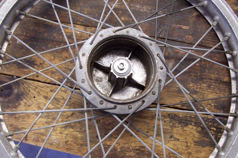

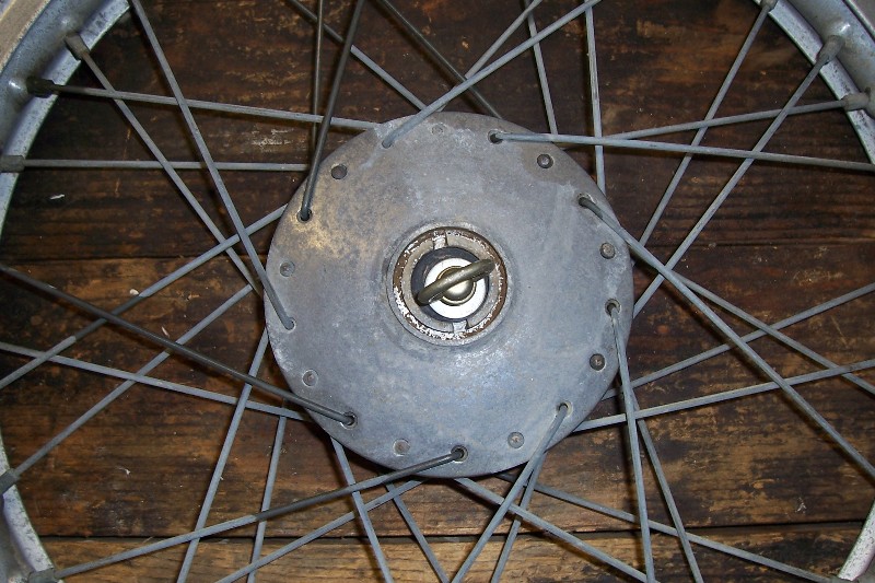

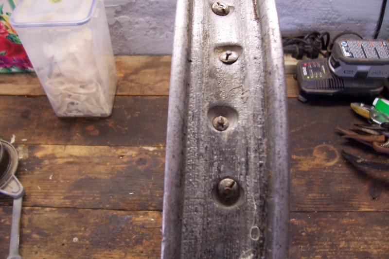

Greenhorn 13 Posted August 26, 2017 I have a little Hodaka that I'm going to work on bring back to life, It's a neat little bike, has lots of old school mods. Starting with the wheels. I'm looking for suggestion on bring back the finish to the wheel, spokes and hub as possible and how to address a few issues. Doesn't have to end up a perfect restoration, but I'm not in a big hurry and would like it nice when done. I would rate mechanical reliability over ascetics if I had to. I can put maybe $100 into each wheel. Starting with the front. Issues are there was duct tape inside as a tube protector and there is some sticky residual gunk. A few of the spoke are high out of the nipple, one or two look like incorrect nipples as they are small. And of course the finish is funky. The nut and bolt was to protect the seal and bearings while spraying it off. Appreciate any suggestions Front hub Small nipple and spokes extending High nipple and duct tape gunk Inside Hub Share this post Link to post Share on other sites
DSM8 427 Posted August 26, 2017 Depends do you want to restore in place or fully disssemble the wheel that makes a diff in what you can do wd40 will break down the adhesive without being too aggressive goo b gone works as well too Share this post Link to post Share on other sites

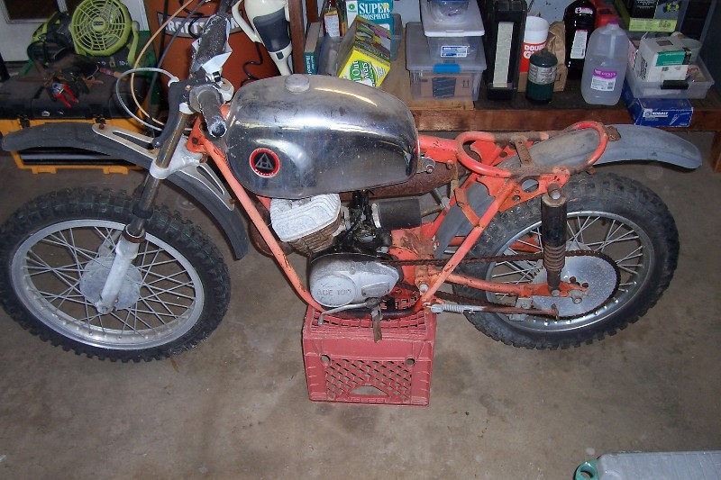

socalhodaka 115 Posted August 26, 2017 Thats a lipped style rim and the only model Hodaka that had them was a Combat Wombat. Is that what you have? If you need help with parts or anything with Hodaka let me know. Share this post Link to post Share on other sites

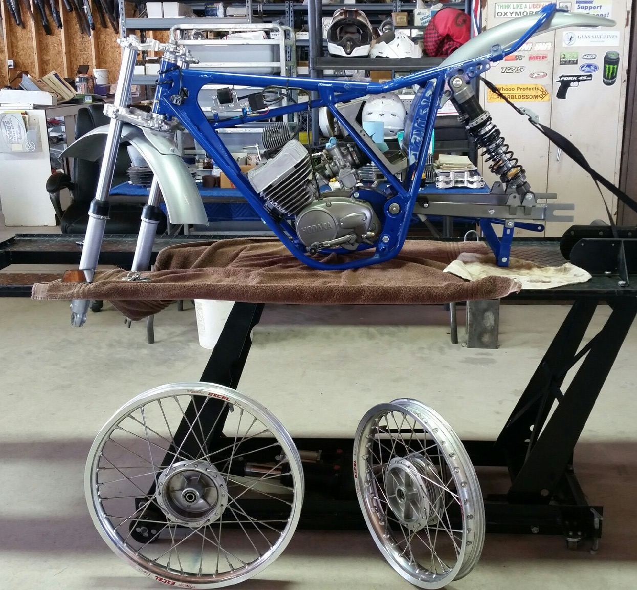

socalhodaka 115 Posted August 26, 2017 My newest project, 125 Super Combat. Share this post Link to post Share on other sites

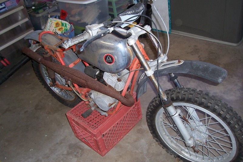

Greenhorn 13 Posted August 27, 2017 3 hours ago, DSM8 said: Depends do you want to restore in place or fully disassemble the wheel I'm fine with in place or disassemble, just don't want it to get to expensive. About $100 each and I can invest a little in tools. I have power washer, air compressor. It has have crossed my mine to get a media blaster (baking soda?) but have never done anything like that. In the big picture it might be useful for other things on the bike? In tried a little WD-40 and a stiff nylon brush, not so good, will get some goo be gone. I think it is an Ace 100, From what I understood the original owner, not who I got it from, did a lot to it back in the day. I got a box with a couple internal gears, workshop shop manual, a different air filter can. Not such a good thing I would think for originality but frame looks modified. Forks, shocks and pipe are all after market I think. Forks look like they are going to need major work or replacing, would prefer to keep some how. Seat cover not so good, seat pan is ok. Not %100 where the tank condition is besides rust. I'd like to need to try and keep the project to about $1000. SoCalHodaka - Your Super Combat looks fantastic. I might take you up on the offer for advise and parts info, looks like your an expert Here it is. Kind of rough, but I want to do right by it as possible. Not in a big hurry. Share this post Link to post Share on other sites
DSM8 427 Posted August 28, 2017 Soda will be the least abrasive of any media blasting material of course if you find a place local the does it would make sense to bring the wheels there and see how it looks post blast since it doesnt appear chrome is an issue you could then powder coat if you wanted afterwards Share this post Link to post Share on other sites
