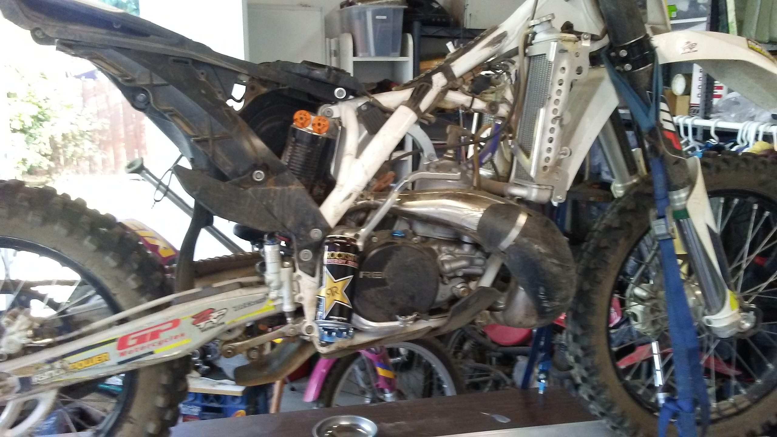

robertaccio 436 Posted June 22, 2017 lightening holes in my 2014 TE300 Enduro Engineering Radiator Guards....................lost about 3 oz.....up high Share this post Link to post Share on other sites
Bp619 114 Posted June 23, 2017 I like your rockstar sponsor plug jarvis Share this post Link to post Share on other sites
robertaccio 436 Posted June 23, 2017 I was tired that day and wanted some pep, I rarely if ever drink that stuff. It works but so does espresso!! And espresso seems more natural I was too lazy to brew some coffee. Share this post Link to post Share on other sites
