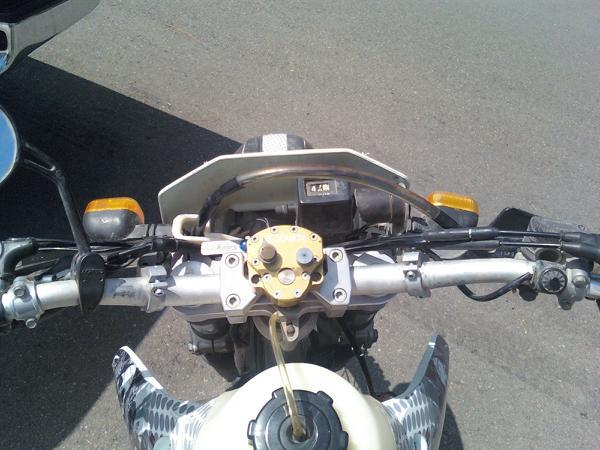

Goofy Footer 549 Posted September 24, 2011 So I went to West Marine and picked up the 76cx with hardwire kit. That will get installed today. Now... what Ram mount? I thought about the handlebar U bolt one, but I have fat bars. I thought about the handlebar clamp ball mount but I have the stabilizer in the way. Thoughts? Share this post Link to post Share on other sites
PbdBlue 46 Posted September 24, 2011 So I went to West Marine and picked up the 76cx with hardwire kit. That will get installed today. Now... what Ram mount? I thought about the handlebar U bolt one, but I have fat bars. I thought about the handlebar clamp ball mount but I have the stabilizer in the way. Thoughts? Ram makes a ubolt mount for fatbars http://www.gpscity.com/ram-mount-large-stainless-steel-rail-u-bolt-base-with-1-inch-ball.html Or my personal favorite http://www.gpscity.com/ram-mount-motorcycle-handlebar-clamp-ram-b-367u.html That one replaces one of the handlebar clamp bolts. Share this post Link to post Share on other sites
