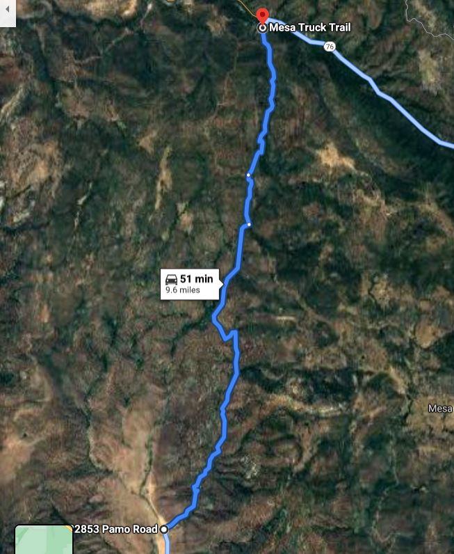

At the gate

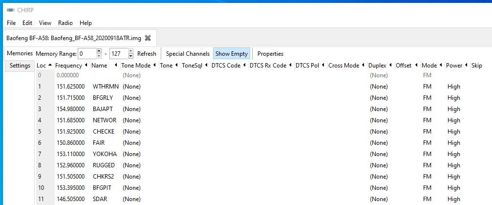

If you couldn't hear the other guys it could likely be the squelch settings. The squelch settings on the cheap China radios are not very "linear". They are kinda funky. Someone told me they are like a Suzuki RM400 - either ON or OFF. There is a way to tweak the squelch, and make it useable, but I have never tried it. I've just left it at factory settings and it works ok.
The other thing to look at is the antenna. Maybe try it with stock antenna and aftermarket and see if it works differently. There are some fake Nagoya antennas out there.
Here is a screen shot of how I programmed my radio to work with the commonly used Rugged programmed channels, and SDAR Freq.
This one is for the BF-A58 but should be the same for the UV-5R
Let me know how it goes.
