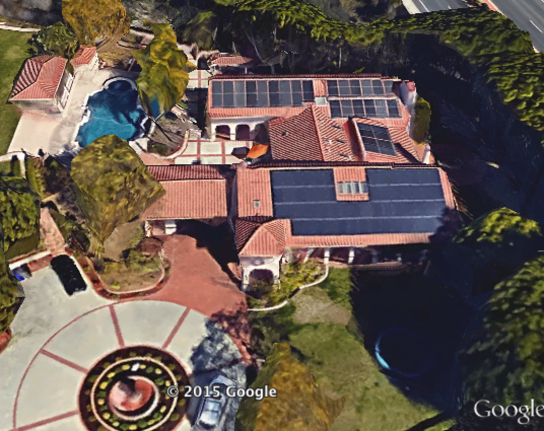

I had a 3.1 kW system purchased several years ago through the Solar Alliance. Haven't heard much from them lately and I think they may have merged with someone else. Did a great job and got me out of the tier 3 & 4 rates down to tier 1 most months and my bill was typically less than $35. I bought the system and my cost was $14,000 after the rebates
We moved a year ago to a new house and sold the old house. My realtor didn't understand the value of solar and wasn't doing much to try to get any extra out of the house for the inclusion of the solar system which was still pretty new. The new buyer didn't want to pay extra so I took the system with me.
The electrical bill at the new house was around $400 each month. The pool accounted for a significant portion of the monthly electric costs, so I swapped out the pool motor with a variable speed unit which helped.
I was going to do a self install of my old panels but some health problems kept me from being able to do anything physical for a while. When I checked with the various companies to do the installation for me, most wouldn't touch it because they were only interested in doing new installations of their own panels.
Finally I found Precision General Contracting who is doing solar these days. They in turn sub contracted the work to Sun Fusion Solar. In addition to having my old system (14 panels) installed I also added 8 more panels, which was the amount we figured was needed given my bill. Cost after rebates was about $10,000.
I should add that the Sun Fusion guys did a really great job. Very clean work site and crew was respectful and knowledgeable about each aspect of the job.
The old panels were Canadian Solar 315 W units connected to a Sunny Boy inverter. I don't remember the brand of the new panels but they use one micro-inverter per two panels and have improved output over my old panels.
The orientation of my house is such that I don't have a due south facing roof, so we went with a south west roof facet. Still, my old 14 panel system now generates about 17.5 kWh on a good clear day and the new system generates 15.5 kWh for a total of 33 kWh. That's just a bit over my typical daily use of around 30 kWh.
I'm in unincorporated San Diego county on the San Marcos side of the border with La Costa. Still coastal enough to be affected by the marine layer sometimes, but not as bad as my old house in La Costa. Still, there were a surprising number of crummy days last month and the most recent three days haven't been great for solar either. Still last month's bill was $22 and this month is looking to be in the same ball park if the June gloom doesn't go away. I'm definitely generating more than I use on clear days, so come July hopefully I'll be due for some credit.
If you or someone you know can do the roof work of installing the mounting points for the rails and any necessary conduit to the electrical panel and you know a decent electrical contractor, you could save a lot on a DIY system. About half the cost of my first system was equipment and the rest was labor/profit. The new system was more skewed toward labor/profit because of the reinstall of my old panels.
If not going the DIY route, for new installs there is a fair bit of competition in the market so I would get a couple bids to weed out anyone who's price gouging. A number of sellers are also touting the lease option which I haven't taken the time to understand and compare with outright purchase.
