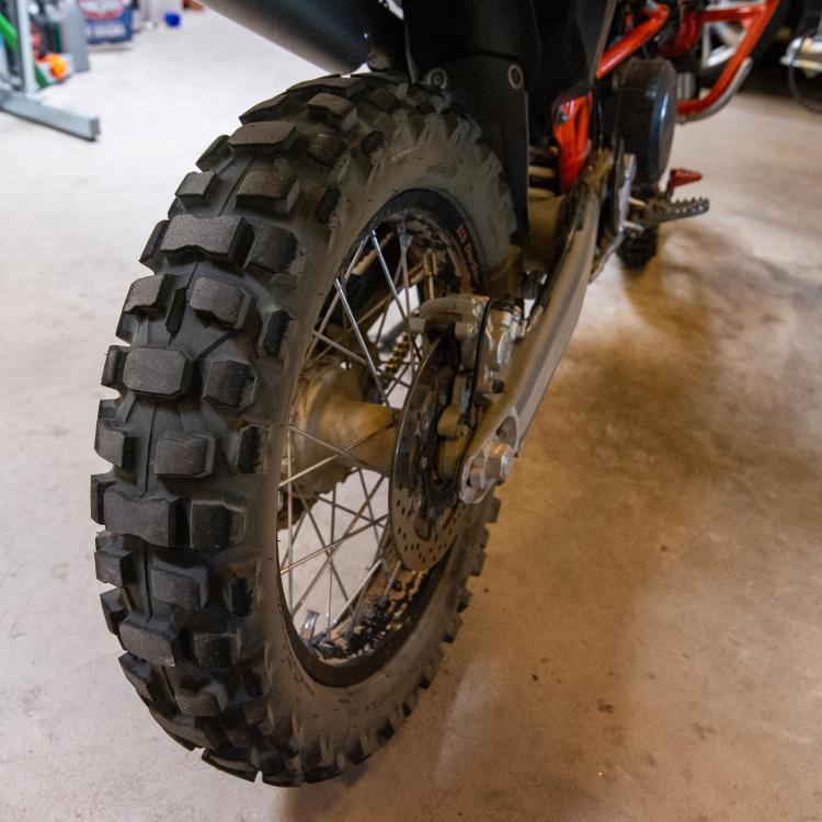

shutterrev 367 Posted August 21, 2022 (edited) So way back in May of this year I mentioned I put on the Tusk DSport Adventure Tire, and that it was $69 shipped, and harder than a two dollar steak. All of those things are true, but I just wanted to pop in for a ~550 mile report... ~550 Mile tire thoughts: The tire performs well in all our desert terrains, it hasn't been a huge departure, if any at all, from the more expensive (but great) MotoZ Desert HT I had on before. it has been hooking up everywhere I need it to, doesn't seem to be wearing awfully quick, and the price is something to write home about. I like to stretch the LC4's legs on-road, no traction control, and no ABS in the rear of the bike makes a pretty good rear tire test. The tire has plenty of grip on road and if it breaks loose it isn't snatchy. It's cheap, it performs well, just budget a little more effort and time for a trail side tube repair due to stiffness. For my front tire I am really satisfied with the MotoZ Desert HT, which I run in the 90/100 21" size, I won't be running the Tusk front as I have another HT waiting, but I bet that is descent too. Edited August 22, 2022 by shutterrev 2 Share this post Link to post Share on other sites
moto_rph 161 Posted August 22, 2022 It must be hard....looks like you've just managed to get the nubs worn off in 800 miles 1 Share this post Link to post Share on other sites
shutterrev 367 Posted August 22, 2022 6 minutes ago, moto_rph said: It must be hard....looks like you've just managed to get the nubs worn off in 800 miles It’s about one or two shades softer than zip tie nylon lol. 1 Share this post Link to post Share on other sites
shutterrev 367 Posted August 22, 2022 (edited) Looked at whiteboard this morning and read wrong mileage, corrected, a little over 550 on this rear tusk tire, comments above still ring true. This was the tire new when I was mounting it, so in 550 miles or so you can compare the block height Below, with the picture in main post above: Edited August 22, 2022 by shutterrev Share this post Link to post Share on other sites

shutterrev 367 Posted August 22, 2022 @crfxer yeah it’s looking based on the tread depth at mounting and ~550 miles now, that your estimate will be pretty close on mileage. At $69 shipped if it doesn’t break 2k with usable tread I’ll go back to the HT, just because I get double the mileage for double the price less fussing with tires I guess. Share this post Link to post Share on other sites
